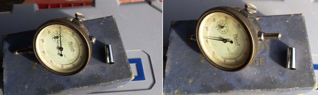

      Hi, i recently picked up this Mercer dial indicator and was wondering if anyone has seen one like it or how to mount it as any clamping force on the stem housing locks it solid .

        Anyone seen this model before and how do i mount it ?

          Sorry, Ian … I don't think I have ever seen that style of back before.
          Unless the indicator is a 'vintage' Made in England job … are you aware that all the better Mercer DTIs were badge-engineered Compac ones ?
          It may be worth browsing the Long Island Indicator site for information.
          http://www.longislandindicator.com/p41.html

              I have an identical indicator (apart from the resolution) and have no problems when clamping on the plunger outer sleeve.
              The fit of the plunger in its bore has virtually no clearance so any appreciable force may distort it enough to jam the plunger. If your clamp has reamed close fitting bore then very little pressure is needed to hold the indicator.
              Out of interest what is the resolution of the one in your picture? (the decimal point is hidden by the pointer.

                I've seen them before. They are nice to use on things like a lathe rather than a finger type.
                I think you will find that what looks to be a square bar is an add on from how they usually are and that is where it would normally be clamped. Looks like it's intended to be held by the square bar. Maybe it has a slight dovetail ?

                  I.M. OUTAHERE
                    @i-m-outahere
                    Hi,
                    Thanks for all the replies .
                    Michael, the long island site was my first port of call unfortunately no luck there only the info about compac making them . Thanks for placing a link up there as some one may ead this in the futue and it will lead them to the best place to find anything out about measuring equipment .
                    Ian , i only tried it in my cheap indicator stand which probably had the mounting hole produced in a punching machine , the clamp is not vey wide so i will make a custom unit and see if it helps .
                    Pretty sure .002 mm but will check when i get home .
                    John , the back plate is one piece the rectangular lug houses a lever arm that transfers the movement from the stem to the rack .

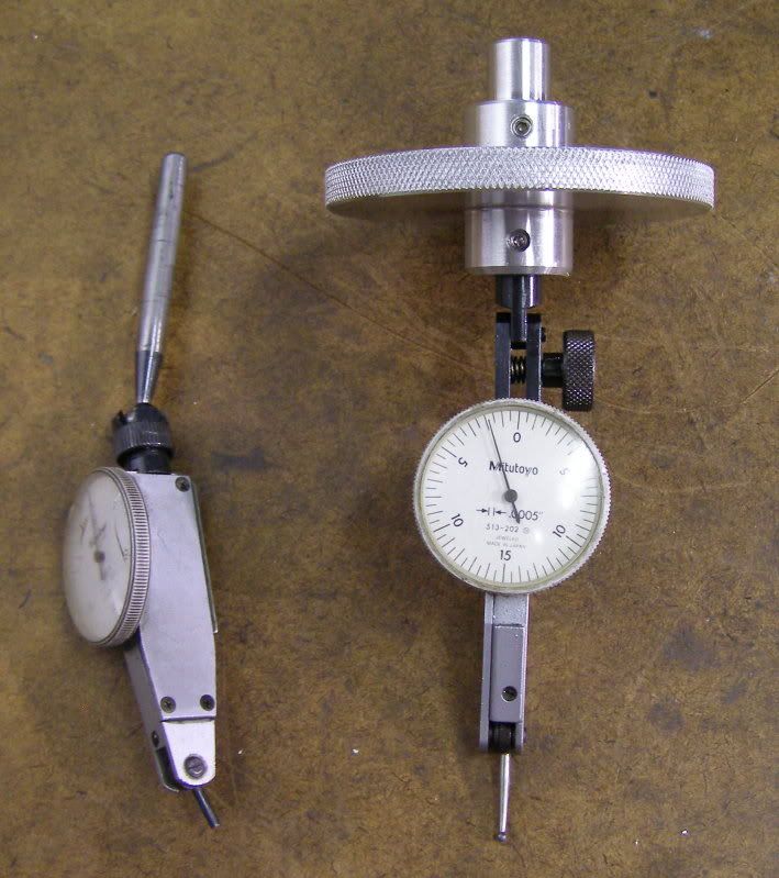

                        The ones I have seen have been like this Ian. Including a longer larger diameter for mounting them. You may find yours has a hole for something like Mit's holding bare?
                        I've looked around for a small one of these with 0.0005" or better graduations several times.

                          The chrome plated cylinder at the top is only a push-on cover over the shaft and is not suitable for mounting. This one has a standard mounting lug at the back with a hole for bolting to a stand. Clamping to the guide at the top is probably restricting the movement of the plunger.

                            Having just looked at mine again I am sure the resolution of yours is 0.002mm/div (mine is 0.0001"/div).
                            I thought the marking on the dial in your picture might be 0.02mm
                            Mounting the DTI by gripping the stem seems to be the only method for this indicator so its not very versatile.

                                Clamping by the stem is common enough practice but as suggested above the clamp needs to be something like a square bar with a reamed hole in it that the stem just slides into, A slot and a pinch screw will provide the light clamping pressure you need. I think the cheap magnetic stand types made from two pieces with holes through them will put a bending force on the stem rather than an all round squeeze and this is probably what is binding up your plunger.
                                If it is sticky from sitting around, don't succumb to the temptation to oil it or clean it with solvents inside etc. Mitutoyo service sheet recommends only to lubricate the plunger where it sticks out of the stem, using a couple drops of petrol. I have found this to be good advice a number of times on old gauges I have scrounged up.

                                        I generally use this
                                        It's fine on a Boxford as plenty of cross slide. It was a joke on a Peatol and too much on a Hobbtmat really as well. It would probably be awkward on a mini lathe.
                                        It has 1/2" travel which I find is plenty. Not sure about the finger type but think it's under 1mm with the standard finger on it and maybe a bit over with the longer one.
