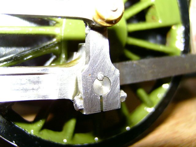

                        John Baguley
                          @johnbaguley78655
                          I think this is what Mick means:
                          This is a bit bgger though. The crankpin is 0.1875" diameter and the return crank is 0.125" thick. The crank is pinned with a 0.0625" dia. silver steel pin put in after the crank was set.
                          #142549
                          michael howarth 1
                            @michaelhowarth1
                            Thanks John,that is exactly the sort of joint…, and a very neat job too. What is the size of the clamping screw that you have used? Did you drill for clearance all the way through the return crank or did you tap the crank and nut it as well? How on earth do you drill for the silver steel pin without breaking through into the coupling rod? Or do you only drill part way through the return crank?

                              #142566
                              John Baguley
                                @johnbaguley78655
                                Hi Mick,
                                I think it's 10BA (the loco's tucked away in her box). One side of the slot is clearance and the other side tapped and the nut is just a lock nut. The bolt is just an ordinary steel one so you can't tighten it too much without shearing it. One made from a stronger material would be better. The return crank is a tight fit on the end of the crankpin to begin with.
                                The pin goes half in the crank and half in the crankpin and is 0.125" long (the thickness of the return crank. Actually, the end of the crankpin is reduced from 0.25" dia. to 0.1875" to take the return crank so there is no danger of drilling into the connecting rod if you are careful. The crank is made from gauge plate (I use gaugeplate for all valve gear parts as it's hard wearing) and is a similar hardness to the silver steel crankpin so the drill doesn't wander when you drill for the locking pin. The drill can wander if one material is softer than the other.
                                One of the cranks did come loose last year and the pin fell out when I was pulling myself and another person but it had run for 5 years with no problems until then.
                                The loco is a 2½" gauge Helen Long by the way.
                                #142573
                                  Mick,
                                  I think I can explain how the type of clamped joint illustrated by John might fail to live up to expectations:
                                  For the moment, ignore the little dowel-pin and consider just the clamping action.
                                  Assume that:
                                  • The crankpin is perfectly smooth, straight, and cylindrical.
                                  • The hole in the con-rod has been bored to a close sliding fit on the pin.
                                  You then tighten the cross-bolt, to apply clamping force; and it immediately goes very slightly oval … with the result that there is [at the microscopic level] only two-line contact.
                                  Solution: Relieve those two areas of the bore very slightly [just a few thou'], and the contact lines will be redistributed. If you happen to get it right [which involves more luck than judgement, I fear] then you should get lines of contact at about 12, 4 and 8 o'clock, with the slot at 6. This is a much more secure and stable arrangement.
                                  Note: In addition to it's obvious function; that little dowel-pin that John shows may well serve to "force" a contact line at 12 o'clock.
                                  … I hope that all makes sense.
                                  If it's any consolation; the problem described is, I believe, a fundamental failing of this design of clamp.

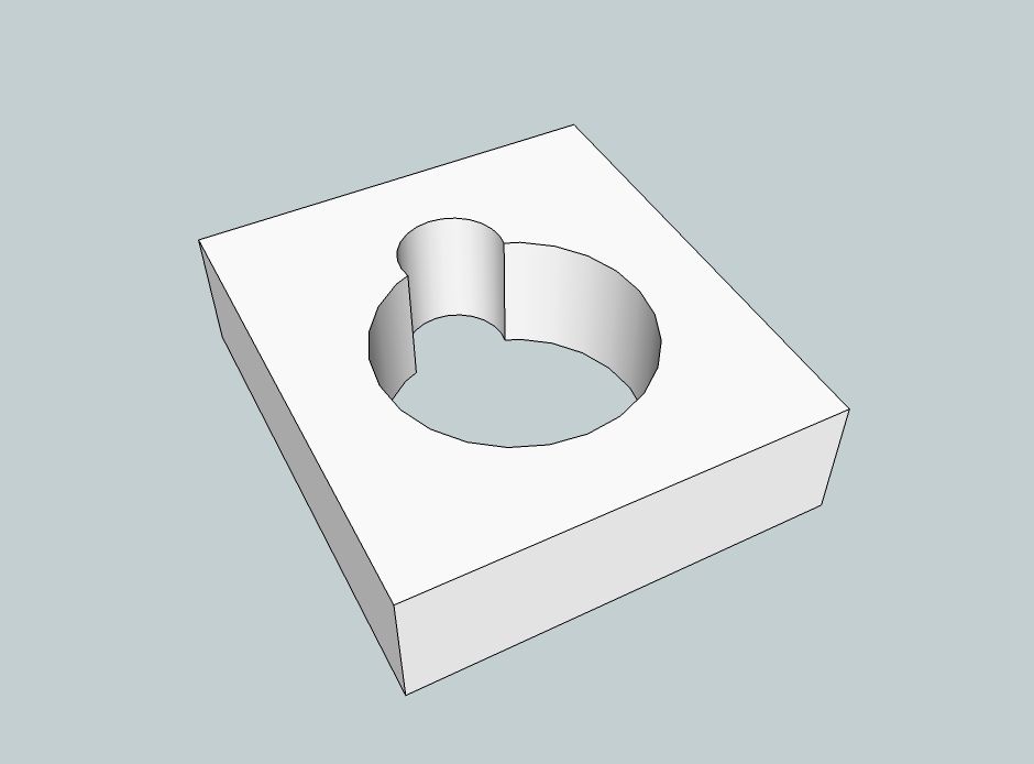

                                      With reference to line contacts and possible distortion pin in bore mounts used in optical labs have so called double bores with a second, small, bore opposite the locking screw. Typically the small bore is around 1/4 the diameter of the main bore. For the common 1/2 inch (ish) pins the second bore is drilled and centred on the main bore circumferance but the larger sizes eg 1" and 2" (ish) are bored to put the outside around 40 to 60 thou beyond the main bore. The pins are an easy sliding fit but even with only a simple nylon tipped knurled head locking screw they are held firmly in place with only finger tightening. The two line contacts opposit the screw ensure that the pin is vertical with no rock.
                                      Some brands of larger mount use a pair of floating collets inside a transverse bore rather than a split clamp or radial screw. One collet is threaded, the other plain with the ends suitably tapered so that when the screw is tightened up the taped bear against the pin and force the collets out against the inside of the transverse bore. If anything other than modest torque is applied to the clamp screw these things can jam up so tight as to be almost impossible to remove. Not enough room for the OP to use this idea but worth remembering for a suitable occasion.
                                      The simple bolt and split clamp system inherently puts bending stress on the bolt which tends to reduce the security, especially with slender fixings. If you consider the forces involved when the clamp tries to slip its fairly clear that there is an opportunity for the bolt to "run away from the load" by bending slightly. I've disassembled a fair few larger, slackly toleranced, set-ups of this style where the pinch bolt has bent by overtightening in an attempt to get things to hold.

                                      #142602
                                        Clive,
                                        That's an excellent description of the "double bore" and I agree completely regarding its merits. The saddles on my ancient optical bench have exactly that arrangement, and it works beautifully.
                                        For Mick's application, it would be neater to just broach-out a shallow recess; but the geometric principle would be the same. … Much more satisfactory than the clamp.
                                        #142604
                                        michael howarth 1
                                          @michaelhowarth1
                                          Any chance of a quick sketch of the double bore, gents? I am sure others would be interested as well.
                                          Mick
                                          #142626
                                            Mick,
                                            Here is a quick sketch to show the general concept
                                            The key to making this work, is that the two holes are exactly parallel; so the edges act rather like a Vee block.
