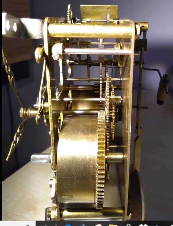

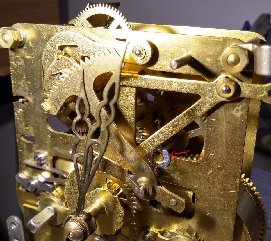

                I came up with an alternative solution. I glued a small washer to cover the end of the pivot hole, to stop the gear from moving too far forward and clashing with the large drive spring gear. See picture 1. This solved the problem of the gears clashing.
                But then I discovered the reason for the gears clashing – oddly, I had not noticed this before. See picture 2. The drive spring casing, and the gear behind it, is tilted backwards. The top of the large gear is nearer the back of the clock than the bottom of the gear. You can see how little clearance there is between the two gears, even with the small gear pushed back by the glued washer.
                Should I be worried about this?

                  Posted by Chris Barrett 1 on 03/10/2018 16:02:04:
                  Assuming that the clock was not built wrong … It looks like it has had a long, hard, life !
                  It may limp on for another decade or so, but it's certainly not right.
                  You will probably find that the barrel arbor pivot, and/or its hole are badly worn:
                  … This is a very good time and place to learn how to re-bush holes.
                  #374413
                  Bazyle
                    @bazyle
                    This movement is a very common design with a moving barrel so the main winding arbor turns as you wind it so you can see if there is any wear at the rear which is where the force of the interaction of the wheel and pinion acts more than the front. It is probably fine. Then you can try moving the barrel relative to the arbor to see if the wear is at the centre of the main wheel (most likely as it rather inaccessible for oiling, though it is doubtful the clock has ever been oiled.
                    Most likely it has come to light because the frame has been distorted slightly during the recent manhandling. You should be able to work out which way to thump it to free it up a bit.
