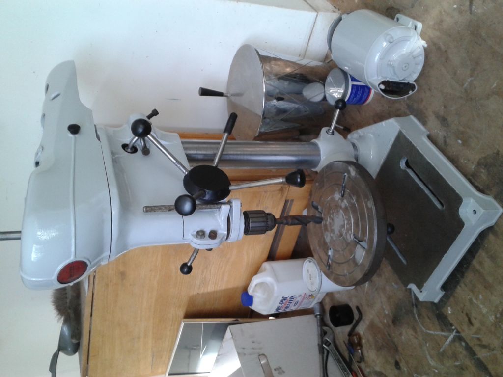

                              #181160
                              Graeme Whitfield
                                @graemewhitfield34761
                                My drill, was in a right state when i got it. i wasnt too fussed about the finish on this one, and yo cant see the gears anyway.20141012_122136.jpg
                                #181162
                                Hans
                                  @hans86050
                                  Graeme,
                                  That is a beautiful vintage bench drill. Love the cast spindle cover. Living in the Colonies, I am not familiar with that manufacturer.
                                  Hans
                                  #181164
                                  Graeme Whitfield
                                    Its a Kerry. Backgeared, rotating and tilting table means you can get any part of the table surface under the drill.
