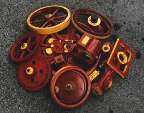

                One of my models required a lot of castings so I made my own patterns, mostly out of plywood with fillets from car body paste.
                A commercial foundry (Canlin Castings) near to me suggested the use of Meehanite as they were always using it and it made a superior job. Some of the castings, such as the foundation ring and firehole ring were cast in gunmetal. Very satisfying (when it works).
