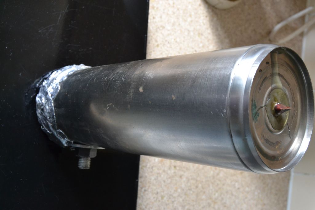

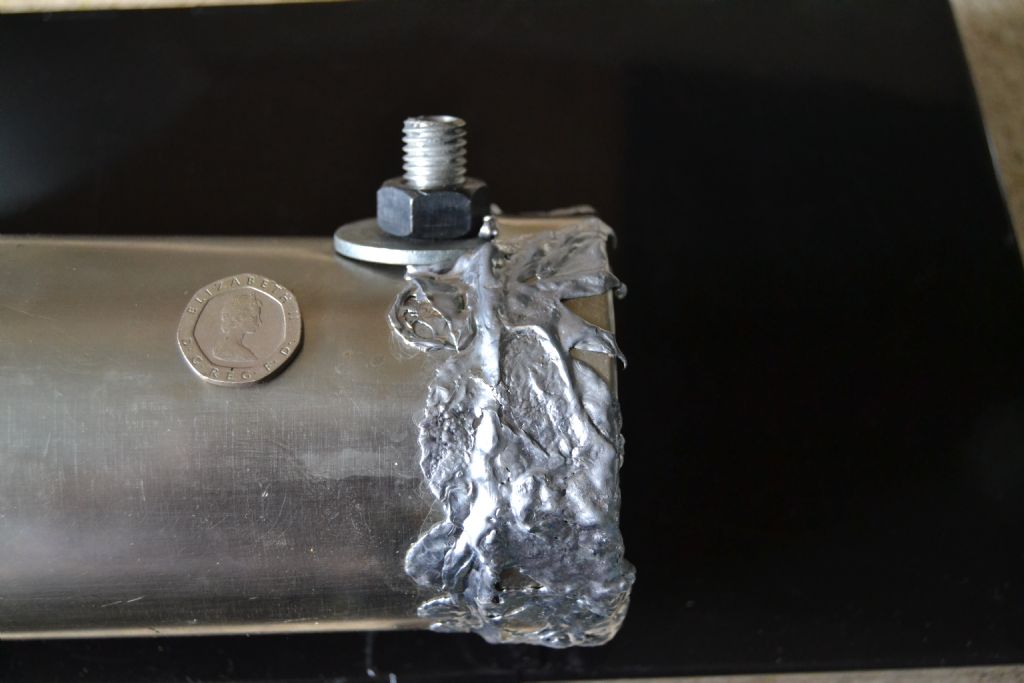

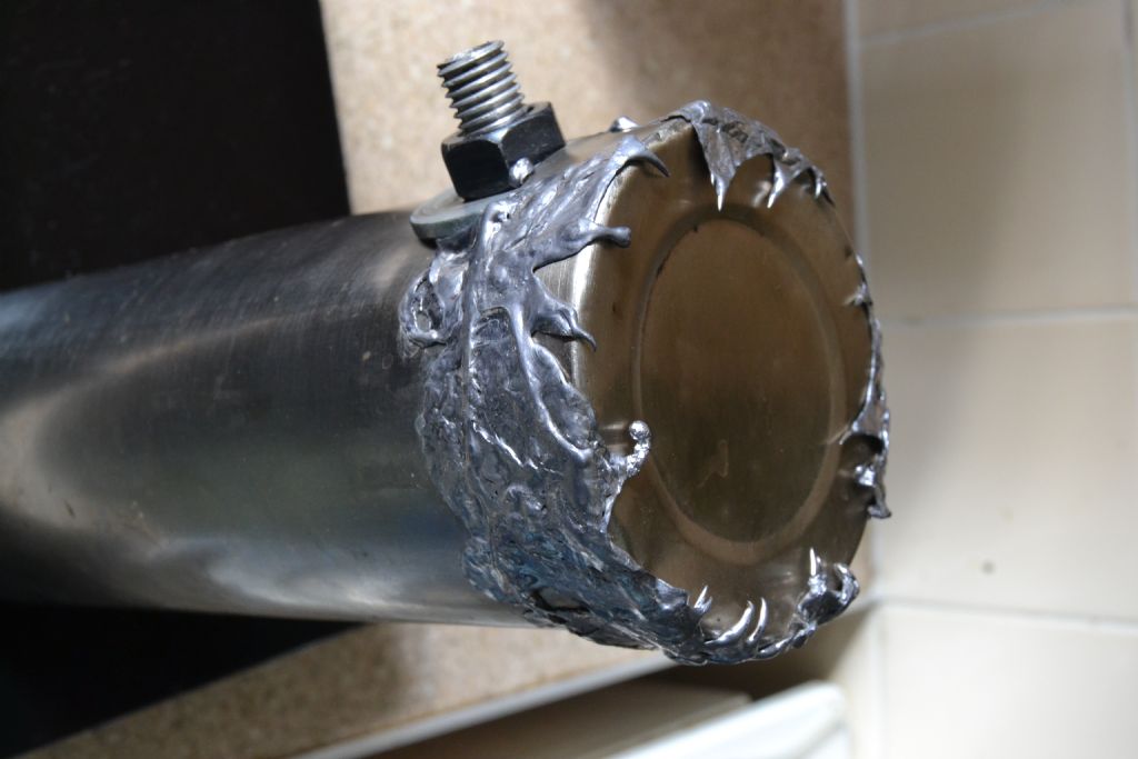

                I mentioned earlier I tried making a boiler out of an old thermos flask just as a quick experiment to see if I could improve on the Kelly kettle.
                Here are a few photos, I'd be lying if I said it doesn't leak a bit but nothing like as much as you'd expect.
                All that is holding the end cap on is molten lead poured in, I drilled a few holes in the flask wall so the lead flows through them an gives a better seal but there are no bolts other than the hollow steam outlet bolt you can see.
                Even the steam outlet has no sealant other than a piece of rubber on the inside trapped behind a nut and a washer and it doesn't leak at all.

                If something as crazy as that works surely 4" dia tube with 10mm thick walls holding 10mm thick plate held by at least 12 bolts and a sealant / gasket is going to work.
