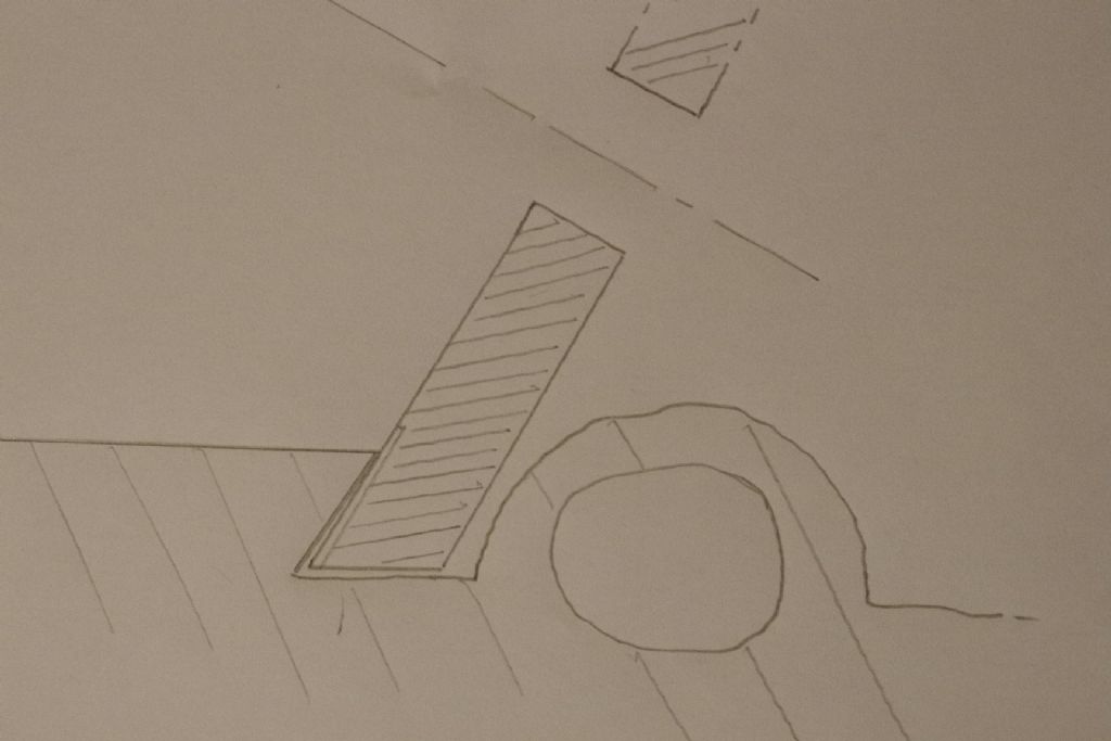

      The X axis of the Tom Senior light vertical at the museum has a bit of play. It has 18 5/8" travel and if the bed is pulled forward or pushed back, it can move up to 0.004", especially if it is to one extreme or the other. I have checked the knee and cross slide Y axis and when they are locked and they do not move, so the X is the culprit. The Ways on the cross slide are about 14" long, so I assume that the bed is pivoting very slightly as the ends are more worn than the middle. Now I have had a look at the design of the cross slide, it cannot have a 55 degree dovetail cutter run along it to true it up as there is nowhere enough room to get one in. A 20mm diameter one would just fit, but the length of the cutting edge would only reach half of the dovetail surface. The picture shows how close to the dovetail, the cast in bosses for the X axis leadscrew nuts come (top side)._igp2375.jpg

              Its the narrower gap that would need machining, the other one incorporates a tapered jib. The minimum diameter of cutter which would cut the entire dovetail is 35mm, and that size would cut about 2/3 of the wall thickness of the bosses off. Yesterday, we removed the cross slide and I relieved the centre portion of the dovetail with a file. The area which was filed allowed for a minimum of 1 1/2" bearing surface remaining at each end at maximum travel of the X axis. The travel is asymmetric, being slightly further to the right than to the left, actually leaving about 4 1/2" at the left end, and 3 1/2" at the right, so something like 6" was relieved.

                  I would guess that Senior used something like this, if they used a mill:_igp2482.jpg

                    It was probably originally planed and then ground or scraped.
                    The wear is quite apparent on the face in view which is concentrated around the ends as you would expect. This will have the effect of 'loosening' the table at the travel extents in the way you describe and coupled to the inevitable wear on the angled vee ways will make the table rock the way it is.
                    The thing is you cannot fix that by just machining the one vee. You need to machine/grind and/or scrape the top flat AND parallel with the y-axis flat way first and then map the wear in the front and rear vee then figure out where it needs machining/scraping. If you just go at it you'll have no idea if the x travel is going to be perfectly perpendicular to the Y travel both horizontally and vertically.

                        What you have, is normal wear.
                        The saddle dovetails wear wider at the ends and the table dovetails wear so they're narrower in the middle.
                        The top surface of the saddle will also have worn to be convex upwards
                        And that will be matched by the underside of the table wearing more in its middle.
                        You will also have some degree of bending of the table, as a result of the peening it has received from repeated clamping of work and fixtures.
                        _______________________________________
                        please don't rush in to "machine" metal away. You may well create more geometric problems than you cure, and you will create surfaces which will wear into inaccuracy, far faster, and travel less smoothly than a correctly scraped surface.
                        The two references for understanding what is going on and how to return the machine to schlesinger limits, are; Connelly, machine tool reconditioning
