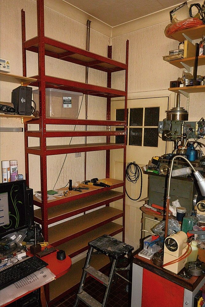

                        I need a mk2 small bench for my "new" workshop. There isn't room for the one I posted as it's 44" long. I've part taken up the space for something bigger with more racking. The 300mm deep racking is very useful in a workshop. The deeper stuff tends to hide things at the back as it gets loaded up with more bits and pieces. It's best to buy an extra rack unit to gain shelves. I have high ceilings and have used part of the spare rack to extend the height.
                        I have plenty of very heavy stuff low down but the sections can be clipped to the wall. I currently have a mini lathe in the wide gap. It's on a steel tray. With some thought It would be equally possible to add a deep bench to one of the shelves to carry a lathe if needed.
                        The only problem with these racks is the height taken up by the shelf supports. Some are thinner and the chip board shelves are inset rather than just sitting on top. The supports are also thinner. They do cost significantly more than the type shown though, This is an example. Other heights are available but 2.4m is just about right for me.

                                                    The Bigdug low units do use the same shelves and shelf mountings as the taller ones. They loose 30mm height per shelf rather than 55 on other types.
                                                    It might be possible to make a push around lathe bench with one of these or the slightly stronger ones by sheeting up the sides. Plenty of holes for fixings.
                                                    **LINK**
                                                    Or even shelves for Michael W if they are deep enough and not too high.
