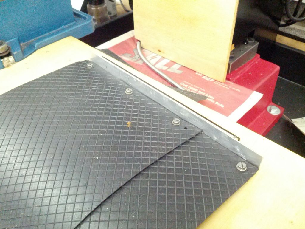

                    Nigel Graham 2
                      @nigelgraham2
                      Whatever slide-way screen my Myford VMC mill had originally, was missing when I bought the machine second-hand. I made a basic knee and vertical slide protector using left-over butyl garden-pond liner, held by the existing strip on the cross-slide, and a length of thin aluminium-angle screwed to the existing holes in the column.
                      The sheet also protects the elaborate metalwork I had to build to hold the cross-travel DRO strip.
                      The angle forms a little shelf, so I drilled a few holes in it to store things like the drill-chuck key and edge 'wiggler'.
                      I may see what ArcEuro can offer in that size though, ready for when the pond-liner eventually expires, though it seems to be holding up well.

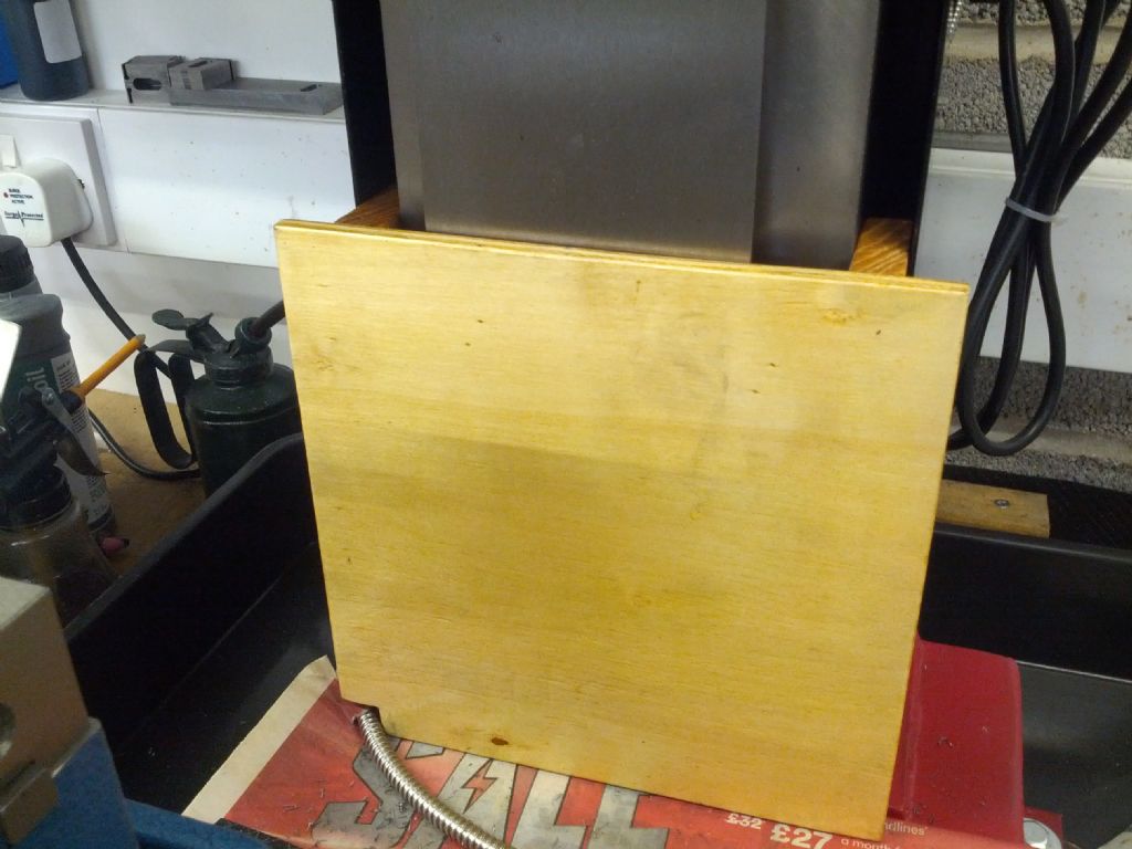

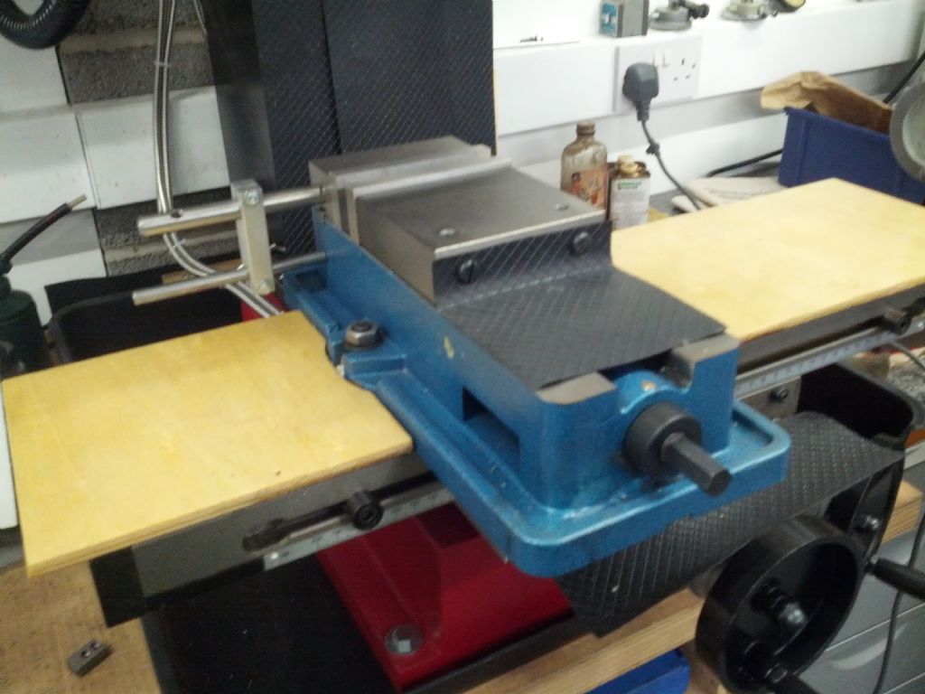

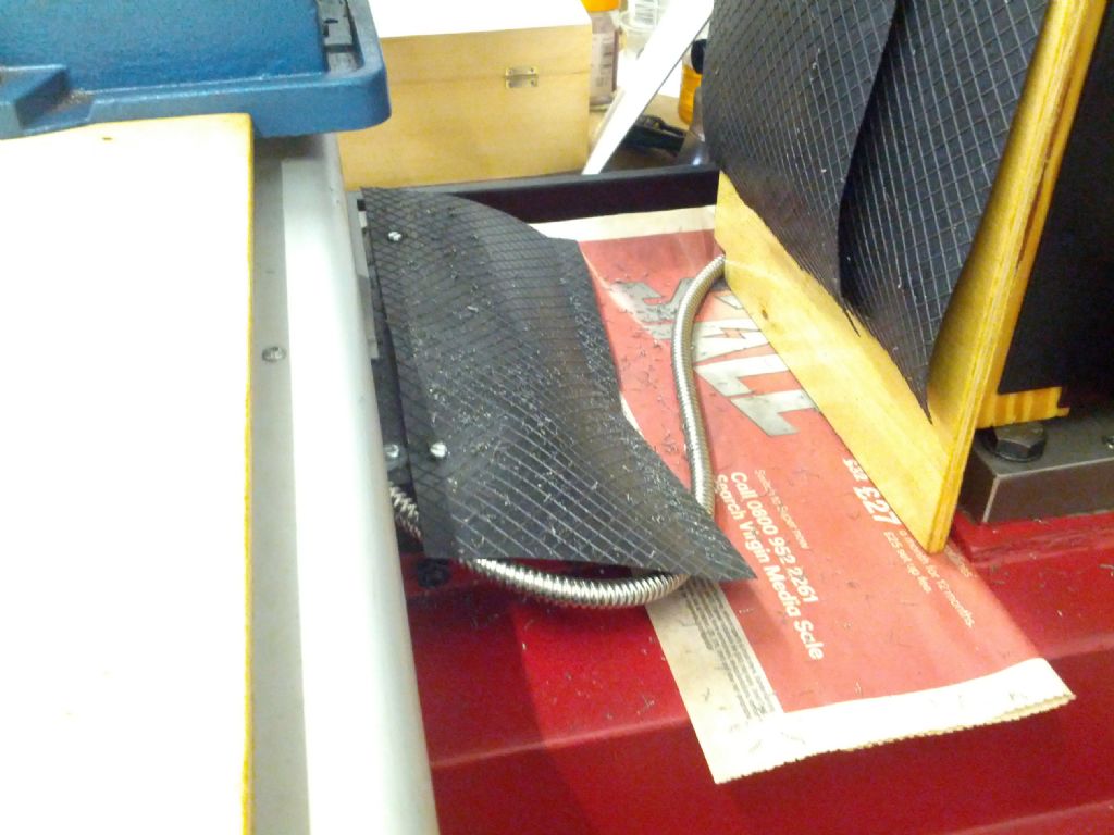

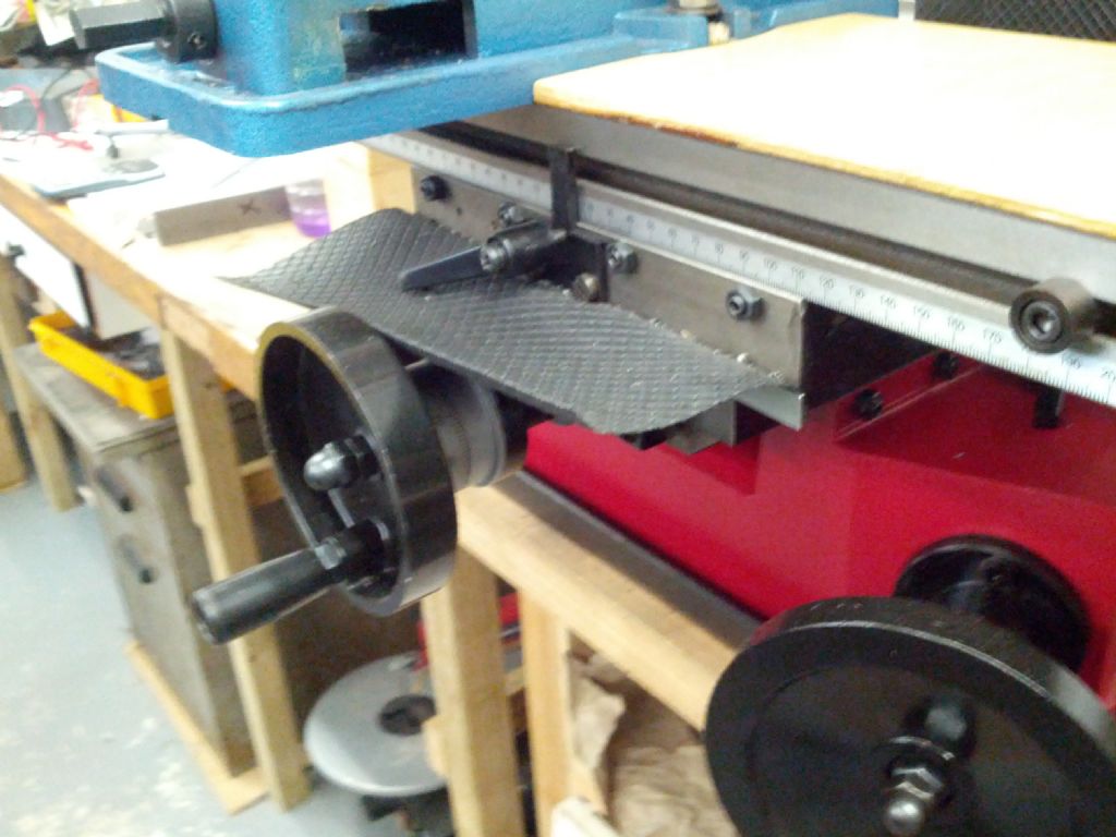

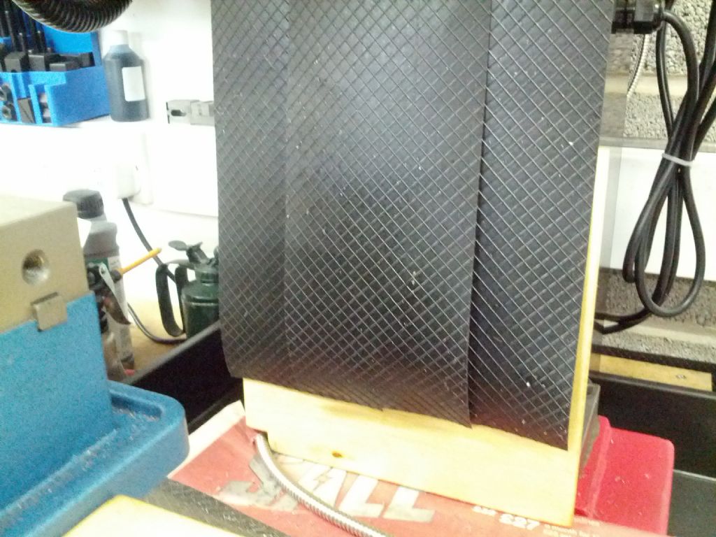

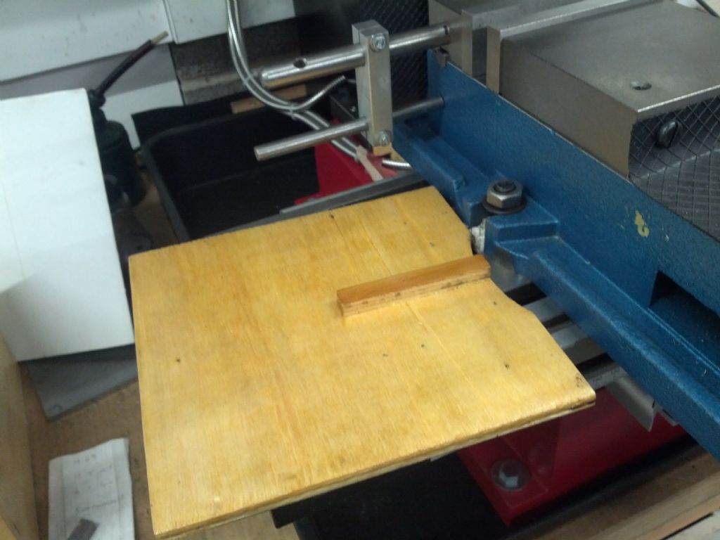

                        AdrianR
                          @adrianr18614
                          I have the SX3 and could not justify spending even more on the bellows. I have a roll of 100mm DPC leftover from building the workshop and I have made similar covers for my lathe.
                          They do not help with the floor but does keep it out of all the working parts of the mill. The ply is from the packing crate. For the floor I made a duck board so at least I am not standing in swarf.
                          The Z-Axis is held on with self-adhesive magnetic tape.
                          The table front and rear covers are screwed on.
                          Note: I also made stops for the Y axis which were sadly missing from the original spec.
                          To keep the adjacent benches clean I am planning on buying the clear plastic strips used for freezer curtains and making a semicircular curtain attached to the bottom of the head.
                          img_20210310_085140.jpgimg_20210310_085132.jpgimg_20210310_085105.jpgimg_20210310_085058.jpgimg_20210310_085041.jpg
                          Edited By AdrianR on 10/03/2021 09:55:29
