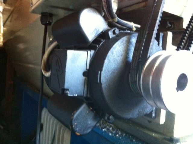

      Today my 6" Chinese lathe started making a sharp clicking noise, or perhaps more like a hand slap, when the motor ran down to a stop. It is an induction 2 hp motor. I couldn't use the Hercus, as I have the cross slide off to measure and compare with one I am milling from a casting. I wanted to turn a bit of 11/16 bar as a test piece for this, so I used lathe #3, the ML7. Having three is more circumstance than plan, but it worked out well today. Any thoughts on the motor? I know nothing about electrics but have heard of a centrifugal clutch on the start winding and that was my first thought. The motor is mounted behind the lathe, right out of the way of swarf or oil. In 10 years I have replaced the capacitor once. I don't want to use it until I know what is going on.

                        Simon Collier
                          @simoncollier74340
                          I just checked and there is a spark making the noise! The spark is under the cover of the bottom capacitor. Just replace it?photo 1.jpg
                          #251231
                          Simon Collier
                            @simoncollier74340
                            The capacitor housing was full of oil! So were the spade connectors. I can see oil leaking out of the lathes’ head/gearbox, some of which is dripping on to the top of the motor. I don’t know how it is getting from there to the cap, unless it is going inside the motor housing at the top, and running from there down inside the motor to the lead exit, tracking along the lead onto the spade connectors and beyond. The part of the motor around the exit point of the leads is not oily, that is why I think it might be coming from inside. I have a new cap in stock so I’ll fit that. The old one also has some sort of deposit, like a leaky battery, around the front seam.

                            john fletcher 1
                              @johnfletcher1
                              I think the "oil" is in coming form the run capacitor, it's can is leaking. Maybe its time to replace both capacitors, especially if they are awkward to get at. I think the leaky one will be the run one which is in use all the time the motor is running. The other is only in use as the motor accelerates away, it will be high value special AC electrolytic type. The capacitance value will be on the can/container, both are available from RS or Farnell and RS and I'm told RS don't charge for postage, but do check.John
                              it
                              #251297
                              Simon Collier
                                @simoncollier74340
                                I wondered if the stuff (what is it?) might be coming from the capacitor. I replaced the bottom one and no more sparks, but there is a delay in the motor starting up. I'll replace the top one too.
