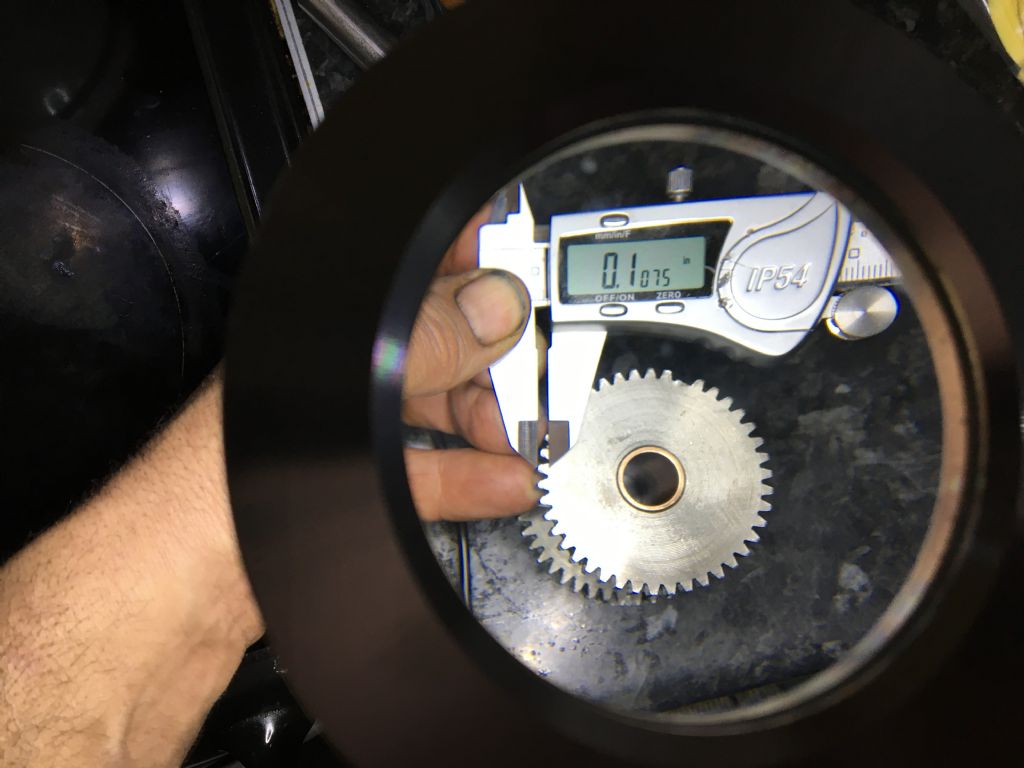

                        #514638
                        Pete Rimmer
                          @peterimmer30576
                          Maing a new gear is easier.
                          For 1.25 mod gears the base diameters should be 1.942" and 0.971"
                          For 20DP they should be 1.973" and 0.987"
                          That is if neither are profile-shifted. What is your measurements across the bottom of the tooth gaps? You'll have to do a best-effort for the 21T seeing as it's an odd number and small diameter to boot.

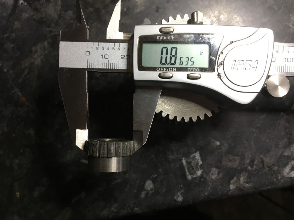

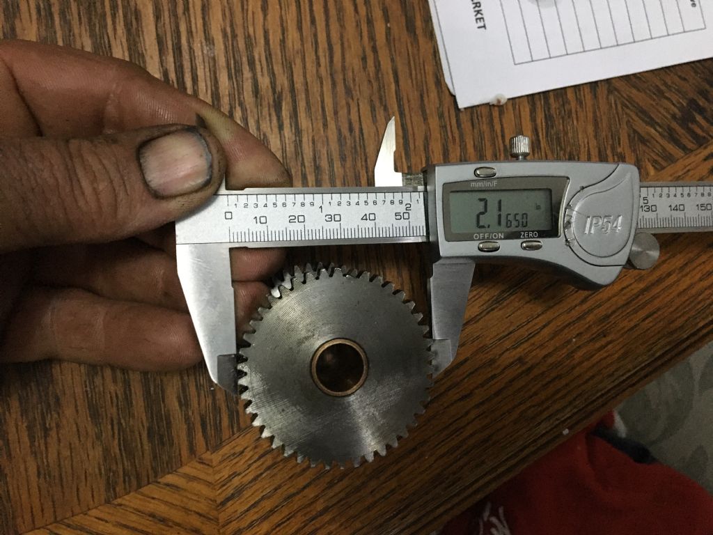

                          Mark Guy
                            @markguy26995
                            f18e60be-49bb-47b2-b633-129702bf163e.jpegc2f89005-09bc-443f-aa5c-563f7f514547.jpegJust re calculated the small 21 t as 1.0785 48515c08-e803-4c53-b06b-d9233755bcdc.jpeg
                            #514641
                            Mark Guy
                              @markguy26995
                              Sorry My mistake the small gear is only 20 teeth and I’ve checked and checked them both again 20 and 42 teeth

                                Posted by Mark Guy on 20/12/2020 21:19:11:
                                Thank gawd for that I was going a bit crazy with those numbers.
                                These are 1.25mod gears. Measure every dimension and I'll knock them out for you. You will have to give me centre distance as close as you can measure it. It should be 1.526"

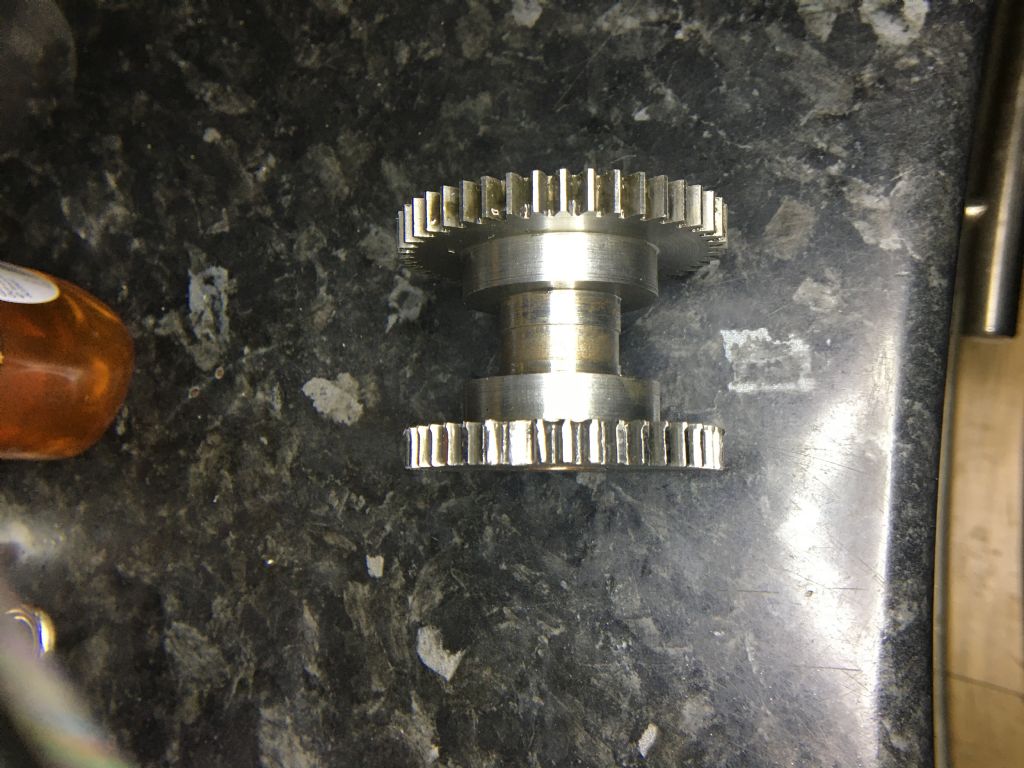

                                #514646
                                Mark Guy
                                  @markguy26995
                                  #514647
                                  Pete Rimmer
                                    @peterimmer30576
                                    Nothing's ever easy is it? Are the gears each end completely identical?
                                    #514652
                                    DC31k
                                      @dc31k
                                      Posted by Pete Rimmer on 20/12/2020 21:35:54:
                                      There is enough depth below the teeth of the big one to turn the old teeth off plus a good bit extra and shrink or loctite or Dutch key a large-bored new one on.
                                      The only thing to watch out for is if it is necessary for the teeth of the two to be timed/clocked to each other.
                                      Easiest way to confirm centre distances if it is difficult to do a direct measurement is to turn up two discs that are the pitch diameter of the two gears and bored to the correct measurement. Install on their shafts. If they interfere, the PDs are too big. If there is an excessive gap, the PDs are too small.
                                      Edited By DC31k on 20/12/2020 21:58:53
