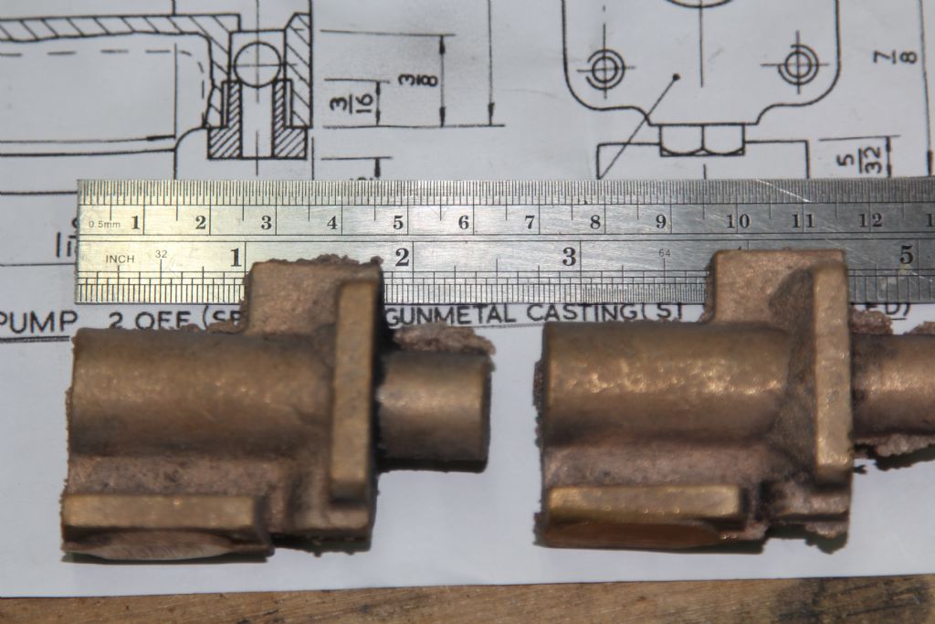

      Hi
      I recently had a bit of credit with Reeves so I bought the Hand Pump Casting for my Don Young Black 5. I was surprised when these two small castings turned up.
      Reeves are convinced that these are correct even though they are nothing like the DY Designs drawings. I told them they are not like the drawing so then they then sent me the drawing that they are photographed on but I'm not sure that's correct for the castings either. I also think some more of the drawings are missing.
      My question is do any loco builders recognise this pump casting and if so is it for a DY Designs Black 5 or something else?
      Also do these two pumps fit together somehow to be double acting? In the drawing the right hand end of the pump drawing seems to have a plate or something missing. Is this were the casting fit back to back?
      Hope you can help.

        #409989
        Bazyle
          @bazyle
          It looks like a multifucnction casting having a cast on foot in case needed and an extension on the right that is works as a chucking piece or in other arrangements could hold a valve.
          As to the 'missing' plate have you looked at where it is mounted. It obviously has the 6 bolt flange and probably mounts on a floor or sidewall. See tender drawing as it says under the rule.

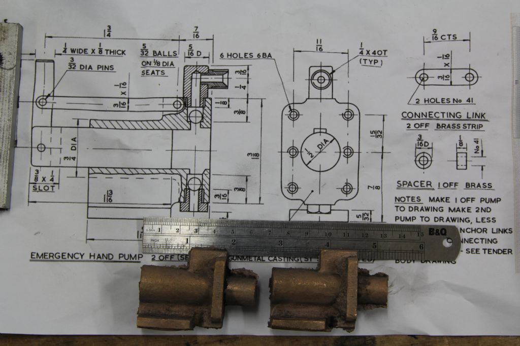

          #409992
          Weary
            @weary
            The drawing looks as if it shows a foot to the pump. It is partially obscured by the positioning of the steel ruler. Casting looks as if it will do the job as required by the drawing provided overall dimensions are sufficient.
            Regards,
            Phil
            #410005
            Paul Kemp
              @paulkemp46892
              Well the note on the drawing has me confused. Make 1st pump to drawing, make 2nd less – looks like anchor links? Obscured by the rule. That sort of suggests the two pumps bolt together on the flange? In which case you have two opposed rams, how does that work with one handle? Drawing in isolation makes no sense to me but as per usual in model "drawings" they are hardly really drawings! If you took them to any half decent machine shop they would refuse to make it without proper detail and tolerances.
              Paul.

                Weary
                  @weary
                  I had assumed that one makes two fundamentally similar pumps.
                  One fitted between the locomotive frames driven from an eccentric on a driven axle, hence no need for 'anchor links'. This pump to be secured to some kind of cross-brace/frame-stay using six 6BA fasteners through the end-plate. No need for 'foot'.
                  The second pump to be fitted in the tender and operated by hand as required ( "Emergency Hand Pump"  ). This pump to be secured using 'foot' perhaps; or maybe to a bulkhead in the tender using the same fastening method as on loco. If secured by 'foot' then a flat plate over the end secured using fasteners through the 6BA holes will do the job.
                  Unfortunately the notes which might clarify a little are partially obscured.

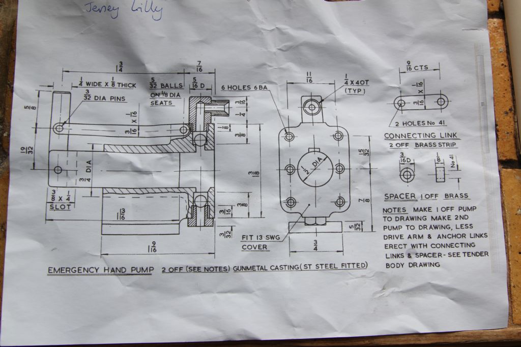

                        Buffer
                          @buffer
                          Nealeb
                          Here is the drawing that Reeves sent me when I asked for one. Its not Black 5 and I think its only half the drawing as it doesn't show how you fit these things together.
                          Baz the Black 5 doesn't have an axle pump it uses two injectors. These casting are identical and appear to fit together some how but I am clueless how. Not even sure if they are a Don Young design for something else. I will PM you for the pics.
                          Thanks
                          Rich

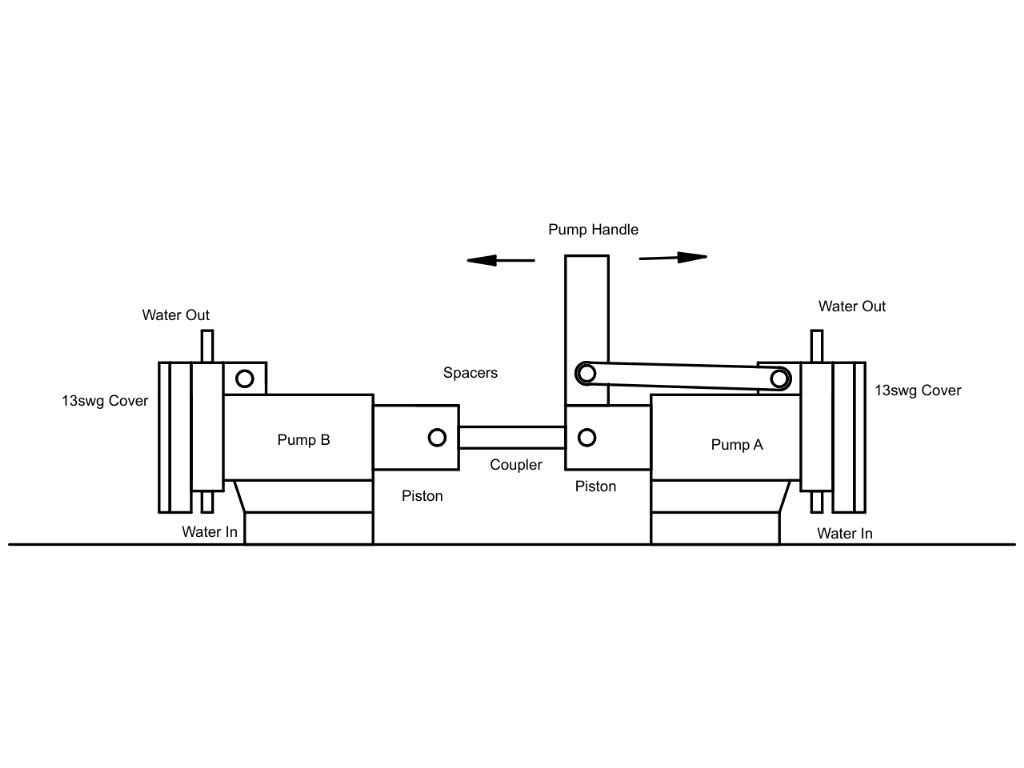

                          #410124
                            Reckon it means mount the pumps back to back:
                            The spacers are used to fit the connecting links (oops called it coupler in my drawing) into the slot cut in the other piston, necessary because there's only one rod to take the pump handle. Moving the pump handle backwards and forwards would cause one pump to blow while the other sucked.
                            Presumably fitted in the tender.

                            Buffer
                              @buffer
                              That's thinking outside the box, well my one anyway. It never occurred to me that they could be like this.
                              Shame its not just one pump though obviously twice the work.
                              Thanks for taking the time to draw this up.
                              Have you shot any more machines yet?wink
                              Rich
