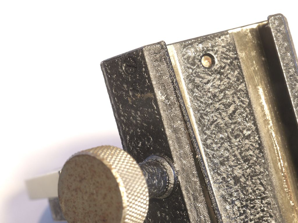

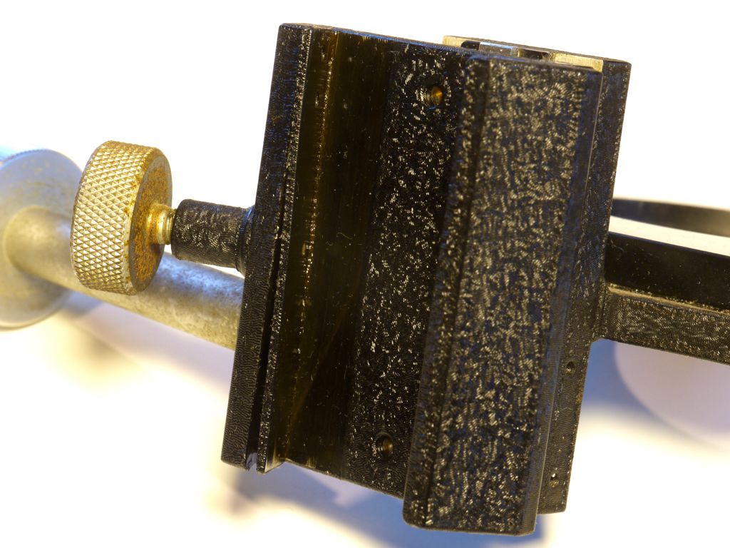

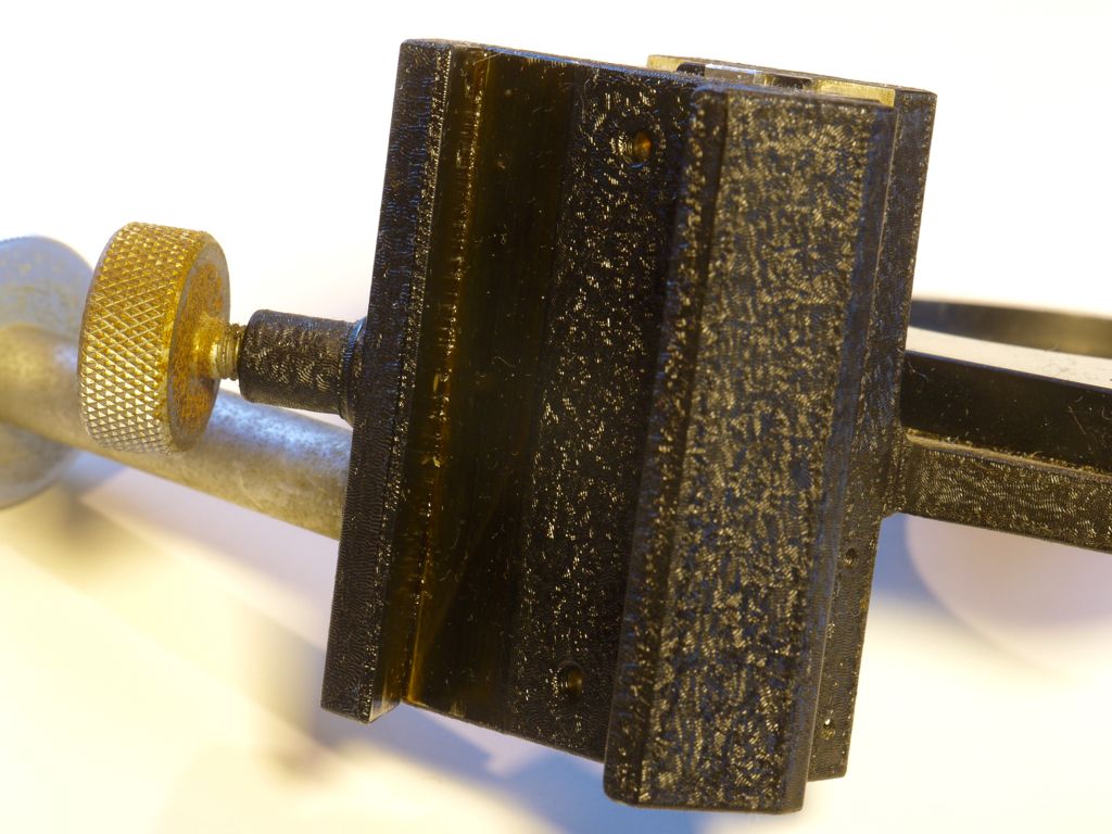

          This one is from a Leitz Macro Stand:
          The dovelail is quite light in section, but nicely cast and machined.
          A thin, springy, gib strip is attached by screws at one end [just visible under the crackle paint] … the slides are well-matched, and it only takes light pressure on the knurled screw to lake it from free-sliding to locked.

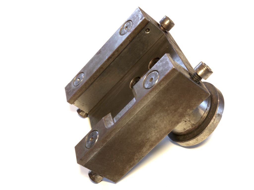

          #262243
            This one is from the Pantograph arm on my 'TN le Locle' machine … It locks a square-sided slide, but the system would be adaptable to a dovetail.
            The loose gib-strip is rigid, dowelled at one corner, and much thicker than the Leitz one.
            Behind the gib-strip is a 'cart-spring' which spreads the pressure applied by a single screw.

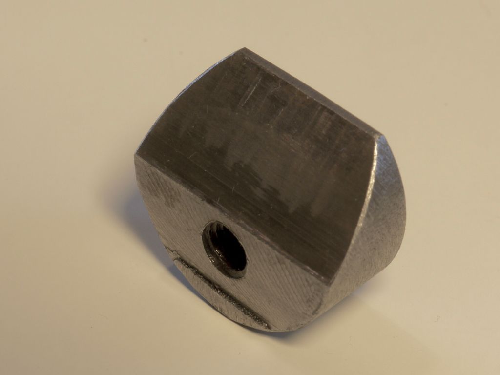

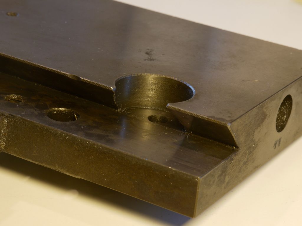

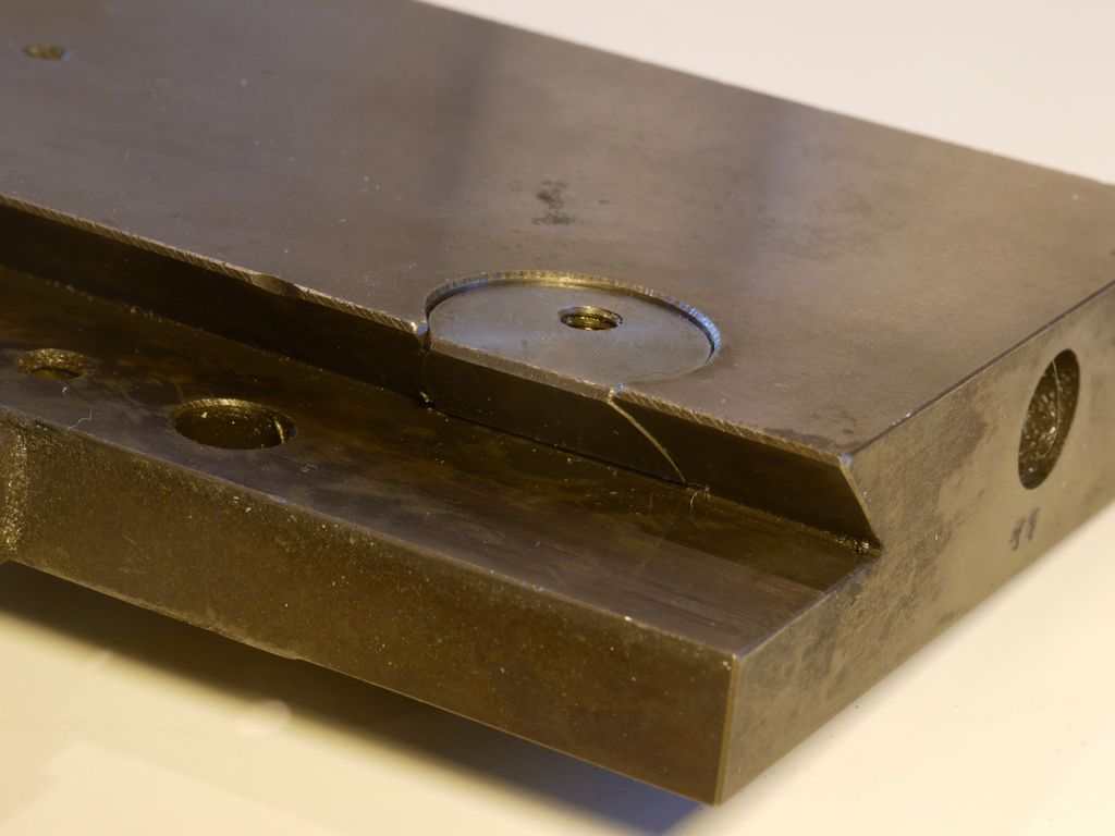

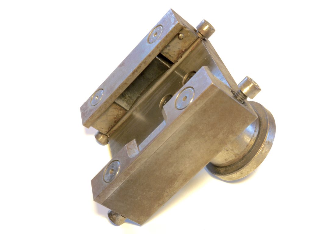

              Third, but maybe most relevant to Rodney's requirement:
              This is the system used to lock the slides on my BCA 'Jig Mill'
              The loose piece is shaped to match the dovetail angle, and features a small ridge on the underside.
              It is pulled into firm contact with the dovetail as the screw is tightened.
              Pick'n'Mix from those, Rodney … unless someone can suggest a better lock for your shaper.

                    On the Alba shapers the arrangement is a bit like what was shown on the other thread, except there are no adjusting screws, just three clamping screws. The gib strip is pulled up tight against the dovetail and the side of the cross slide and should not bottom out against the back of the cross slide. This works fine and clamps up very solidly. It would not be a good arrangement for something that was intended to slide in service.
                    So it seems to me that the arrangement on the Hercus could be used in the same way, eg adjust the screws on the side such that when the other screws are tightened, the gib strip clamps against the dovetail without bottoming out against the back of the cross slide.
