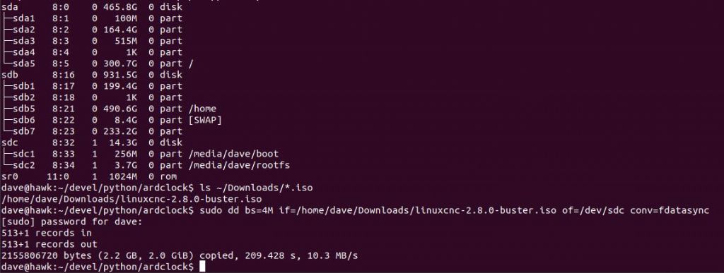

Rather than download UNetbootin or one of the other graphical ISO copy utilities, I did the copy from the command line using standard system tools. (If you have prefer Windows, RUFUS is great.)
Geek way, at the $ prompt, enter lsblk
This lists the discs mounted on the system.
Near the end, the memory stick is identified as disk sdc. Note this can vary, depending on how many discs are mounted on the computer.
Next the ls ~/Downloads/*.iso command lists all the iso file in my Downloads directory. There's only one:
/home/dave/Downloads/linuxcnc-2.8.0-buster.iso
Then sudo dd bs=4M if=/home/dave/Downloads/linuxcnc-2.8.0-buster.iso of=/dev/sdc conv=fdatasync
which means:
- sudo – run the next command with admin privileges
- dd – file copy utility, more powerful than cp in that it can write to a disk rather than to a folder.
- bs=4M – write in 4Mb blocks, only because it's faster
- if=/home/dave/Downloads/linuxcnc-2.8.0-buster.iso – the input file is LinuxCNC
- of=/dev/sdc – the output file is the disc /dev/sdc, ie the whole memory stick.
- conv=fdatasync – don't finish until the disc confirms writing is complete
Warning! dd does exactly what you tell it. No safety net. If I accidentality typed sda rather than sdc it would overwrite my main fixed disc. The graphical tools all assume the user is an idiot and issue helpful warnings, or stop anything other than a USB stick being written.

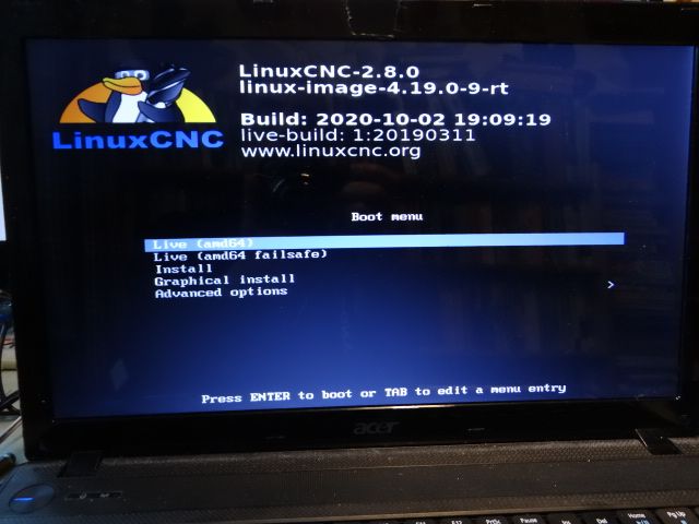

ISO copied, I plugged the memory stick into an Acer 5742 Laptop, and switched on. The Acer is a 64-bit i5-480M.
I pressed F2 to get into the Boot Menu and confirmed the memory stick was the first bootable device. (This isn't always the case.)
Carried on and the laptop booted with the LinuxCNC splash screen:

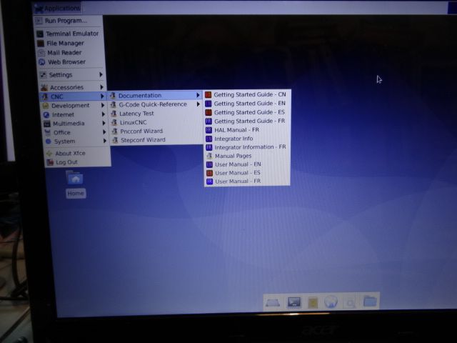

Selected the Live Option, (ie run from the memory stick without installing anything), and got Debian, with LinuxCNC on the menu:
This is almost identical to the Pi4 version because both are Debian flavour Linux, except the Pi updated and set-up the network etc, whereas the Live Disc probably leaves all that until the full install.
Although running Live from a USB stick is fully functional, it's painfully slow. The purpose is to confirm stuff works rather than to provide a real system. If whatever fires up as LinuxCNC did above, it's probably compatible with the hardware and safe to install permanently.
