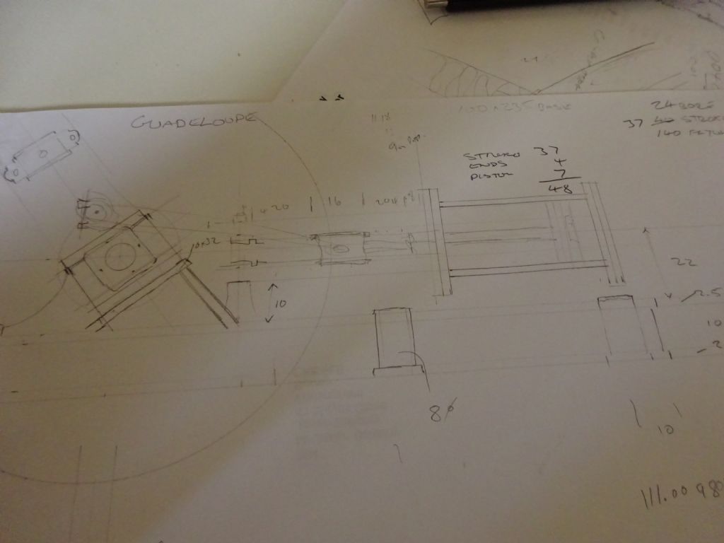

Started with a basic fag packet hand sketch just to get a few basic proportions

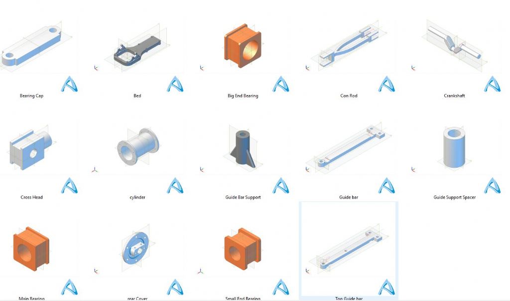

This is the screen shot of what parts I have drawn so far, just basically coloured to indicate material no nee dfor fancy renderings at this stage.

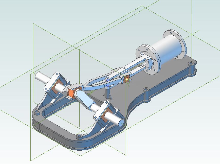

And this is the assembly. What you can't do if you draw it as a set of 2D elevations is rotate the crank and see how the piston rod and cross head move or move the whole assemby around to look at it from any angle. Or if i change any one of those parts it will automatically update the assembly this is the parametric part.

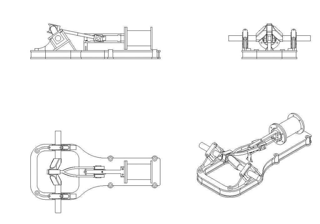

From there it is just a few clicks to produce the GA drawings complete with an isometric and this drawing will automatically update with every change or additional part added.
As I said earlier I'm just a self taught user, not even an engineer and just picked it up by watching a few videos and having a go. That's about 2hrs work at the most on that engine so far

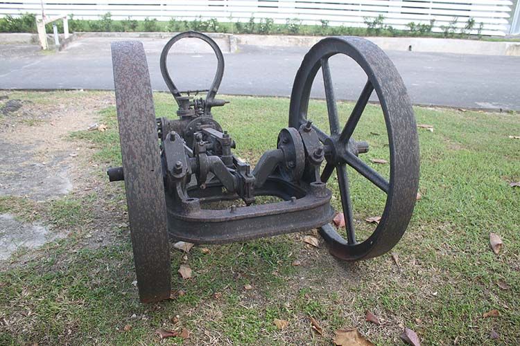

A rather unusual engine design there, Jason, with that long bifurcation on the connecting-rod and very wide angles in the crankshaft. What was it (the original)?

Its just an engine from a Rum Distillery, may have run a small set of cane crushing rolls or been used for something else.
