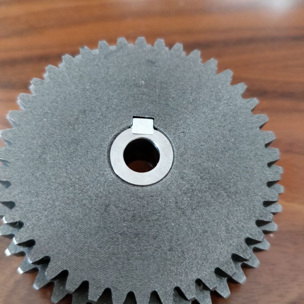

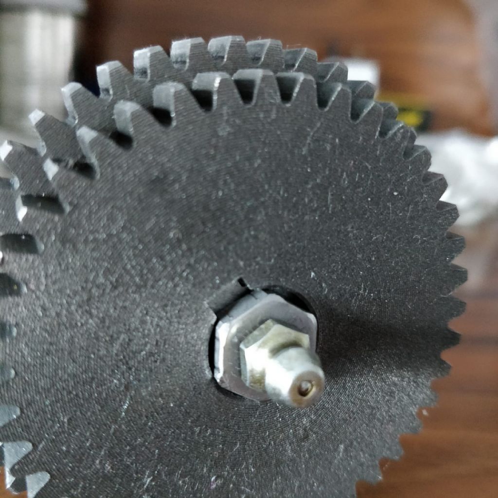

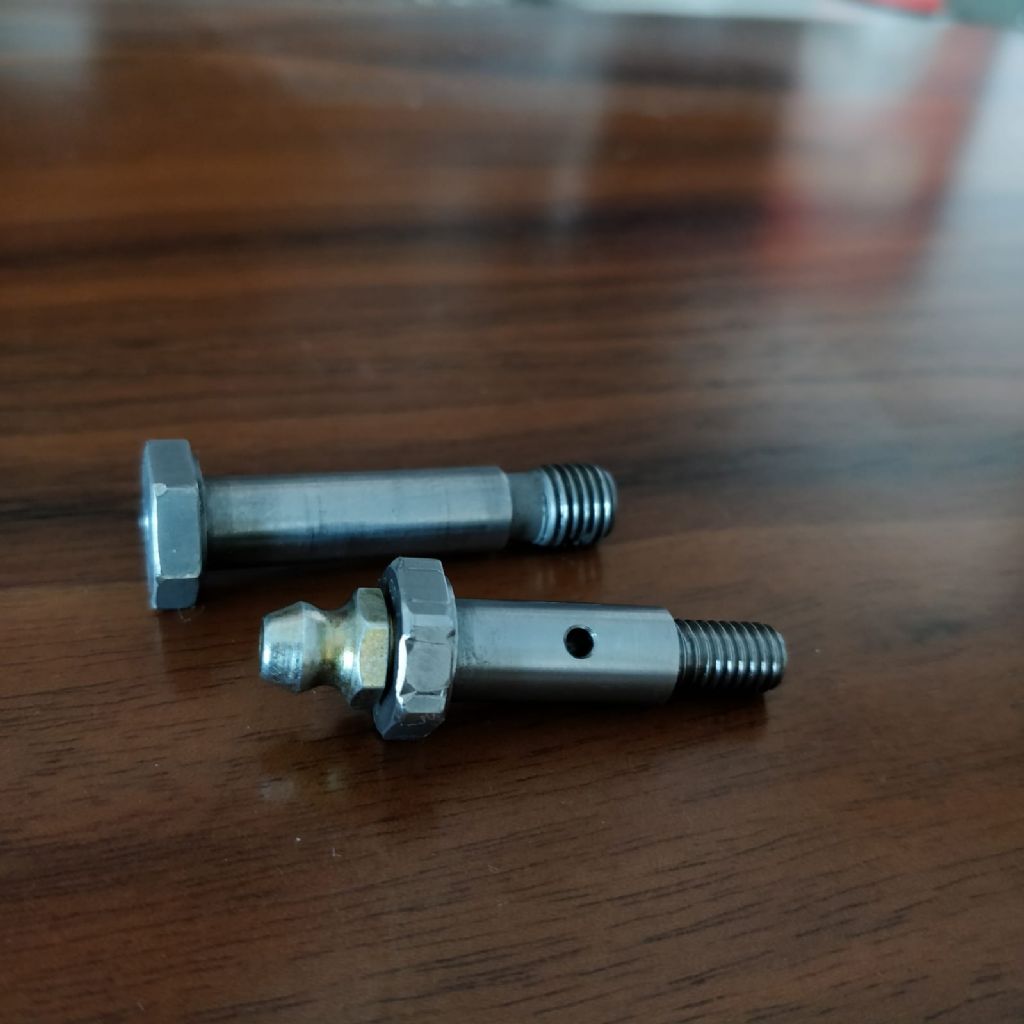

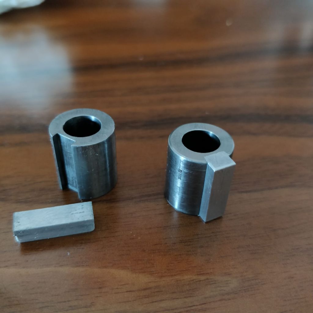

      Should not need any bushes anymore if my planned mod works out…but I'll keep a couple of spare keys just in casesmile p
      Bushes and keys – the key is aluminium so there's an easy fix failsafe should I mash up again. Bushes are 8mm dia instead of the original 10mm – not sure of the material, could be stainless or titanium as I mage them from a bolt which conveniently was the exact outside diameter.
      Conveniently used a 5/16" cres bolt which fits perfectly on the 8mm bushes. Added a grease point for lubrication and rethreaded the bolt to M6 to fit the T-nut on the banjo.
      Bushes are a sliding fit on all gears, so there'e no more tapping to force them on. As the gear bores are not exactly uniform some fit a bit tight while some slide right on but none are loose or hammer tight.
      The gears will slide right off the shaft when the retaining washer is removed ( it will either be a c-clip or two halves) so I won't need to take the whole thing apart.
