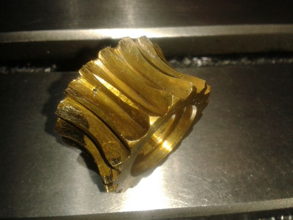

                                        While going through the parts I removed I noticed that the worm gear on the feed shaft looked a bit odd, I would say it's got a fair amount of wear on it especially at the ends where it comes to knife edge, what do you recon, is it normal wear?

                                          That gear is for the power long / cross feed , i have worse in my lathe and it still works i would have a real close look at the half nuts though .

                                            I don't have this lathe but I suspect the 'knife edge' is as made. The leadscrew won't reach the bottom of the gear so wear will typically show up as a circular ridge near the bottom of the tooth. I don't see any on your picture. I t will mostly wear from one side as the motion is mostly towards the headstock. Worth cleaning off the swarf and grit regularly.

                                              You're right XD, it's the feed shaft gear. Good, nothing to worry about then…I'll get on with rebuilding the thing back and hopefully it will run again smile p

                                                  Posted by ChrisB on 21/12/2018 10:10:26:
                                                  While going through the parts I removed I noticed that the worm gear on the feed shaft looked a bit odd, I would say it's got a fair amount of wear on it……..
                                                  No wear, it's what happens at the edges of a worm wheel. This is a detail of a home hobbed worm wheel for my traction engine steering:
                                                  If I hadn't truncated the ends of the teeth they'd be pointed, as per the photo posted by Chris.
                                                  Andrew
