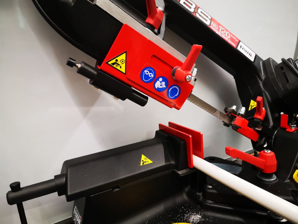

      The link below gives details of construction of a laser based cutting guide to help stock positioning on a Femi NG120ABS. The device may be applicable to other bandsaws or cutting devices.

        Cut the frustration when setting the stock in the vice

            The cut will be a constant distance from the vise jaw? Is that really too difficult to achieve – without one of these?

              Not being related to an octopus I struggle to hold a short chunky unbalanced piece of stock in the right position between the clamp jaws, measure the protruding length and tighten the vice handle simultaneously. Clearly I am at a physical or perhaps mental disadvantage to more worldly folk.

                May be handy if you are using it for mitre cuts
                Myself I just lower the blade until it is just above the workpiece and slide that along until my mark is under the blade
                  Just it has been done since a powered sawing machine was invented. Never needed more than the 2 hands I was given.

                      Way to go Andy … there has been a lot of interest so I have updated the blog with a download ZIP file with the Gerbers and STEP files.
                      In passing I sent the laser details to the UK Femi agent and they told me that Femi have now starting to fit lasers to their new models starting with the DCS110.
