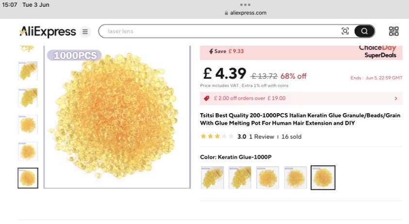

      In the daily deluge of suggested purchases from Ali came this:
      Tsitsi Best Quality 200-1000PCS Italian Keratin Glue Granule/Beads/Grain With Glue Melting Pot For Human Hair Extension and DIY
      SPECIFICATION:
      Quantity: 200/400/600/800/1000 PCS
      Material: EVA
      Melting Point: 270℉ to 340℉
      Curing Time: 10 to 15 seconds
      Cooling Time: 5 to 10 minutes
      WHY CHOOSE US?
      1000pcs keratin extensions kits with strong adhesion is enough to solve many adhesion problems in your daily life.
      Our keratin glue for hair extension made of non-toxic and harmless materials, is safe to use and won’t harm your hair.
      You can use these keratin hair extensions to decorate manuals,cartons, toys, shoes, ceramics. All keratin glue beads will provide you convenience during DIY.
      REMOVAL GUIDE:
      Step 1: Add few drops of acetone on the keratin bonds.
      Step 2: Crunch the keratin glue with ridged removal pliers until the keratin beads turn dry and powdery.
      Step 3: Comb out powder and wipe hair to make it clean.
      _____
      I had never heard of Ketatin Glue, but the stated properties sound useful.

                My real query is their description “Material: EVA”
                It’s not EVA if it’s Keratin glue.
                ” Ethylene-Vinyl Acetate, a versatile copolymer known for its rubber-like qualities”
                A more familiar name in The UK  for “Keratin Glue” might be Pearl Glue, still used by cabinet makers & luthiers etc.
                Lots of UK suppliers without going to Ali, this is just one of many
                https://restoration-materials.co.uk/product/pearl-glue-500gms/

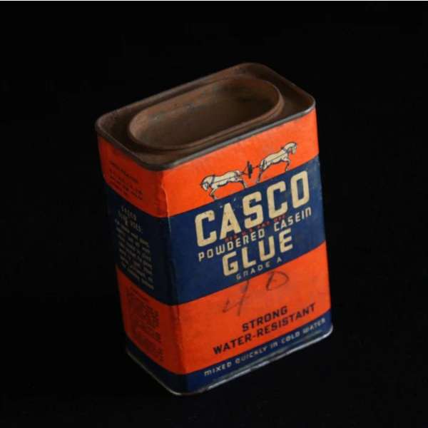

                                The joiners shop where I served my time (1951) we used a powdered glue called Casco it was just like powdered Horlicks the hot drink powder. when Cascamite came on the market we used that.
                                Casco 1
