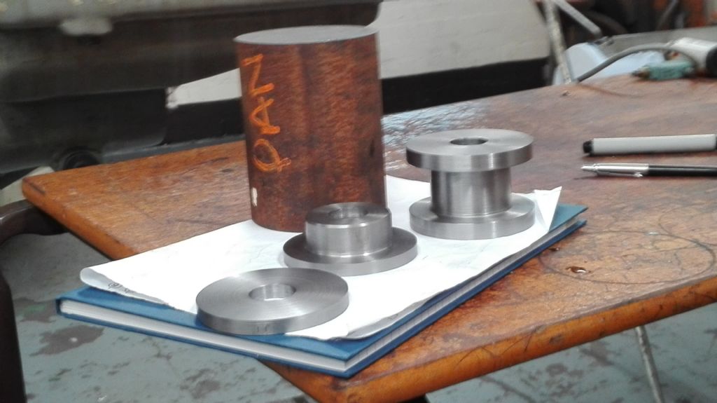

                                img_20161003_181115.jpgHi just a couple of pics to show I've not been idle. One shows my front hub and covers that have been made from one piece of round 100mm such as the one in the picture. I have since made another one of each from this piece of steel. Another pic shows a hub after I've machinex the slots for my spokes.img_20160918_171606.jpg

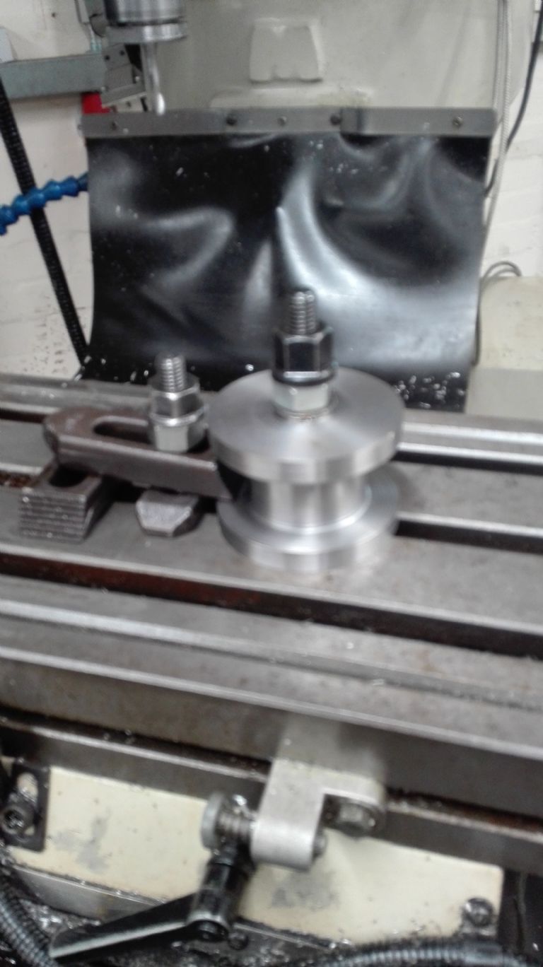

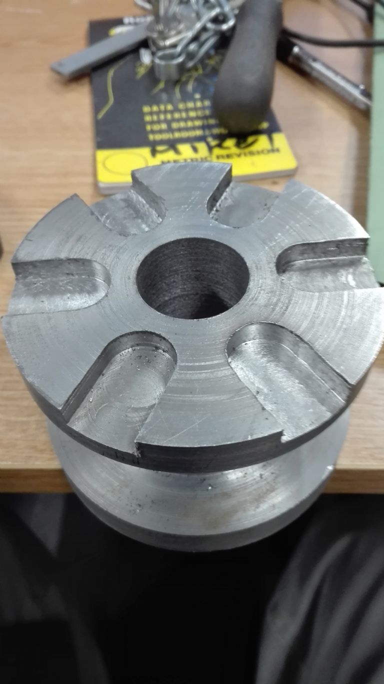

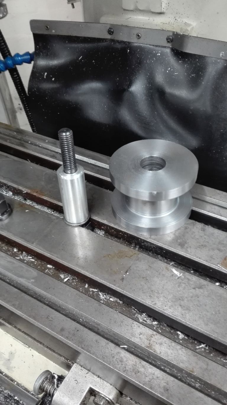

                                  img_20161001_151732.jpgWhen I came to mill the slots for my spokes I needed to rotate the work. Whilst I had access to a rotating table I wanted to try something new. So I turned a dummy axle that fitted the inside of my hub and after drilling its middle out I T slotted it to the bed of the mill. After fitting the hub over it I could rotate the hub through 360° and clamp it in place for machining.

                                        Off to a good start Mr Mike
                                        I'm not sure what the Foster drawings show but as the hubs were originally cast it is usual to replicate the radiused corners on the hubs which could still be added if you wanted to. It's a bit of a personal thing, some like to get the engine done and out on the rally field ASAP, others tend to like to get the details as original and may not steam the engine much.

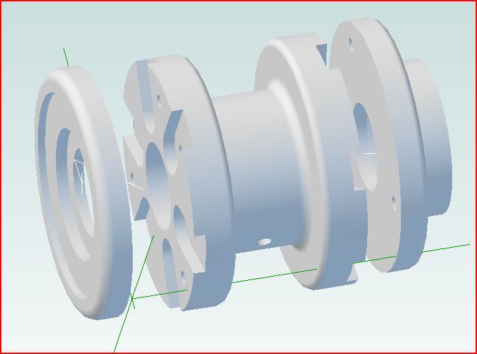

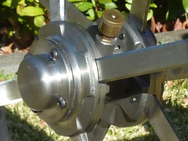

                                            #259234
                                              Mike, it was not the mating faces that I was saying should be rounded, as you say when they are assembled with your favorite epoxy the joints should not be visible under a coat of paint so you need those as crisp as possible.
                                              It is the two inner faces and the outer faces of the inner and outer cover plates, Don't have a good close up photo of the front hobs on my Fowler only this part assembled wheel which were also cut from solid but if you look at this one of Paul's you can see the mating faces are square edged but the other external corners all rounded this can either be as cast on teh model hubs or if cutting from solid added with a simple form tool.
                                              Edited By JasonB on 04/10/2016 20:33:35

                                                  Hi, as this is rapidly coming the place for good reliable advice for me I have a query regards lubrication for my front hubs. I plan to fit plain bearings in two halfs (as sugested here, thanks). My drawings simply a drilling in the side of the hub. Does one fit a flip top oiler or simply use the drilling as my lube point. My phosphor bronze is missing in transit at the moment so my hubs are on hold. Not wishing to name and shame yet but I have an email saying it was posted 3 weeks ago. I've tried to email back but its a no reply type email address, so ive rang and left messages but no joy yet.
                                                  To keep myself busy ive started machining my front axle from a piece of square steel and whilst I can obviously get it to within tolerance via the drawings, if someone has a photo of a cast one the could show me it'd help me get it spot on.
                                                  #261466
                                                  Paul Lousick
                                                    @paullousick59116
                                                    Mr Mike,
                                                    I used grease to lubricate the bushes in my hubs. Oil will run thru the bearings onto the ground unless the axle shaft is fitted with seals. (the trouble and strife (wife) would complain bitterly if I stained our driveway with MY engine)
                                                    Paul.
