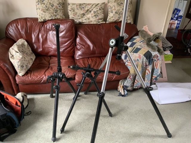

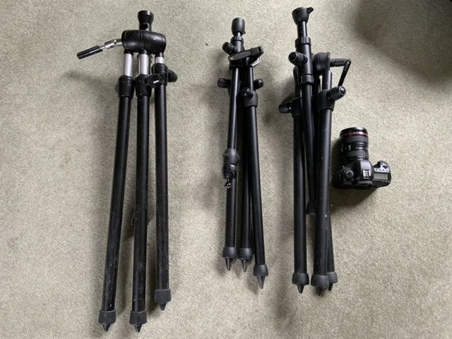

                                  Ian Parkin
                                    @ianparkin39383
                                    Michael
                                    here they are you can have any one you desire
                                    theres a benbo Mk 2 cut down slightly so more of a 1.5
                                    that will go to over 6ft tall
                                    then theres a uniloc one with a horizontal mount (this is the spindles one and lightest
                                    then a triloc one meatier and heavier than the uniloc
