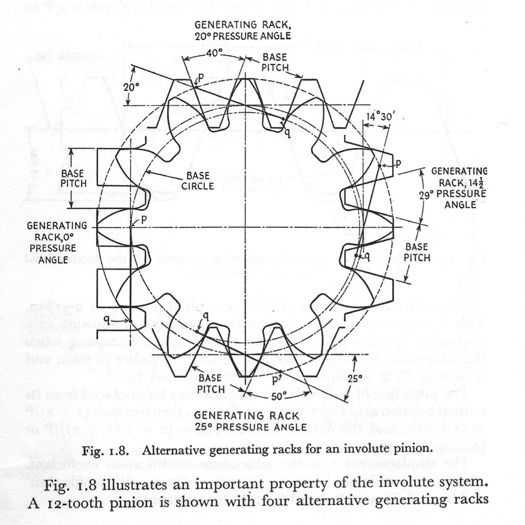

      This illustration surprised me :
      #287286
        As a spin-off from this recent thread **LINK**
        http://www.model-engineer.co.uk/forums/postings.asp?th=124817
        Andrew Tinsley and I have been sharing thoughts about the geometry involved in the process described in the article by 'Base Circle'.
        In the course of our discussion, I remembered this [rather astonishing] illustration from 'Gears for Small Mechanisms' by W. O. Davis
        It does indeed seem clear that these four different racks all generate the same tooth profile dont know
        … So … What is it that defines the Pressure Angle of the resulting Gear ?
        [ I had always assumed it to be the Pressure Angle of the generating Rack ]
        Explanations, in writing or pictures, would be greatly appreciated.
        … I'm feeling rather dim.
        #287288
          Explanation:
          A quick inspection of the left had 0-degree rack shows the answer, the teeth are half the width of the spaces. Rotate the gear to where those edges would be if the teeth and spaces were normal width, and the angle you turn the blank will be the pressure angle.
          Another explanation would be to imagine cutting a gear using a slitting saw. You can either angle the saw at the pressure angle, or move the saw sideways until the blank is rotated by the pressure angle.
          A third explanation: It doesn't matter what the angle is, as long as the cutting edges are tangential to the teeth at the point of contact when the rack is centred over a tooth.
          It follows that the pressure angle is the angle of the symmetrical rack* whose cutting edges are tangential to the teeth at the point of contact when the rack is centred over a tooth.
          *Ignoring any addendum added to generate the dedendum.
          #287305
            You may be right, Neil … but I'm sorry to say that your explanations haven't quite sunk-in.
            The 0° rack is, I agree, distinctly asymmetric; but the 20° and 14.5° racks appear to be standard profiles … so how to they each generate the same tooth-profile, and how to we decide what Pressure Angle that represents on the resulting Gear? [no quantum physics answers, please].
            I think it must be to do with the different Pitch Circle diameters … but I still can't get my head around it.
            #287310
              I think there are truths in both our observations.
              Note that for the 0-degree rack the base circle and the PCD are the same.
              None of the illustrated generated gears have thr PCD half way up the tooth as you would expect for a 'standard' gear.
              In other words they are ALL examples of gears cut for an increased centre distance. This is normal practice when cutting gears with low tooth counts, you increase the separation to reduce undercutting.
              It's well known that involute gears are tolerant of errors in PCD and spacing. The diagram shows why – you can adjust the tooth profile bay varying the cutter infeed.
              It also suggests that, when making my jovilabe gears on 'incorrect' PCDs, I could have improved the tooth profiles by using extra or reduced feed – something i discovered 'by accident' without realising what was happening. Some of my gears had too-thin teeth (I should have reduced infeed) and some chunky gears were improved by a second pass with a little more infeed.
              I may be misreading the diagram, but it appears to suggest that if you want well-formed oversize gears then reduce the infeed or, ideally, use an over-length cutter.
              My 'rack formed' gears will all mate with a rack, and each-other for the same infeed but varying PCDs. What I hadn't realised is that well-formed and 'pretty' looking gears of varying PCD can be cut with the rack form.
              There is obviously a limit, however, otherwise you would be able to use a rack of any pressure angle to cut a rack with a different pressure angle.
              So where is the limit? My guess is that the straight-sided rack gives us a clue, it's ends are bevelled to provide clearance – does the principle fail when the required PCD becomes equal to or less than the diameter of the base circle? Increasing the angle, perhaps the fail point is when the PCD equals or exceeds the OD?
              I'm sure Andrew J. will be long in a while to explain it all for us

                #287319
                John Haine
                  @johnhaine32865
                  There's is only one involute curve from a given circle. I think this is the key.
                  #287327
                    Posted by John Haine on 05/03/2017 22:21:48:
                    Nice thought, John … but my problem is that in practice, gears made with various Pressure Angles have a range of obviously different tooth shapes.
                    Post #21 in this thread includes a nice animation:
                    https://www.chiefdelphi.com/forums/showthread.php?t=129632&page=2
                    Comparing those tooth shapes with the figure that I posted just doesn't seem to make sense.
                    Edited By Michael Gilligan on 05/03/2017 22:48:37
                    #287335
                    Andy Ash
                      @andyash24902
                      I think they get away with it in the drawing because they only define the pressure angle for a pinion against a rack.
                      The rack has an infinite pitch circle so its involute tends to a straight line.
                      Perhaps the consequence, is that the pinion does not have to define a specific pressure angle.
                      I'm guessing that you could use any number of involutes for different pressure angles on the pinion, and control the actual pressure angle simply by the tooth profile on the rack.
                      This might be the same as meshing a 15deg and a 20deg gear pair. The actual pressure angle is a different number again, but whatever it is, that is the pressure angle.
                      I suspect that that if you did this with two gears, then you would get a pressure angle that varies as the teeth pass each other. With the rack (infinite pitch circle), the pressure angle is constant as the pinion rotates. I suspect it's like this because one of the involutes is a straight line.
                      Even if I'm wrong, I would suggest that it's not a very helpful drawing, especially if you know anything basic about practical implementation of straight cut gears.

                              OK,
                              Imagine starting with the straight sided rack, now move to VERY long thin teeth, like 5-degrees. Imagine the teeth getting bigger and bigoer angles, until at about 80 degrees they only cut tht tips of the gears.
                              The tip of the cutter formed from the rack gets narrower and narrower until it becomes a point, and beyond this it can't cut the full depth of the gear. Equally the upper part of the rack teeth gets wider and wider.
                              Measuring the diagram shows that the tips become proportionally narrower as the pressure angle increases.
                              So the angle of the rack matters not as long as it can cut the full depth, it just needs to be positioned closer to the gear centre as the PA increases and the tip adjusted if it might cause undercutting.
                              Remember the PA of the gear is the angle the tangent to the gear makes on the PCD and the generating rack of the same PA is the ONLY one that will be tangential on the PCD when exactly aligned over a tooth. Larger PAs will be tangential outside the PCD, smaller pressure angles below the PCD.
                              The trivial proof of this is that a form cutter in the shape of a 'negative tooth', which blends racks of multiple pressure angles each at a different depth could cut a tooth-space at one pass. It just happens to be easier to make cutters that fit tooth-spaces rather than around teeth!
                              Next lesson – to avoid undercutting, use a rack form cutter with a larger pressure angle but make the teeth over-long so they are narrower than normal and use the usual infeed.
                              Neil Wyatt MBE (More Bullcrap Exposited)

                                #287367
                                  Posted by Neil Wyatt on 06/03/2017 07:53:09:
                                  OK,
                                  Neil,
                                  Perhaps the problem is that I'm trying to understand the W. O. Davis diagram in the context of the article by 'Base Circle' … in which he illustates a typical cutter, and states:
                                  Using the suggested method, the cutter is a straightforward shaper tool, ground to the form of a rack tooth of the diametral pitch to be cut. The sides are straight and inclined to the centre-line at the same angle as the pressure angle of the tooth—i.e., usually 141/2deg. (an included angle of 29 deg.). There is no difficulty in making such a tool, and if the same tool is used for the two wheels which are to mesh together, there is not even any need for meticulous accuracy in the tool. The cutting edges are backed off in the usual way.
                                  A drawing of such a tool appears in Fig. 2. This cutter will be suitable for all numbers of teeth of this particular diametral pitch.
                                  http://neme-s.org/Shaper%20Books/Michael_Moore/shaper%20gear%20cut.pdf
                                  In the specific case of generating a gear, by shaper, from a rack-form cutter …I am struggling to correlate what I see as conflicting statements from the two Authors..
                                  #287373
                                    There's a clue, you can correct for any error in the angle by adjusting the infeed.
                                    Also, to use a rack form cutter for a different pressure angle, you have to modify it by making it longer or reducing the tip.
                                    #287382
