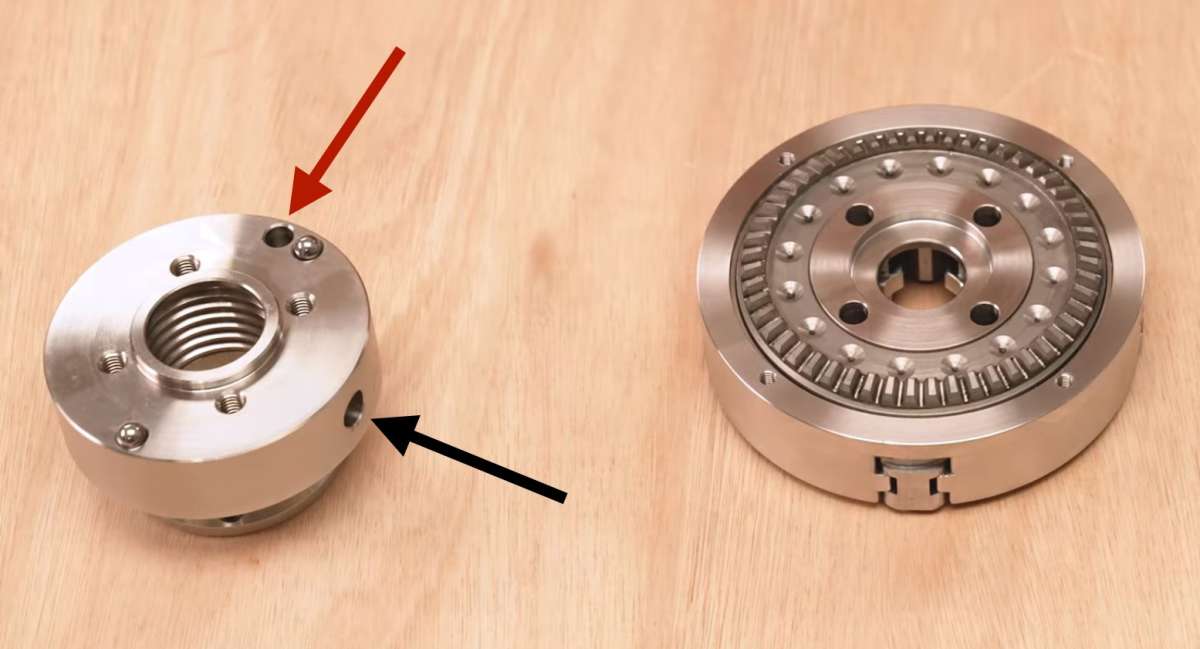

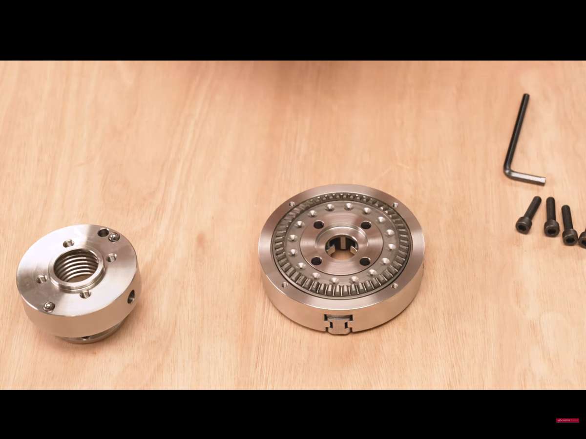

      This is one of Axminster Tools New Woodturning Chucks. I took this screenshot from the video and couldn’t help noticing the detent balls and corresponding recesses in the scroll wheel. I’ve not seen anything like this in a chuck before.

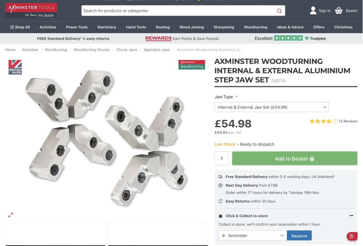

                          You can get engineering style Top Jaws for Axminster chucks but only in Aluminium.

                              The detents are probably because it is used on wood. If the chuck relies on friction in the parts when tight to hold its position then the softness of wood will allow it to loosen in use. The detents were probably because they found the regular chucks did slacken off in use. One would expect that to be patented though if it proved effective the rogues would copy it anyway.

                                  My concerns about having detents is what might happen if the tightness was just right, but the balls were moving out of the detents at that point. The spring pressure would then be trying to loosen the chuck.

                                      I’ve been trying to get my head around this design:
                                      It seems to me that the balls and detents are a ‘face-lock’ for the backplate … to take the torsional stress off the relatively small fixing screws.
                                      Comments welcome !

                                        Another mystery. The hole arrowed black is for the chuck key, there should be another on the opposite side. What about the one arrowed in red? Could this be for lubricant for the detent? Seems quite large.

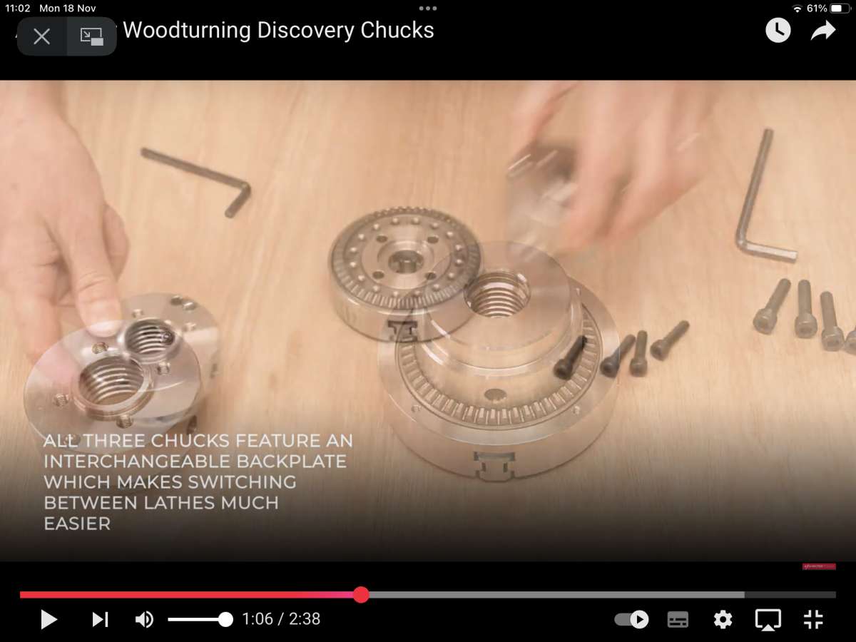

                                          Another thing I noticed was that there appears to be a universal body type, in either 88mm or 100mm diameter. This Chuck body seems to be able to accommodate back plates of two different types?  One completely encloses the scroll wheel and has pinions for the (square) chuck key. The other leaves the teeth of the scroll wheel exposed and uses a toothed chuck key. Both types are seen being fitted in one of the videos.
                                          Only one type (exposed scroll) is available as a spare on their website though!
