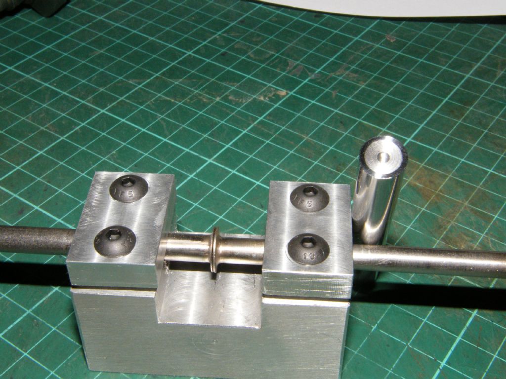

                      Here is a photo of the Ø3/8" ground hardened dowel with the end machined and centre drilled the shiny edge gives an idea of depth of hardness.
                      These ground hardened dowels depending on diameter can be up to 6inches long they may be of use to model engineers requiring a hard wearing pin for some applications.
                      **LINK**
                      Also my Tig welding jig for repair of my steam generator tubing with a test piece in it.
                      Paul
                      Tube welding jig and hardened dowel test machining.
