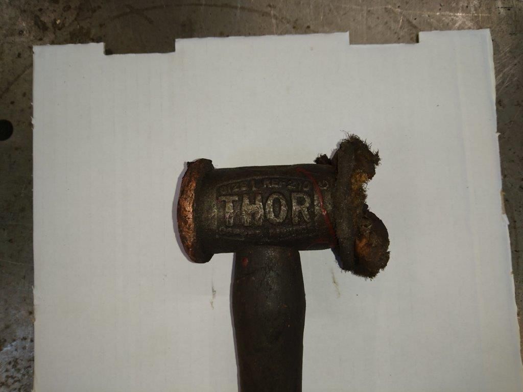

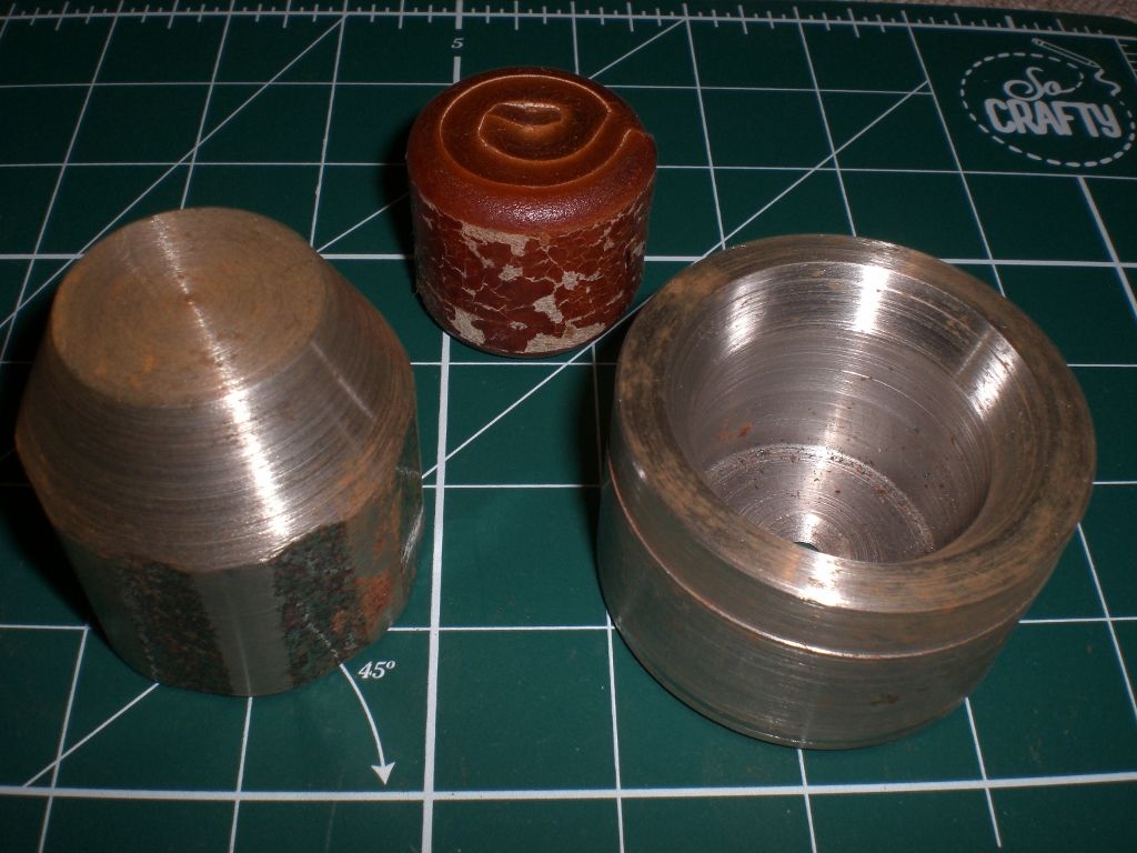

                    Hi Simon, I actually made the tools that not done it yet has referred too, from drawings and instructions from the Thor website, **LINK** . They didn't take all that much making, but you do need a couple of lumps of good steel, one about 50mm dia. and one about 60mm dia. and both 40 to 50mm long for a No. 2 size hammer. I didn't go to the trouble of hardening and tempering them as per instructions, as I don't think it is needed for the few times they may be used.
                    When I used the tool to swage the opening out, the opening just fractured and some of it broke off completely before it opened big enough to get the new hind in. This doesn't mean that this will happen on every hammer though. I have been thinking of a way to fit a new piece to the hammer to solve my problem, but haven't found any spare time to do that so far.
                    The copper ones are not worth the effort to replace, but they can be used until they are thrashed to the death.

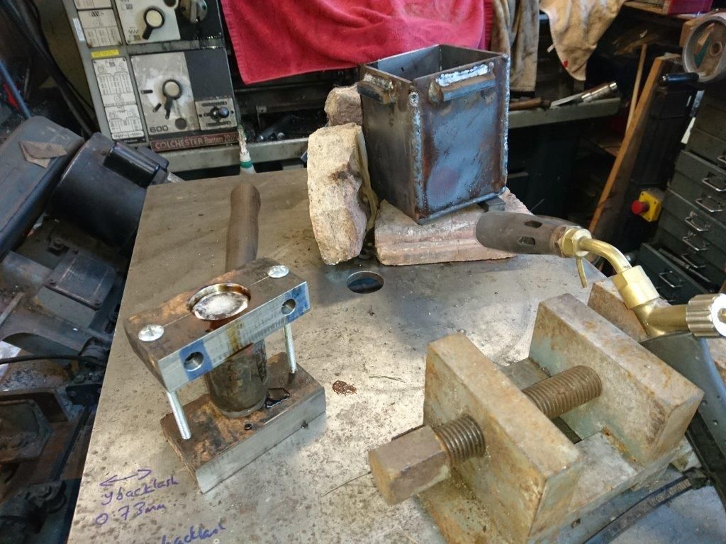

                                      Well, I liked John Olsen's suggestion of casting a lead insert in situ, rather than the complicated plan I'd thought of to machine the socket out to avoid stretching the casting. So Here's a picture of the state of the poor old hammer, which prompted my initial post

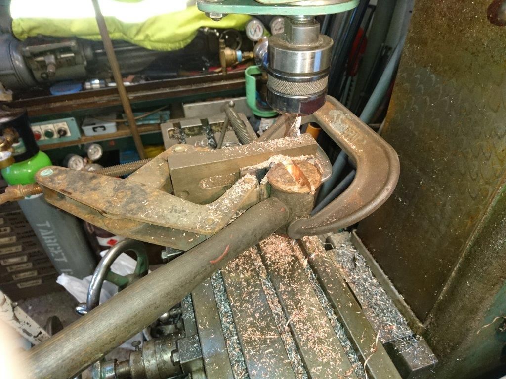

                                      The tatty hide end came out by following the instructions from Thor – drill a hole in it and unwind the leather. Easy Peasy. I resorted to amateur dentistry to extract the copper insert. If I'd realised what thickness of copper still covered the cast iron I wouldn't have bothered.

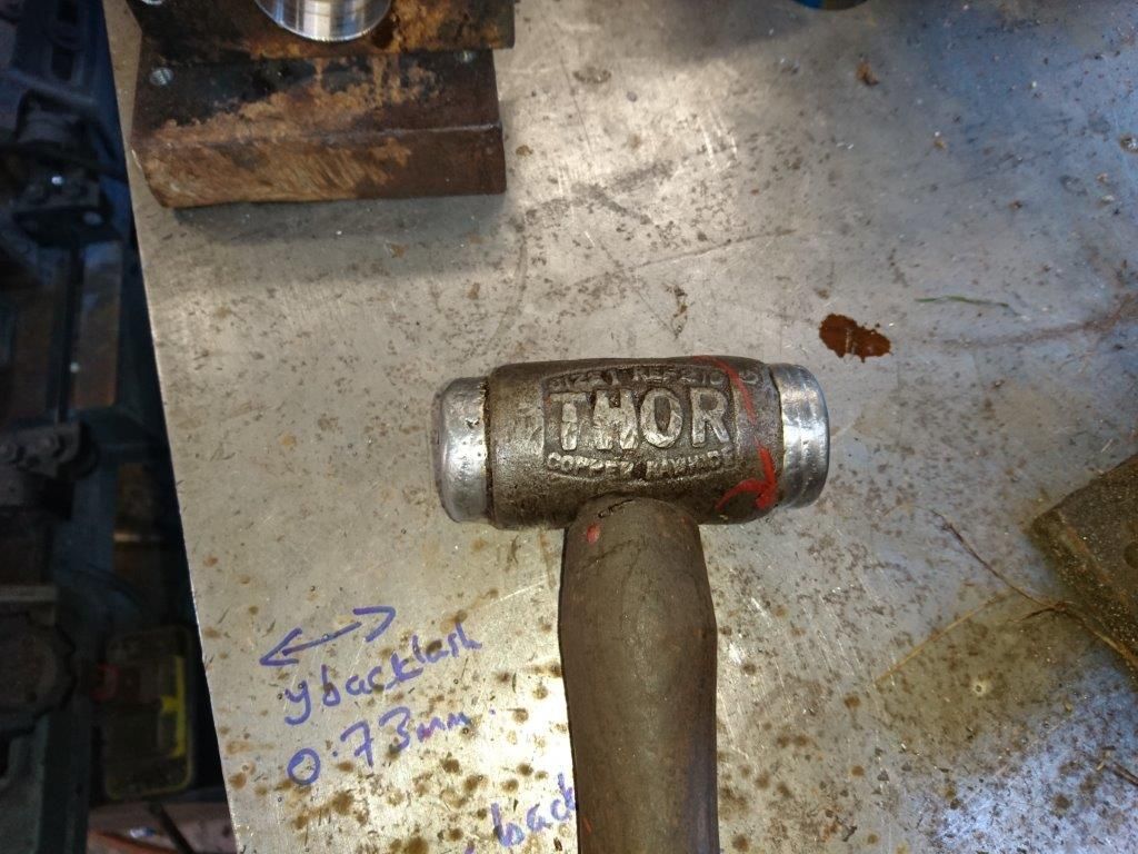

                                        Here's a picture of the lead casting cooling – this is the second one.
                                        And here's a picture of the finished article
                                        Was it worth all that commotion – never in a million years. But I enjoyed it!
