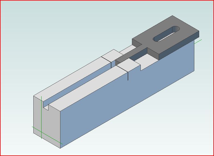

                            Maybe make something like this with a stop to set your lengths, slot to take a knife or razor saw and simple clamp to hold the work.
                            Similar design here
                            Edited By JasonB on 26/05/2015 12:16:49

                                  #191307
                                    Simple block of wood with two strips of hardwood fixed to the top to make a channel to take the tube, stop cut from thin material with a slot for two screws to lock it. if the strips were shallower than the tube OD you could just press it down by hand while cutting so no need for a clamp.
                                    Either roll a knife blade over the tube guided by teh slot or use a razor saw

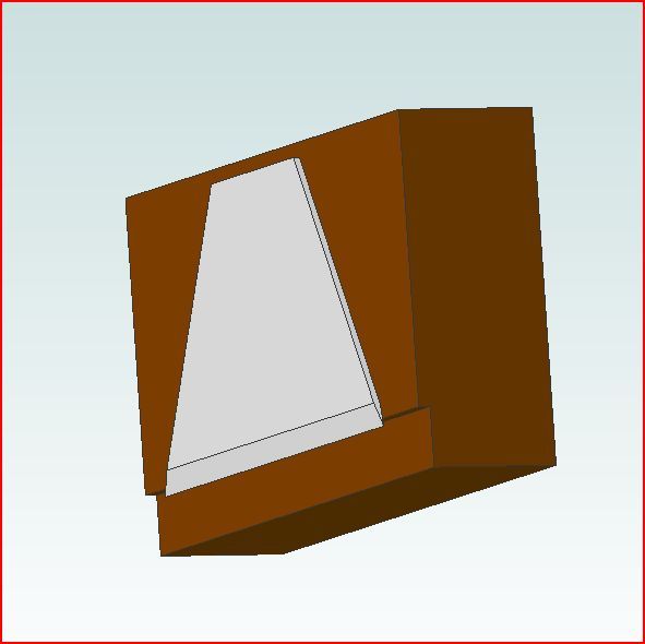

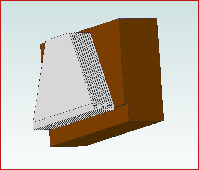

                                        Communicated to me OK
                                        Something like this, alter the rebate to give the length of ring needed then just hold it on the end of the tube as you roll it along the bench
                                        #191310

                                          #191311
                                            No problem, thickness of a stanley blade should be about rightsmiley just gang them up
                                            #191315

                                                Problem with that is if the rings don't part off in order…
