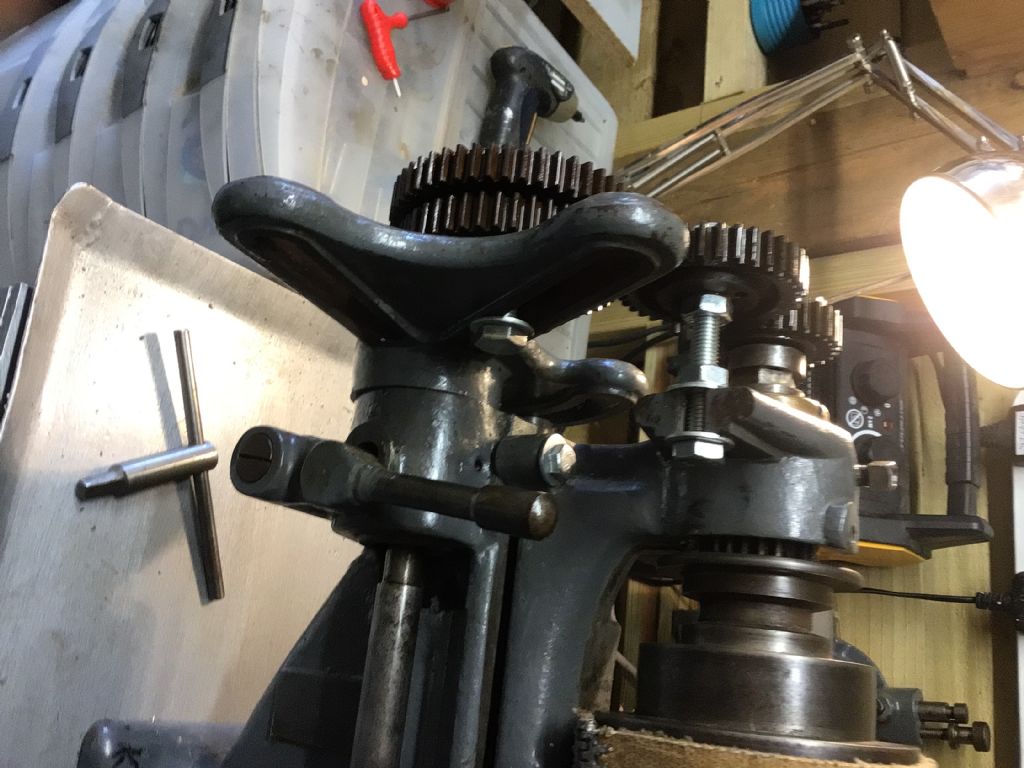

        Hi Haydn, yours does have a fork on the headstock, but it's not on the spindle, it's part of the headstock casting, though it looks as if it has been cut shorter, it's just behind the vertical part of your banjo in your pictures that you got in the wrong order, above my last post.

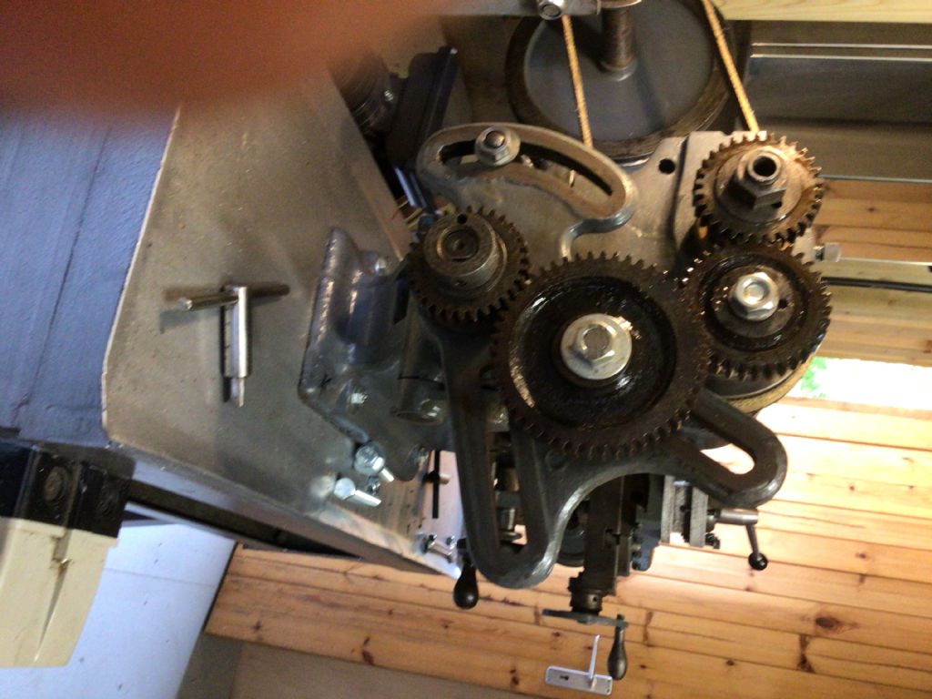

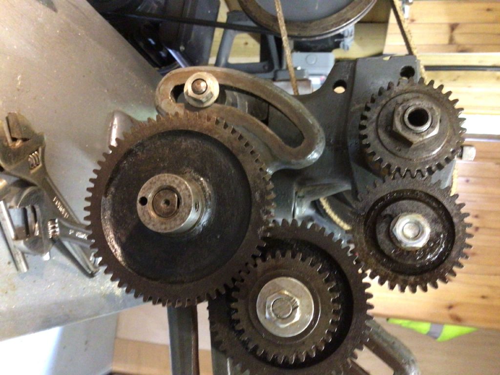

            Well, now got the basket case together and it’s looking o.k. I have cobbled up some spindles for the gears to spin on, no idea what I’m doing regarding ratios ect… the photos show the present result….all I want is the lead screw to transport the saddle at a sensible speed to work with, can’t actually run the lathe yet as I’m waiting for a drive belt which I should have tomorrow. I have a couple of gears left over so I can alter things if required.
            again thanks for all the help from everyone…..

                The gears are not actually turning on those M10 bolts, I made up some steel sleeves for them…should I make replacements up out of a different metal later ? These are mild steel I think.

                  The gears might actually be cast-iron (the texture of the un-machined areas would be a clue), which will run on mild-steel.
                  Otherwise, if they are steel, leaded-bronze but not phosphor-bronze, is probably the best material.

                    All Drummond gears are cast iron which is why some thugs manage to break teeth off. Your set up is right in principle
                    Have you looked at any of the hundreds of pictures on the 'net showing typical set-ups? Normally you use both slots in the banjo so that the gear train is 3 pairs of small driving large gear for max reduction then save the position on the headstock to put in just one idler that reverses the direction when you want the carriage to go left to right rather than the normal right to left.

                      Well, fitted drive belt and the lathe is working pretty much as it should……with the gears as above the saddle wizzes along very fast so I changed the gears as in the photo in this post and it is much better but still much to fast….where do I go from here ? Do I try and source a couple of 20 tooth gears…
                      another problem is when the lead screw is engaged the part the ‘clutch lever’ engages that carries the bottom gear slowly moves out until the lead screw disengages. I have looked for a grub screw or something to lock it in position but nothing seems obvious.

                        The minimum with the standard set of gears would be eg 20 driving 55, 30 driving 60, 30 or 35 driving 65. ie 3 smallest driving 3 largest. However nowadays you may be able to get several 20s perhaps 3D printed.
                        The clutch disengagement is due to wear in the engagement slot which could be filed parallel again but in the interim just hand a few nuts on a loop of string and hang it over the lever in the direction that creates the necessary holding torque.

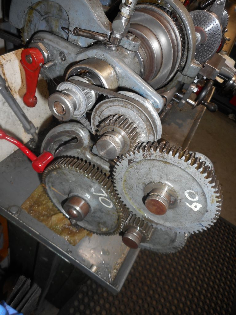

                          The set up on the banjo is on the right track, but one compound stage is missing. The photo provided by Nicholas shows the arrangement:
                          Nicholas' set-up has an extra pair of small/big gears which reduce his overall ratio considerably. Have you another big gear available?

                            Hi Haydn, you need to see if you can get a couple of 20 tooth gears and a 73t one. but even getting one 20t will help.

                                  I added extra fine feed to my Drummond M Type by using cheap as chips toothed belts and toothed pulley off t'internet. XL series belts and pulleys from memory. Much cheaper than gears. I bored them and fitted bronze bushings and made my own spindles etc for them to mount on.
                                  Standard Drummond gear set is 20 to 70 by fives plus a 38 from memory.  But the groups.io Drumondlathe group has the exact listings.
