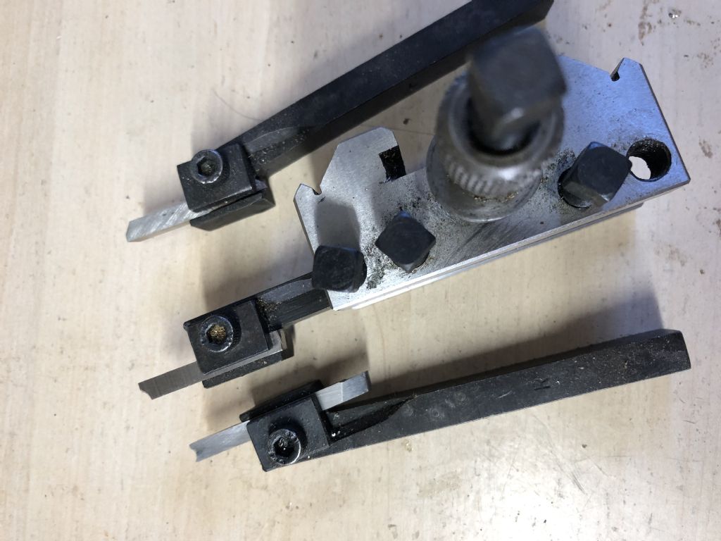

                                    I made left and right handed versions of a tangential tool design by Mike Cox and use them for most of my turning operations. HSS bits and dead easy to grind once you have made the jig to hold them. The flat step on top of the RH tool is at centre height for my machine . Makes setting really easy.
                                        I do a lot of work with just those tools on my 10×22. It will happily make a depth of cut just smaller than the 3mm tool bit, used in a Dixon QCTP. I also use carbide tools(8mm tool holders) and can take at least 4mm DOC in steel without any problems.
