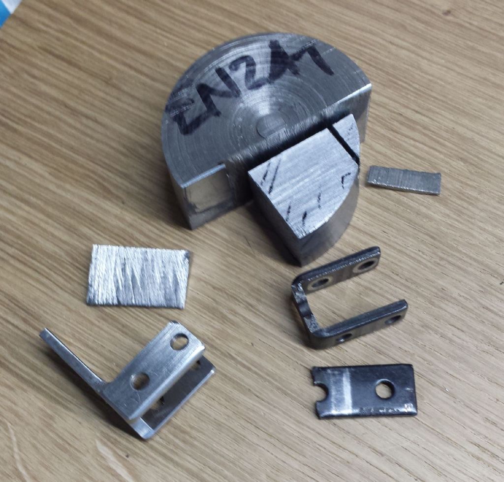

                                          #251784
                                          Ian P
                                            @ianp
                                            Update…
                                            I have made a new lever from solid out of EN24T (it was the only bit of decent steel I had) and having assembled and tested the Jigsaw it works!
                                            I spent less than two hours to hacksaw the rough shape and then mill, drill and ream as required. I thickened up in some places compared to the original and also did not drill a couple of holes as they did not seem to serve any purpose, in fact the original part broke across on of the holes.
                                            This part serves to push the blade forward on the cutting stroke, the so called pendulum action. I assumed that this lever was highly stressed and that was why Bosch had mad it very hard and tough. What I did not think about at the time was how the operating force was applied or transferred to the lever.
                                            On examining the Jigsaw innards when I reassembled it I can see the oscillating arm that presses on the tail of the lever but I now realise that it must apply only a very small force as the witness mark on the lever is no more than a witness, its removed the blacking on the surface at the contact point but there is no detectable wear.. Its the tiny bright spot to the right of the hole (bottom right corner of the picture). The other bright area of the part is where the lever passes through a felt seal out of the gearbox casing.
                                            Thanks for all the useful advice, comments and encouragements. I now have a fully functional machine again. I've not heat treated the part, I'm going to inspect it after a few hours of use but I suspect it will be OK as it is.
                                            Ian P

                                            #251786
                                              Well done, Ian
                                              Hewn from the solid …
                                              It looks much better than the original part.

                                                  #251908
                                                  Ian P
                                                    @ianp
                                                    Bear/Michael
                                                    Thanks for the compliments, it was pretty straightforward to make greatly helped by Bosch keeping to preferred sizes, ie, 4mm holes, 12mm centres, 12mm wide tab, 12mm between forks etc. There was only one dimension not in round numbers which was bottom hole centre 3.5mm from bottom edge.
                                                    Chopped out some disks of 12mm thick Delrin with the repaired jigsaw today, cuts beautifully.
                                                    Ian P
