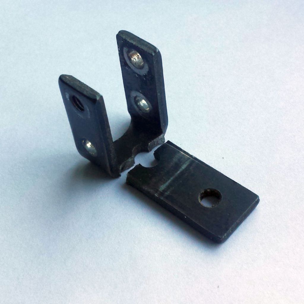

      jigsaw part.jpgThe part in the picture is a pivoted lever that carries the blade guide roller on a Bosch (Scintilla) Jigsaw. I have had numerous attempts to buy the correct spare part but the jigsaw is now 'vintage' and this part is no longer available.
      The material is 2.5mm thick steel that has been hardened and is 12mm wide at the break. A file just skids over the surface and I would describe it as glass hard. I do not have heat treatment kit or the experience/confidence to go to the trouble of copying the part and then risk breaking it the first time I use the jigsaw!
      I hate throwing things away especially a quality tool and without doubt is the best tool purchase I have ever made. Bought over 40 years ago as it had the then fairly innovative, 'pendulum' action, it has renovated five houses and cut everything from 6mm steel plate to tree roots. It has had one set of brushes and the only other repair is to shorten the mains lead when it fatigues at the cable entry.
      If I was going to make one I think I would mill it from the solid (EN24?) but I would still have the hardening problem.
      What would you do?

          I'd try and find a piece of A2 air hardening tool steel to make a new one. Get it from a metal supplier and ask for certs for your piece of A2. Make smooth radii and fillets at all changes of section, smooth finish (unlike your mass production Bosch stamped part with rough punched holes and huge bend tool marks). Google heat treat for your brand of A2 (very simple propane torch heat to red heat / air cool / repeat / air cool temper usually in A2, for this size of part) and follow to the letter. No water or oil quench needed. Result will be very strong very hard new part. JD

              Bronze braze? Have someone TIG weld it? You might be able to bend a new one up from sheet. It depends how much more work you anticipate doing with the tool.

                A2 will likely be available at toolmaking suppliers or metal supermarket if there is one near you.
                It will likely be at suppliers in bar form rather than sheet. I visualized making it out of a block rather than bending up a sheet.
                Bosch likely made the original out of austempered AISI 1060 or 1080 steel, bent in the soft state then austempered. I designed and made many parts like it for the valve industry and for office equipment parts. Austempering requires a good proper heat treat chain belt furnace and careful heat and time controls, not simple in home shops but widely available at commercial spring makers and 4 slide shops.
                Bending heavy sheet to tight shapes as part in your photos usually requires some bend/form tooling and significant press tonnage. If A2 could be found in sheet form it will require much more tonnage to bend than 1060 or 1080 in soft state. Can be done of course but likely much easier to carve your item from solid A2 and air harden. No bend/form tooling, no tonnage required, and heat treat usually dead simple. JD

                      I'd a think about why the piece is hardened. It could be that the design calls for a hardened steel pivot to rotate in a hardened hole. It would then seem to be unlikely that the whole piece needs to be hardened but that was the most efficient production option. An alternative would be to make the piece from an un-hardened steel and insert bronze bushes for the pivot holes.

                          I disagree that the part was too hard when it was manufactured. It has survived millions of operating cycles over 40 years without failing. Because its tough (read hard and rigid) it would not have flexed very much, but millions of 'not very much' have eventually culminated in its fatigue.

                            Looks like a simple blacksmithing job to me. I would think any half-decent agricultural engineer could soon make up a replacement, properly hardened . . . if they can't repair the original. If it's done 40 years it can't have been all that badly made!
                            If it was mine, I'd try cutting and hot bending one from any old bit of steel plate. It might not last another 40 years but I might not care by then.

                                  Not sure why it would need to be through hardened? I'd make it from low carbon sheet steel by cutting, drilling and folding. In a perfect world I'd case harden it.

                                        Take a sheet of paper and wrap it around the two 'flaps'…mark outline and holes with fine pen being sure to prevent any slipage……..mark in the broken base parts as one outline (obviously) Transfer the 'drawing' to guage plate and mark out carefully using carbon paper or similar…or transfer to thin card and cut out an accurate template then draw around onto guage plate. Cut pieces or scrap sheet for 'sandwich' exactly 12mm thick and set aside. Drill and clean all holes THEN cut out part from guage plate. Heat with blow torch/bricks until bright red…..place against scrap sandwich, fit in vice and fold ONE of the flaps up only. Take second heat and place scrap against bottom of part,…fit into vice and fold other flap down…..
                                        ………Check of fit and accuracy on jigsaw.
                                        Heat to red heat and drop into one pint engine oil (preferably non synthetic)……..remove part and clean with wire wool,………place on piece of sheet steel and heat from underneath the sheet with blow torch (or over forge) ….keep the part moving with pliers until it is uniformly 'straw' colour………drop back in oil…….clean and fit.

                                          The only thing I would add to Bob's suggestion is that I'd drill the holes after bending (but before hardening) to be sure they align perfectly. I've seldom managed to bend anything accurately enough to ensure precise alignment of holes that were pre-drilled like that. I know my limitations wink

                                              I'd just make one up out of flat steel plate, or even flat bar bent and welded. It just holds the guide roller so no need to be hardened. Mild steel will probably last well enough for home hobby use. Or pick up another jig saw at a boot sale for $5.

                                                The part shown holds the wheel that forces the blade forwards on each stroke to improve the cutting action. It is subjected to repeated quite high speed cycling alternating load stresses. Maybe you can beef up the thickness of the section near the existing break without interfering with the operation of the tool if you are machining a new one from the solid.
