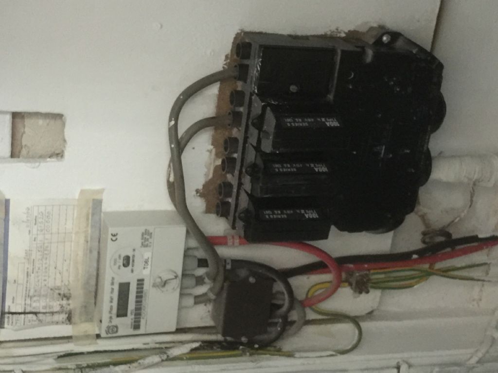

      My daughter and her husband recently bought a new house to them a pretty ordinary 1930's 3 bed detached in a suburb of Sheffield
      I was amazed to see that they had 3 phase to the meter area and yes they are liveimg_0989.jpg
      How many others have 3 phase at home?

          Ian, not so unusual as the supply companies used to install 3 phase supplies to properties with off peak heating loads that could not be supplied by a single phase 60A supply, not so common these days with less people using such systems.

            I did wonder if that's what it may be for but there's 3 100 amps here.

                                  Almost certainly the presence of a 3-phase incomer indicates that the house used to have electric heating. There's not much else that would require such a large power capability, short of an industrial annexe.
                                  My parents' house in Harrogate had 3-phase when we acquired it in the mid seventies when it was about 10 years old. There was underfloor electric heating in all rooms (it's a large bungalow) and 3 meters in the garage. Resistance wires were simply run in steel conduits in a concrete slab sitting on polystyrene insulation. Obviously we ripped all of this out and replaced it with GCH. The 2 additional meters were removed not long afterwards.
                                  I expect you pay extra for the additional 3 phases, both installation of the meters and their rental, so even though the connections are there, making use of them might be a bit extravagant for hobby use.
