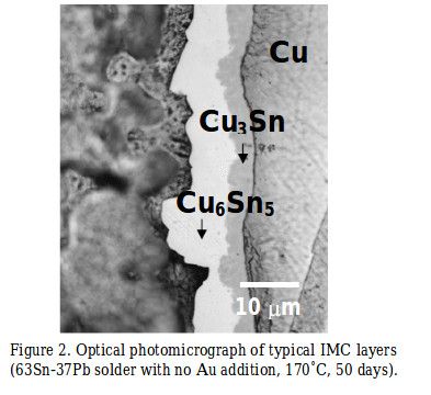

                            I think the way solder works is probably fairly well understood, at least within the framework of physics / chemistry as we know it – a cursory search revealed this interesting photomicrograph*:
                            I'm sure there is much more info available on t'internet if one were to search more diligently.

                            *Evaluation of the Effects of Au Content on Intermetallic Compound Layer Growth
                            in Pb-Sn and Sn-Ag-Cu Solder Joints
                            D.F. Susan, P.T. Vianco, J.A. Rejent, J.J. Martin, and P.F. Hlava
                            Sandia National Laboratories, Albuquerque, NM USA Proceedings of the 3 International Brazing and Soldering Conference, April 24–26, 2006, Crowne Plaza Riverwalk Hotel, San Antonio, Texas, USA

                                Disagree slightly in that although I agree the Chemistry is well understood, the Physics is surely still mysterious. At least if you dig deep enough.
                                The photo is interesting for another reason. It appears to suggest that the bond is made only by alloys of Copper and Tin created when the solder is melted. (ie Bronzes.) In the picture Lead doesn't appear to play any part in the sticky part of soldering. Presumably Lead is mainly a component of solder to reduce the melting point of tin and then to allow it to flow into contact with the copper. Lead doesn't add strength. The implication is that wide gaps filled with solder will make much weaker joints than those where the soldered items are close together.   (You all knew that anyway!)
                                As lead is a poor conductor of electricity I've often worried about soldered joints in electronics. Solder seems a poor way of making electrical connections especially at RF – why aren't joints high-resistance due to the poor electrical qualities of the solder? Lead is 20 times less conductive than Copper and Tin not much better – about 10 times inferior. Having seen Robin's photo, I now think the electrical bond is a thin layer of Bronze formed between copper conductors. Bronze is a better conductor than solder. The lead blob usefully surrounds the actual electrical joint and protects it from oxidation. However, as Bronze is only twice as conductive as Tin, that explains why solder guidelines emphasise the need for electrical connections to be mechanically sound, ie in good contact, before soldering.

                                  What a marvelous response from Robin.Brilliant!A terrific picture that shows what happens and illustrates just why thin solder and brazed joints are stronger. Thanks for your contribution to the campaign.
