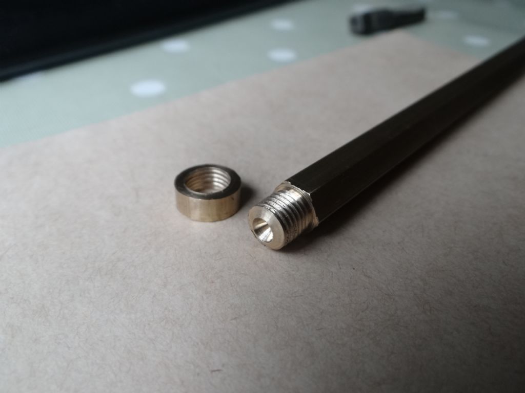

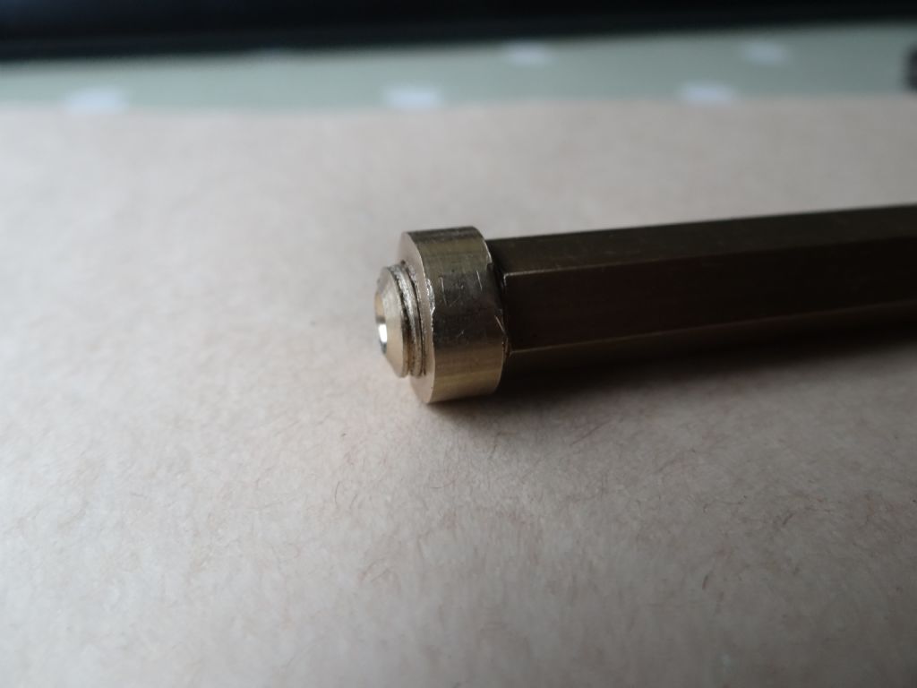

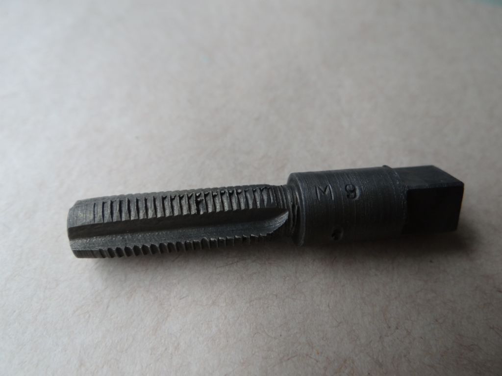

        Interesting comments on Quick Change Toolposts; perhaps I'll hold off on that one. It may depend on what you're doing on the lathe. Now I'm tackling more complex objects, I notice that I often spend ages setting up and only a few seconds actually cutting.
        Anyway, I'm pleased to report that a version of the home-made tap with the slot cut for a right hand thread plus other improvements works rather well, despite obvious imperfections.
        As can be seen I still have a problem with burring. Although I'm going to try and sort it out myself, don't be surprised if I ask for help again.
        The home-made die cuts an M9 internal that fits a lathe-cut M9 external thread. There's something very pleasurable about making parts that fit together. Also, I have a real job needing a replacement brass fitting where my new ability to cut an unusual thread may save the day.
        Very many thanks for the advice and pointers – I've learned far more from this thread than I had any right to expect.

          looks like a proper job Dave, did you try the heating trick?

                I half-tried the heating trick, and mixed your advice with Andrew's. I kept the silver-steel red-hot for longer, just over 15 minutes, before plunging it into salt water. I stirred vigorously rather than letting steam slow the process down because I was trying for maximum hardness rather than toughness. I don't have a proper set of files to test hardness like Andrew, but the second tap I made is harder than the first.
                More experiments with different heat treatments when I make more taps. I've ordered a ball-mill, which should produce a deeper groove with a cutting edge more like a real tap. Although I'm pleased with what I've done I'm also sure I can do better.

                      When making tools I normally temper after hardening. I aim for the hardening process to produce a part that is as hard as possible. Then I can temper it according to use. I normally leave the tool at tempering temperature for about an hour per inch of thickness as for hardening. That gives time for the atoms to pack the suitcase and say their goodbyes before moving around the lattice.

                        EGA, most of the hss I use is very small. I give it a good dose of heat with the carbon flame until bright yellow or white and hold it there for a minute or two, then plunge into brine.
                        To temper I dip it in the pot of molten lead (which is usually on the go for the leaded lights) and let it air cool.
