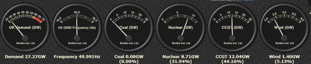

                      The problem with wind and solar is the storage issue and having back up generation when there is no wind or sun light. Nuclear is very good for covering the base load as nuclear works best under constant load. I often wonder how green all the renewables actually are when you take the carbon foot print of manufacture/infrastructure into account.
                      UK power usage today and nuclear just sitting at the same load day to day and the only time it changes is if they are doing maintenance.
