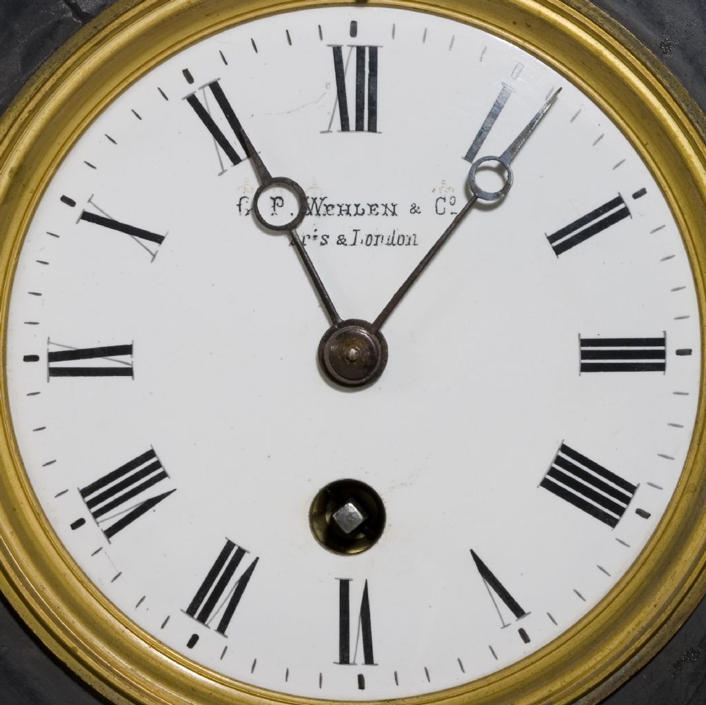

        Like a clock pendulum, the dialogue has swung back and forth.
        With little to add other than my appreciation for all the interest and direction, I decided to move on to (SOD) Dave’s comments about the method used to apply the Roman (Latin?) numerals. There was a possibility too that the outcome may prove useful to modellers who are keen to embellish their work with a high level of realism.
        Here's my latest clock face …

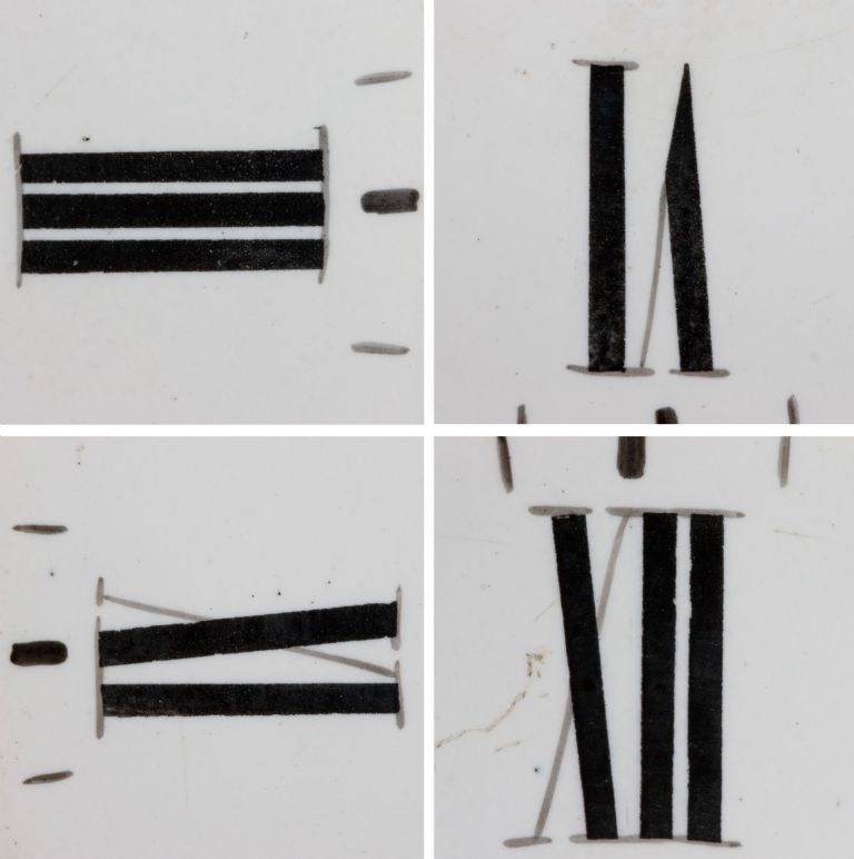

        And a composite of four numerals …
        Here are some extra details …
        Detectable by touch and from my earlier (flash illuminated) picture, the characters appear to have been painted. For scaling purposes, the numerals are 7/16" (11mm) in height.
        1. The black lines vary in width.
        2. Spacing’s between some black lines vary.
        3. The pointed ends of the V’s come close to a sharp point.
        4. The ends of black lines (X’s in particular) are at an angle, not perpendicular.
        5. The edges of some black lines are irregular.
        6. There is no real evidence of rubber stamp usage.
        7. The thin faint strokes around the face have the appearance of brush strokes.
        What method(s) did they use?

          I know that modern watch faces are often Pad printed. (As well as billions of bottles and the like) It works well on curved surfaces.
          I also read somewhere that this process goes back 100 years?
          I wonder if the raised text might have been done by this process or a similar process.

              I have failed to find a decent illustration, Sam … but my understanding is that they used a rotating table with various angular divisions, and a linear guide-bar to steady the hand [and to facilitate drawing circles].
              … Think of some hybrid between an Animator's desk and a Sign-Writer's Mahl Stick.
              … or, indeed, a Rotary Table on your Milling Machine.
              Then it's 'just' a matter of using pens & brushes, with nerves of steel. surprise

                              I'm interested that the inner set of serifs for the numerals is curved, but the outer one is straight. This isn't an easy effect to achieve if using a built in font to generate them on a computer, although you can obviously draw the symbols from scratch like this.
                              Is this normal practice?
                              #424017
                                Posted by Neil Wyatt on 13/08/2019 20:44:33:
                                'though not quite consistently
                                Have a look at theVI for example
                                I wonder: … is the variation by accident, or design ?
                                #424046
                                Nick Clarke 3
                                  @nickclarke3
                                  Or might that be an effect of the dial face being domed and not flat, or painted that way because the dial is in fact domed?

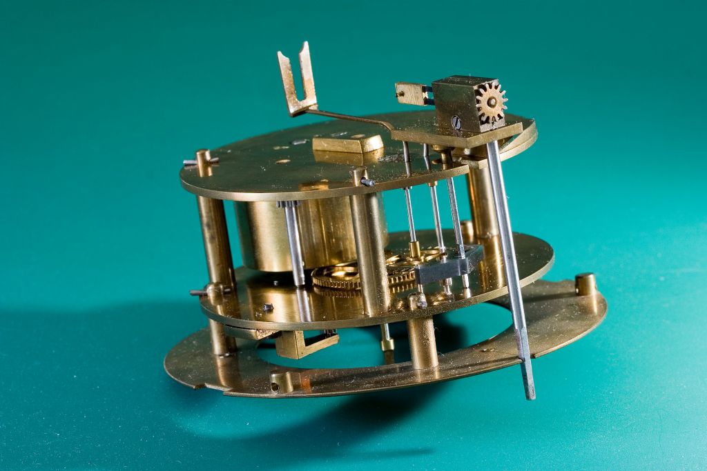

                                                  It had been suggested elsewhere that I investigate the clock for any other marks on the movement that could indicate who made the clock. While this is potentially heading away from identifying the ‘strange’ hieroglyphs, it opened another aspect – the dial itself.
                                                  What I was very reluctant to do was pull the clock apart and remove the dial. I ain't as steady as I used to be.
                                                  However, it turned out to be an opportunity to add a very tiny drop of clock oil to those pivots I chose to leave on a previous occasion. There was also a slight issue that the escapement wouldn’t work with the mechanism (and therefore the dial) truly vertical. Twisted a few degrees ACW and it would tick merrily. Otherwise, it would stop. The fault lay with either the crutch (and/or the fork) being out of line with the pendulum, see here …
                                                  **LINK**
                                                  and here …
                                                  With the mechanism back in place, judicious bending of the crutch arm restored most of the misalignment.

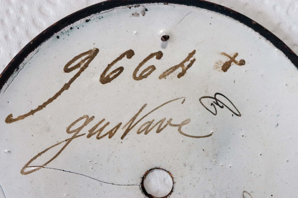

                                                  As for the dial itself, I found evidence of traditional enamelled copper methods used during its construction. A very shallow copper ‘dish’ retains the glazing powder during firing, similar to that seen in this video …
                                                  **LINK**
                                                  … and (presumably) provides better control of glaze thickness, especially at the edges.
                                                  On the back was the number 9664. It’s the same number stamped on the back plate of the mechanism. Perhaps of greater interest was to find Gustave written on the back. Was it his writing or simply a means of identifying that the dial was for him?
                                                  Several possibilities come to mind. What do you think?
                                                  Sam

                                                    Thanks for the 'reveal' Sam … yes
                                                    It seems we can treat the 'painted dial' trade an interesting diversion.
                                                    … I, for one, have been barking up the wrong tree.

                                                      Sam The crutch arm should not have needed bending the collet should move on the arbor but if it works leave it
