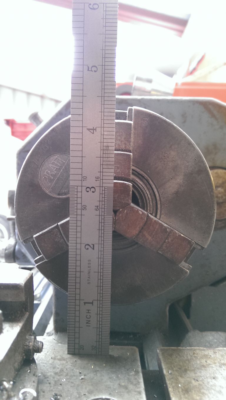

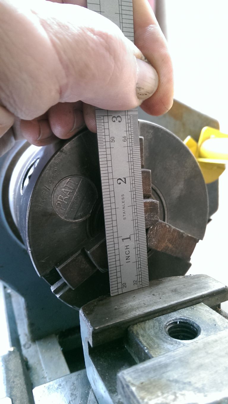

                  Hi Nigel. My AUD is fitted with a slotted cross slide and it is 1" thick. I have 3-5/8" from bottom of cross slide to the centre of the chuck & 1" clearance from the top of the compound to centre of chuck. I have always used 1/2" tool bits on all 3 of my previous Boxford's. Never had any problem with them.

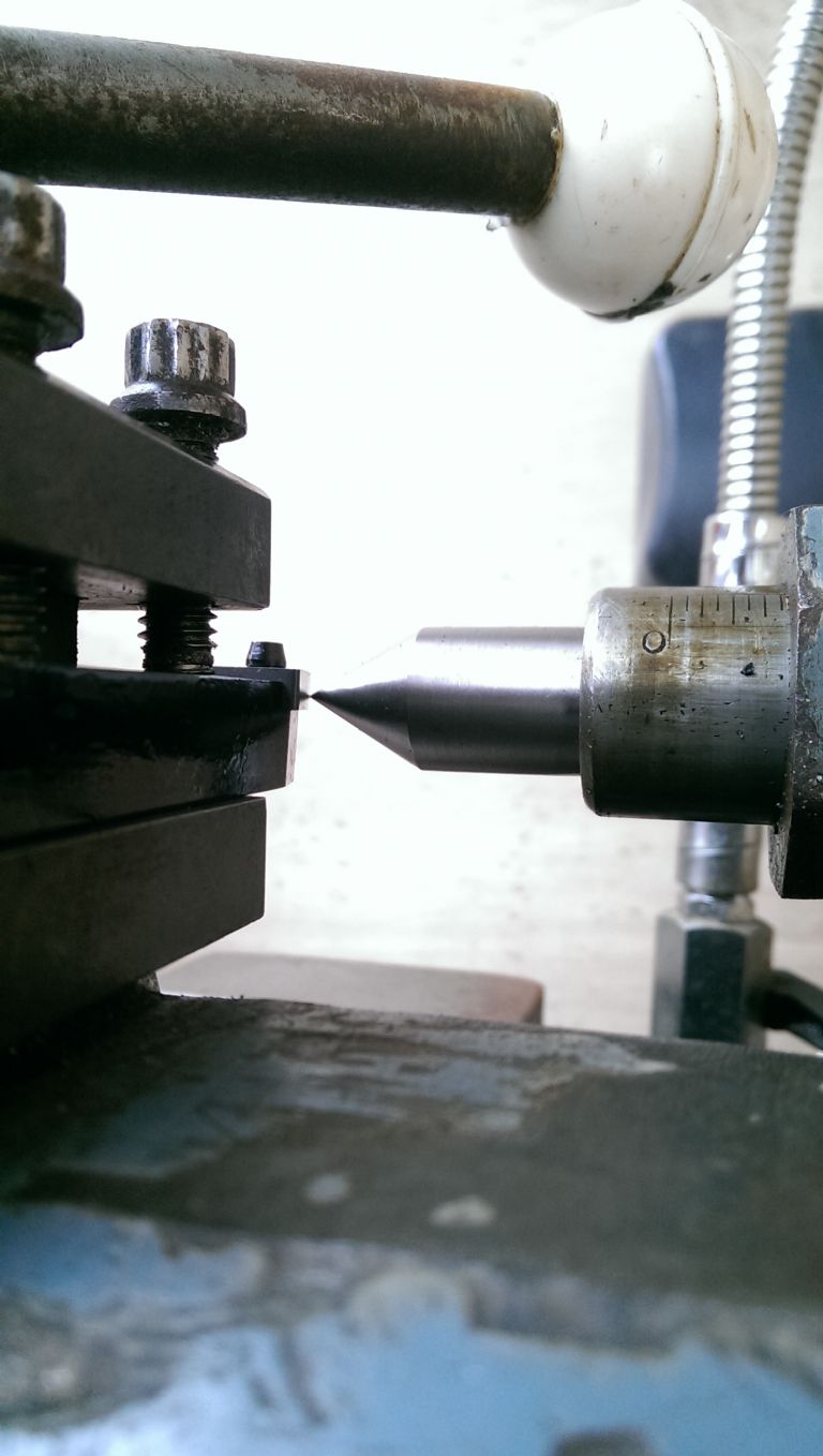

                      Pics of the measurements and tool height at the tailstock center.
                      Compound slide to chuck center
                      Cross slide to chuck center

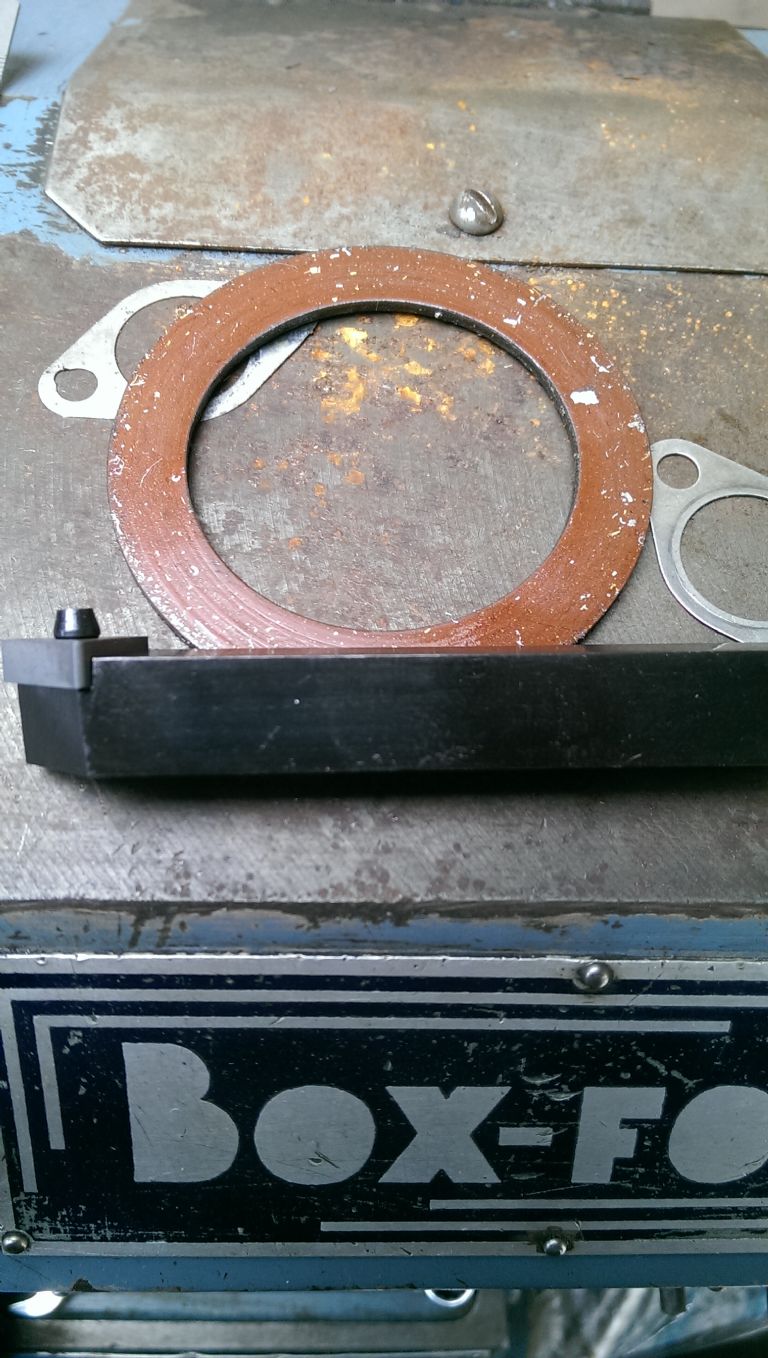

                      Pic of lathe tool 1/2" shank, plus the amount of tip above the tool body.

                        I have many indexable tool holders but none of them have tips that are taller than the body. Its usual for them to be flush with the top. Has someone put the wrong tip on the tool holder.? How much is your tip above centre?

                          The tools are new, just delivered from Proops, but now you mention it I seem to remember my old stuff with indexable tips being level with the top of the tool shank.
                          The tool tip is approx. 1.7mm over center,but that is since I removed the fibre washer from under the tool post, with the fibre washer ( behind the tool in the last pic ) replaced the tip is 3.5mm over center height.
                          If the top of the tip were level with the tool shank they would be perfect, pic to follow.

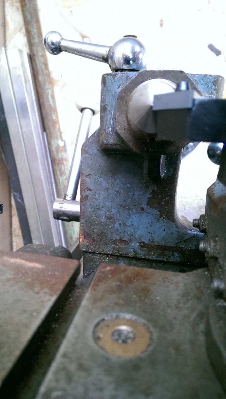

                            Two different views
                            Please excuse the dirt & swarf I'm still cleaning down since its arrival
