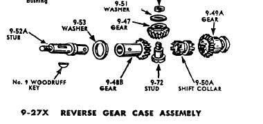

      Does any one have any gears from Atlas/Halifax 10" fwd/rev selector (see bellow) I am on home run now with just feed ass'y rebuild to do and the gears are quite chewed up. I have contacted Mike Kurn but as second avenue I am wondering is anyone has any parts they don't need I have got some parts which I can rework to repair others but not enough to repair all the gears. If any on can help please PM details.
      On another train of thought any ideas what I could do to get rid of this unit by replacing with something to do same job or some other easy to get gears made of better (stronger) material.
      Thanks

        Parts I’m in need of

          Hi Ian
          Did a quick look at
          http://www.lathes.co.uk/atlas/page9.html
          I guess that you want to restore to the original specs.
          Then ignore my ramblings below
          What if the reversing gearbox was replaced with an extension on the lead screw and an extra gear fitted on the gear quadrant when the lead screw was needed in reverse.

            Hi Eric I'm not to concerned with keeping it original for this feed system as I can see from the state of my parts and prices on eBay that they quite prone to damage. One idea I had but how practical was to purchase some similar gears but made in some decent stuff and mod them to fit also not 100% sure what you mean when it comes to reversing!

              With regards to your replacing the reverse gearbox with something else. If you are going to be doing any metric threading at all, the one you have at the moment just can't be beaten, in fact, and I know it shouldn't be done, I always switched into reverse while still powered up and running, and no harm came to any of the gears, but I did do the mod to support the gear/bearing at the saddle end of the box, which cures all the misalignment problems when changing gear.
              Hi John
              Did notice your reversing box was nice and shiny. I'm considering following your mods to this feed if I can get enough bits to repair the damaged gears also pondering if there is any way fitting some form of clutch to further protect this set of gears. I have also seen some info on someone driving the feed screw using a stepper motor but the cost could and (most likely will) be more expensive than the parts to make the original work but might be nice. Just don't want to invest loads cash on feed gear then wish I had done something different.

                I have a new ordered a new 9-47 but made from Aluminium bar and the same 9-47 bevel but made from Zamak, Which would be the strongest? Also one of them I am considering modifying so with that in mind which would machine safest without suffering damage?.
                It will be mating with Zamak gears?

                  I have a Myford Speed 10 and a sweet little Atlas 618. The gear train on the 618 is a little noisy, but when the gears are disengaged, the lathe makes less noise than a sewing machine.
                  Information from page 26 of "The Atlas Lathe Manual" for your consideration. This should answer your question.
                  "Zamak Parts: Zamak is an alloy composed of aluminum, magnesium, copper and zinc. It has a tensile strength of 47,300 pounds per square inch, which is over three times that of cast iron. Its impact strength is nearly six times that of cast iron. Exhaustive laboratory research and the practical experience of Atlas Lathe owners have proved the superior wearing qualities of Zamak."
