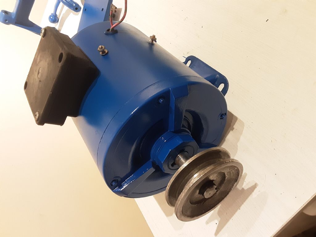

                                #535451
                                Mark H
                                  @markh20821
                                  Hopefully a pic of the motor…

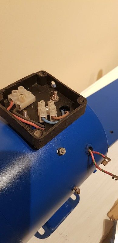

                                  Mark H
                                    @markh20821
                                    The red and black wires were connected to the mains plug, the blue/brown wasn't connected at all
                                    Edited By Mark H on 22/03/2021 19:49:05
                                    #535466
                                    noel shelley
                                      @noelshelley55608
                                      black and red are the correct colours for the run windings ! Blue and yellow were the normal colours for the start. In your case blue and brown. One has to assume that there is internal wiring for the centrifugal switch ! Therefore capacitor to the two spade connectors on the side – do you have the proper cover for the capacitor as the terminals will be at mains potential 240Volt. Live and neutral to red / black and blue / brown. If the direction of rotation is wrong then swap blue and brown. Good luck, Noel

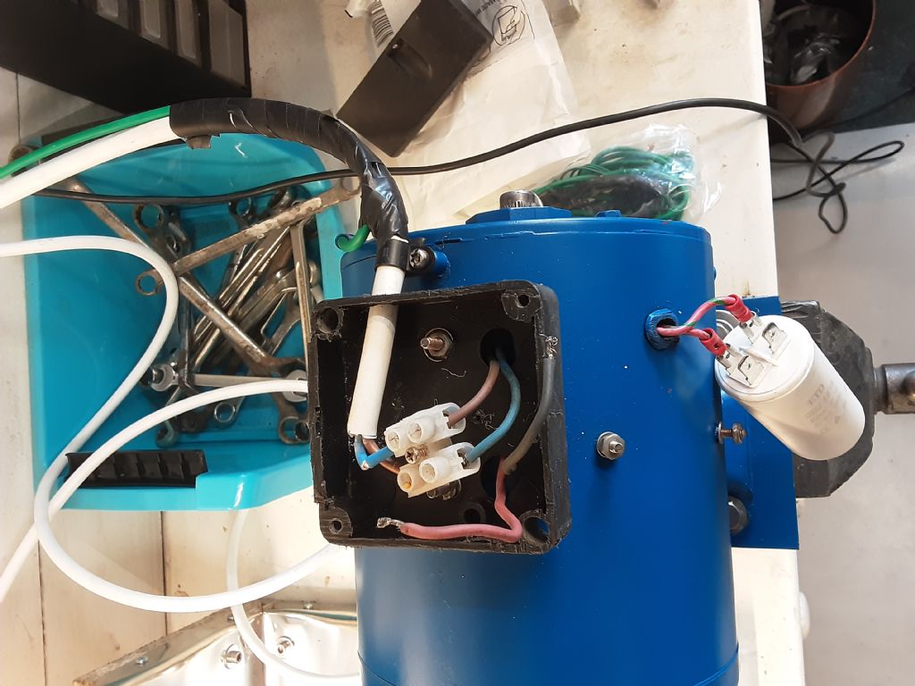

                                        Mark H
                                          @markh20821
                                          Well, this is confusing me, red/black connected, motor runs but anti clock, needs to be clockwise.
                                          Brown/blue, I can connect to br/red and blue/black and runs anti, if I swop them, the rd trips..
                                          If I just use red/black but swop them, motor runs anti, I can connect blue/Brown to mains and still runs anti.
                                          Without cap I can get it to run clock if I spin the pulley, with cap connected..anti
                                          No wire combo with cap fitted seems to get the motor to run clock only anti..
                                          Wonder if something is knackered in the motor ??

                                              Dave Halford
                                                @davehalford22513
                                                I suspect it may be only running on the start coil only with one of your swaps.
                                                Search on cap start and induction run motors, you will get wiring diagrams
                                                It should reverse if you swap the connections of the capacitor where it meets the run coil and the start coil where it meets the run coil.
                                                Measure the resistance across both motor bn to bl and also r to bk, the lowest resistance is the start coil if you disconnect the cap that one should go high resistance.
                                                You will need to take the back plate off the motor, where you should find the centrifugal switch. Leave the switch wiring alone but look at the cap wire colours and see what it changes to, one leg will go to the switch on the end plate ignore that one.
