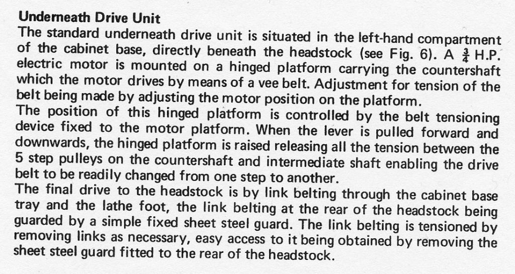

                          Hi, there seems to be two versions of securing the intermediate pulley shaft, for the underdrive lathes, the older one being with bearings on a pair of hangers and the later one which is fixed into the sides of the cabinet. Mine is the later version and the intermediate pullies rotate with bearings on the shaft and this shaft has no adjustment of any sort.
                          I assume the hangers on the older version have slots in them for the bearing bolts, however I guess these slots are not very long and are provided for initial adjustment at the factory build, as according to the "Know Your Lathe" manual, the instructions for tensioning the link belt is to remove links as necessary.
                          Regards Nick.

                              Hi Ian, most Boxford lathes were supplied with 3 phase motors, if your motor is a single phase 0.5 HP it may not be powerful enough for some operations. Tony on the Lathes website suggests that at least a 1 HP should used for single phase, which is what I have on mine and I have not had any issues with the lathe being underpowered or the motor getting overheated when being used all day.
                              Regards Nick.
