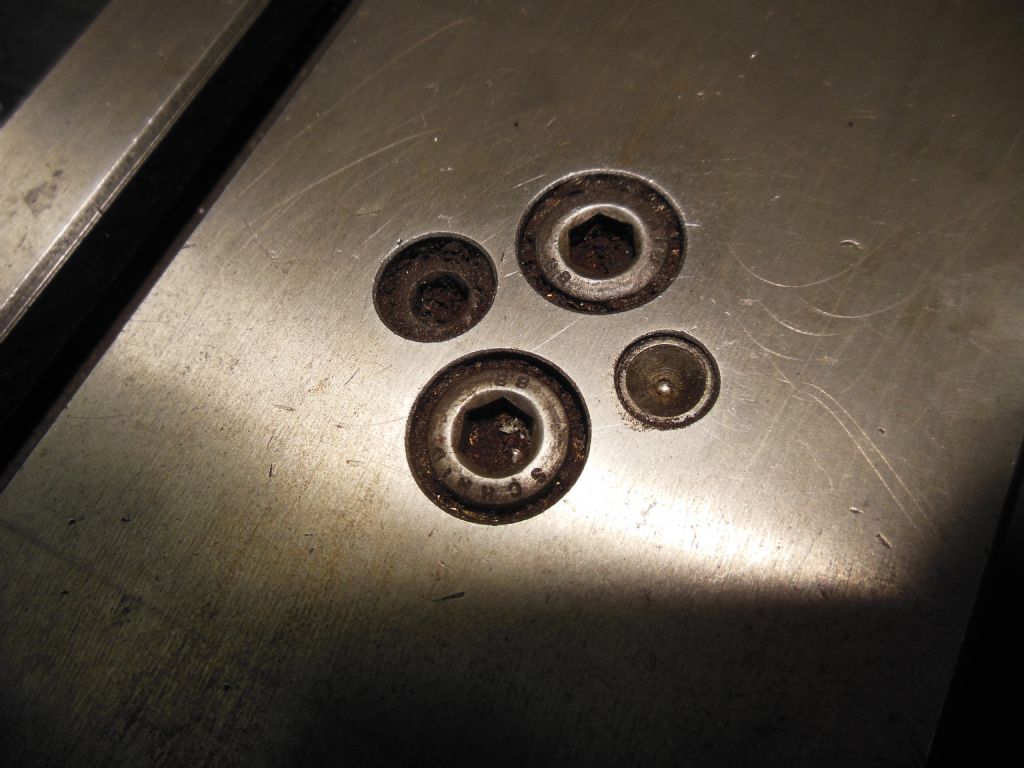

      My lathe has a number of these oil or grease points and I'm struggling to use them. They look (and probably are) simple enough but even though I have a grease gun with an end that appears to fit into the cup all that happens is the grease pressure pushes the gun away with none going into the machine. If they are intended just for oil rather than grease is there a oil gun with an appropriate end easily available?
      Expert opinion sought! The cup is 8mm diameter and I expect someone will immediately say " oh that is an XXX and very common" !

        #194438
        Nick_G
          @nick_g
          Here is the new friend you seek. smiley

          #194439
          MichaelR
            @michaelr
            As Nick has shown that's what's needed, just push the ball down with the oil can spout nozzle and squirt away.

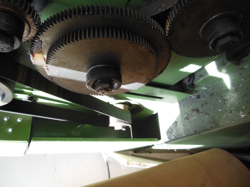

              Perhaps I should have explained myself more clearly. The oiler on the slide isn't my problem but was easier to take a picture of (and I had worked out how to hold the ball down and oil with a can though that is a very slow method)
              What I cannot do is oil the inaccessible ones especially like in this picture (in the centre of the shaft if not clear).
              Being horizontal holding the ball down and squirting it tends to just drip down so are there any oil guns that can both depress the ball and squirt with a bit of pressure?
              I suppose I can hold down with a small pointed item and use a can of WD40 or similar but I hoped there might be a proper solution.dscn2626.jpg

              #194452
              Brian Wood
                @brianwood45127
                Hello David,
                A little tip to prevent sideways leakage, pump the oil through a piece of thin rag pushed into tight contact between the gun nipple and oiler, it stops a lot of mess. Don't use grease, these are oilers.

                    #194486
                    davidsuffolk
                      @davidsuffolk
                      Guess Austrian springs are stronger than Chinese ones! I have a rigid spout oil can (and now a very sore thumb) but "some" oil has gone in I think (though I got a lot of spurting out the side).
                      Because I had failed before I presumed there had to be a special tip for an oil gun but from what has been said it seems pure brute force works well.

                        duncan webster 1
                          @duncanwebster1
                          The one on the changewheel stud (and lots of other places, look like grease nipples) is meant to be attacked with the infamous Myford oil gun. A lot like a grease gun but squirts oil. I've got a good one made by Wanner, but there are lots of bad ones around

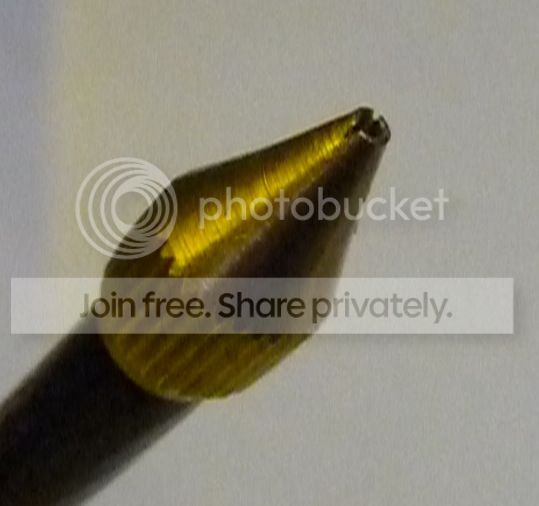

                                  #194559
                                  Hopper
                                    @hopper
                                    ISTR one of the books by GHT or LH Sparey etc suggesting taking a mini-hacksaw and putting a small cut across the end of the pointed oil can nozzle. The pointed nozzle pushes the ball inwards and oil is able to come out the two slots formed by the hacksaw cut.
