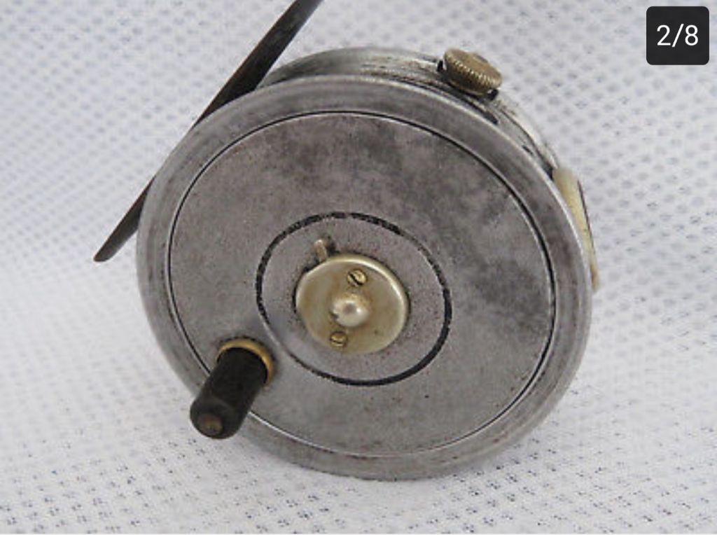

      Hello,
      My name is Boris. I'm from Sydney Australia and enjoy using my lathe to repair antique English fly reels.
      I'm trying to find some brass machine screws for a reel. As far as I can tell the screws are BSW fine 48tpi with a major diameter of 7/64"
      I'm also interested where I can find a die and tap in this size.
      If anyone knows where and how I can get the screws and tools I'd be appreciative.

                                  #469319
                                  Boris Gaspar
                                    @borisgaspar86293
                                    Thanks Mike & Jason B
                                    Ok this is reel to be repaired
                                    Pre war Young Reel

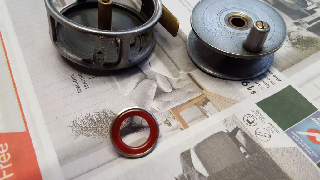

                                          #469343
                                          Boris Gaspar
                                            @borisgaspar86293

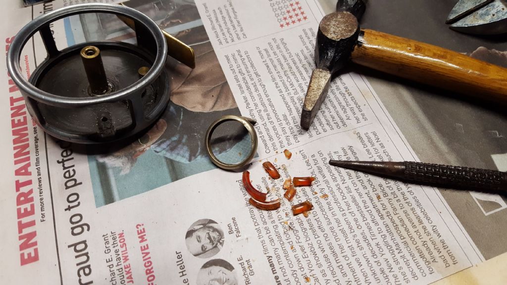

                                            Just for a bit diversional therapy here's another JW Young reel with a broken agate I repaired.

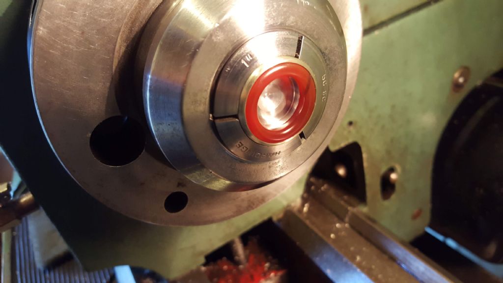

                                            It was badly cracked and sharp enough to damage my fly line so I replaced it. Here is the nickel silver bezel in the collet cleaned up with a new agate set into the bezel.
                                            Here it is ready to be fitted

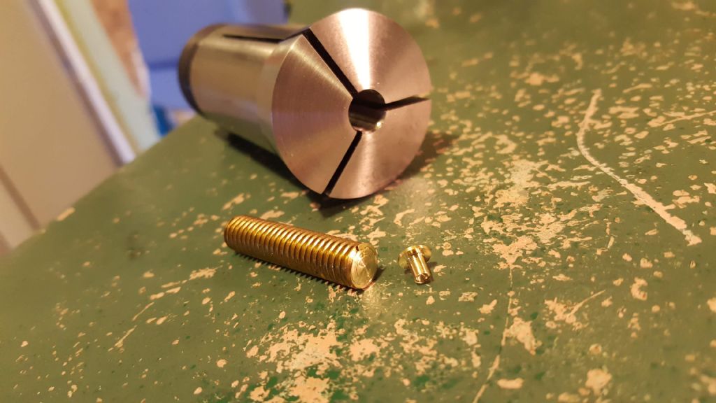

                                            Brass rivet turned

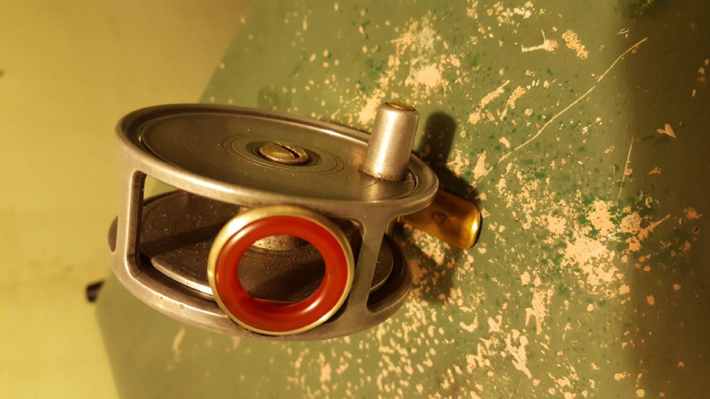

                                            Finally fitted ready to take a line. It'd be just fine on one of my 3 wt bamboo rods.
                                            Here's one of my 3wt rods for very small delicate streams and trout.
                                            Now it's my turn to browse some of the work you blokes have done as my diversional therapy.
                                            Edited By Boris Gaspar on 05/05/2020 13:06:54
