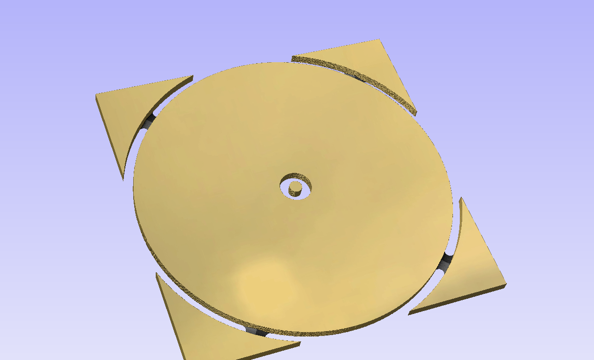

                          John Stevenson 1
                            @johnstevenson1
                            OK 100mm washer, zero at 0,0, cutter is 3mm 2 flute, 3 flute or centrecutting 4 flute.
                            With 4 tabs to hold the washer in, clamps on the unwanted corners.
                            Code here.
                            #265346
                            john dakin
                              @johndakin59277
                              Ha, thanks so much that's exactly what I needed, I had a jig that held a 100 x 100mm square plate and the part was then cut out, the centre hole first, then another jig was placed on the machine bed with a raised stub that the centre hole would locate onto, the stub was threaded and the part was bolted to that, your idea is much quicker and easier, thanks so much for your time and advice on this it's been a great help
