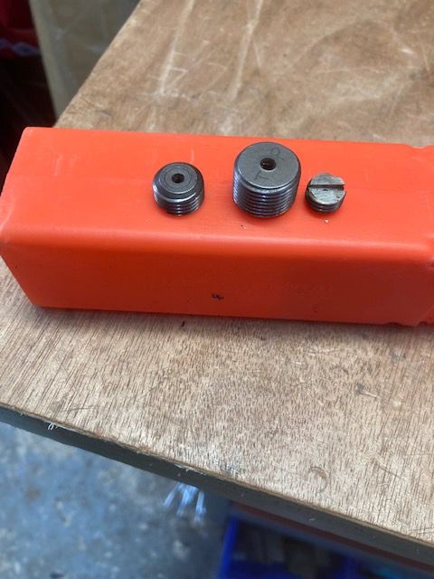

                      #617135
                      Tony Pratt 1
                        @tonypratt1
                        This post reminded me of long forgotten Clarkson collet adaptors I made back in the 70's when threaded cutters were king. Basically just old cutter shanks cut off & slotted to take a screw driver, we would screw them into the correct collet and now plain shanked tooling could be held securely.img_1290.jpg
