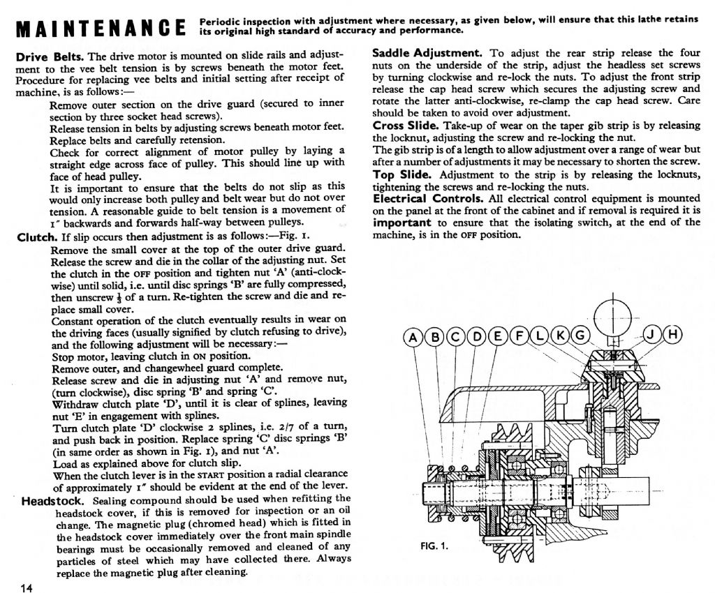

        Hello, I'm having a problem with the clutch on my Harrison L5. I've noticed when I disengage it by moving the lever to the left, occasionally the chuck will take an extra second or two to stop rotating. Tonight however the clutch seems to have stuck on permanently – even with the clutch lever fully in the left position, the chuck is still spinning full speed.
        I'm thinking I need to reduce the tension on the clutch spring, but I've read my lathe has a brake which should stop the chuck pretty quickly so maybe it's the brake that needs adjusting?

            IIRC from my days as an apprentice, the Harrison clutch/brake lever should have a neutral position between the clutch engagement (lever to the right) and brake(lever pushed hard to the left).
            If the clutch does not disengage before being pushed hard to the left, then it needs adjustment, or is seized. Otherwise this could burn out the clutch discs and/or the brake.
            I remember that the clutch adjustment was not a particularly difficult procedure, but the details escape me after nearly 40 years!
            Andrew.

              This may help – or may not! Only mentions clutch slip.
