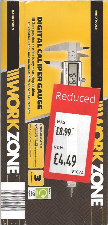

                                                  #147077
                                                    Posted by Les Jones 1 on 08/03/2014 14:52:44:
                                                    Hi Michael,
                                                    … I have seen stainless calipers on sale recently in Aldi. These use the 1.5 volt button cells.
                                                    Thanks, Les
                                                    I thought I had missed them, but
                                                    I bagged me a bargain in Manchester, yesterday
                                                    Edited By Michael Gilligan on 14/03/2014 16:44:59
                                                    #147083
                                                    mechman48
                                                      @mechman48
                                                      Grabbed myself a set last week, converted them for use as a small height gauge .. works well enough for normal marking out, anything finer I use my 'decent' gauge.
                                                      George
