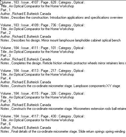

                The was a short(ish) series on building an optical comparator published in ME quite a few years ago – the author(s) were, from m, Canadian. I built a somewhat simplified version of it, but it doesn’t see much use.
                #77081
                Terry Lane
                  @terrylane
                  Got it!
