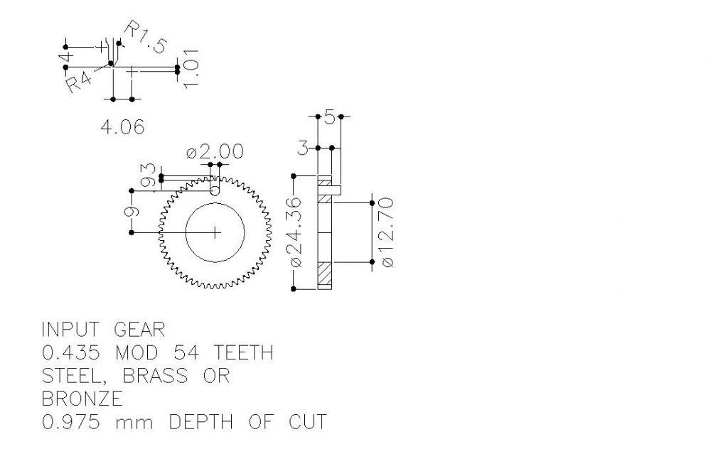

      I’ve just been reading the first part of the article in MEW 279 describing Graham Meek’s tailstock dial for the Myford S7, and noticed some obvious errors and omissions in the details of the gear cutters (figures 4 and 5). In figure 4 the r1.38 dimension for the 48 tooth cutter cannot be correct. In figure 5 the r1.5 dimension for the 54 tooth cutter is also clearly wrong. In all cases no dimension is specified for the cutter widths.
      #38517
      Mike Crossfield
        @mikecrossfield92481
        Drawing errors
        #402508
        Graham Meek
          @grahammeek88282
          To deal with the last point first, the drawing for "Typical cutter Profile" has yet to be published.
          You are right in that the dimensions are wrong.
          In the case of the 48 tooth gear the numbers have had an Eric Morecombe moment. "all the right notes not necessarily in the right order". The same with the numbers, they are all there, but not in the right order. The view of what I sent in is below.
          The 54 tooth gear is however way off, again below is the drawing submitted with the article.
          These radii are the flank radii of the actual tooth profile. The radii will be different if you try and use Ivan Laws tables based on the Browne and Sharp system. Where each cutter profile in the series is made to the smallest number of teeth to be cut by that cutter.
          My cutters are the closest one can get to an Involute form, using a form cutter. Without resorting to a hobbing machine. This gives a much smoother action between the gears.

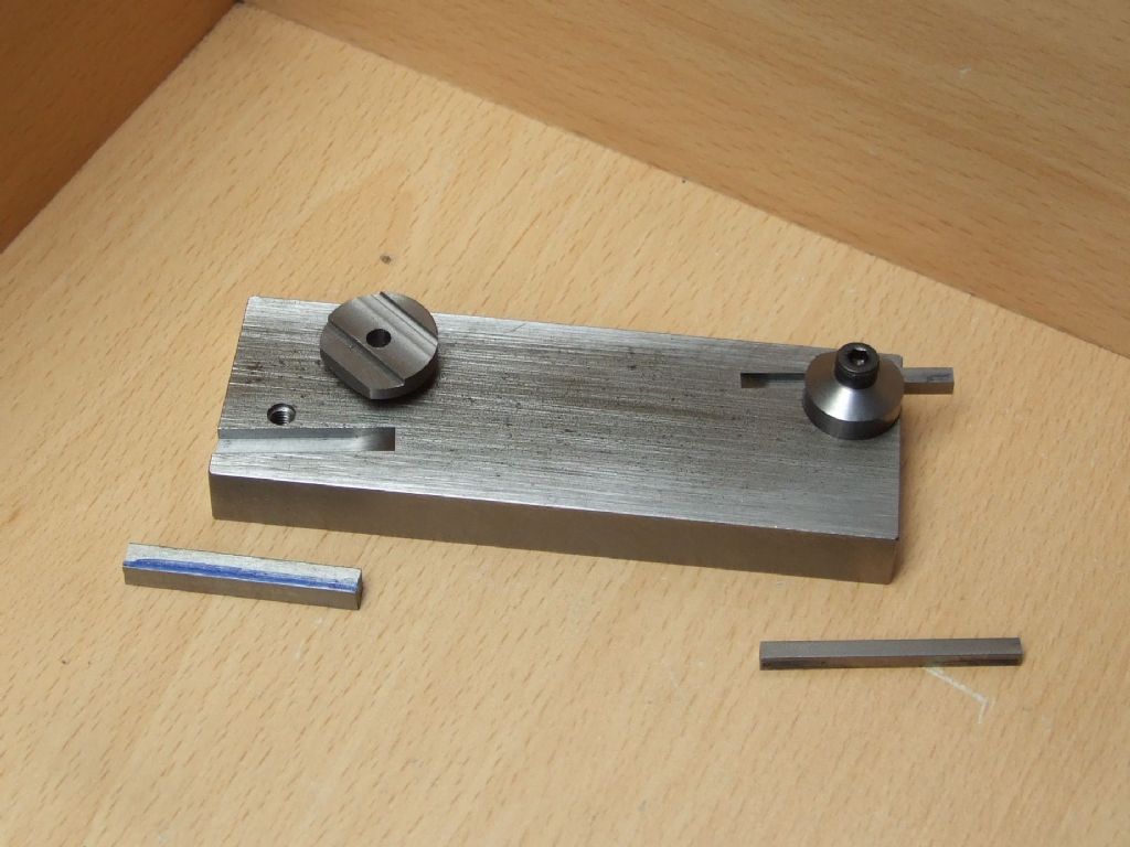

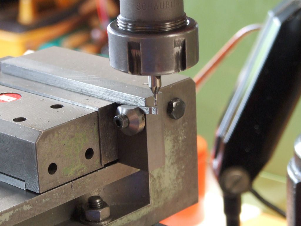

                                                  Graham Meek
                                                    @grahammeek88282

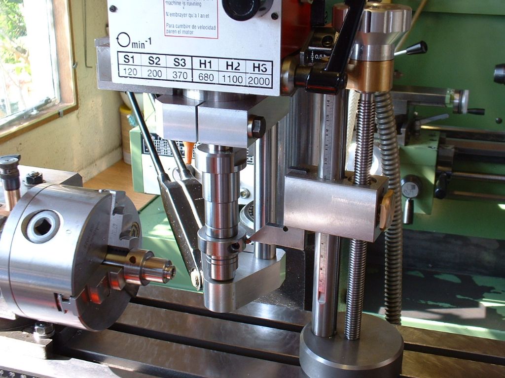

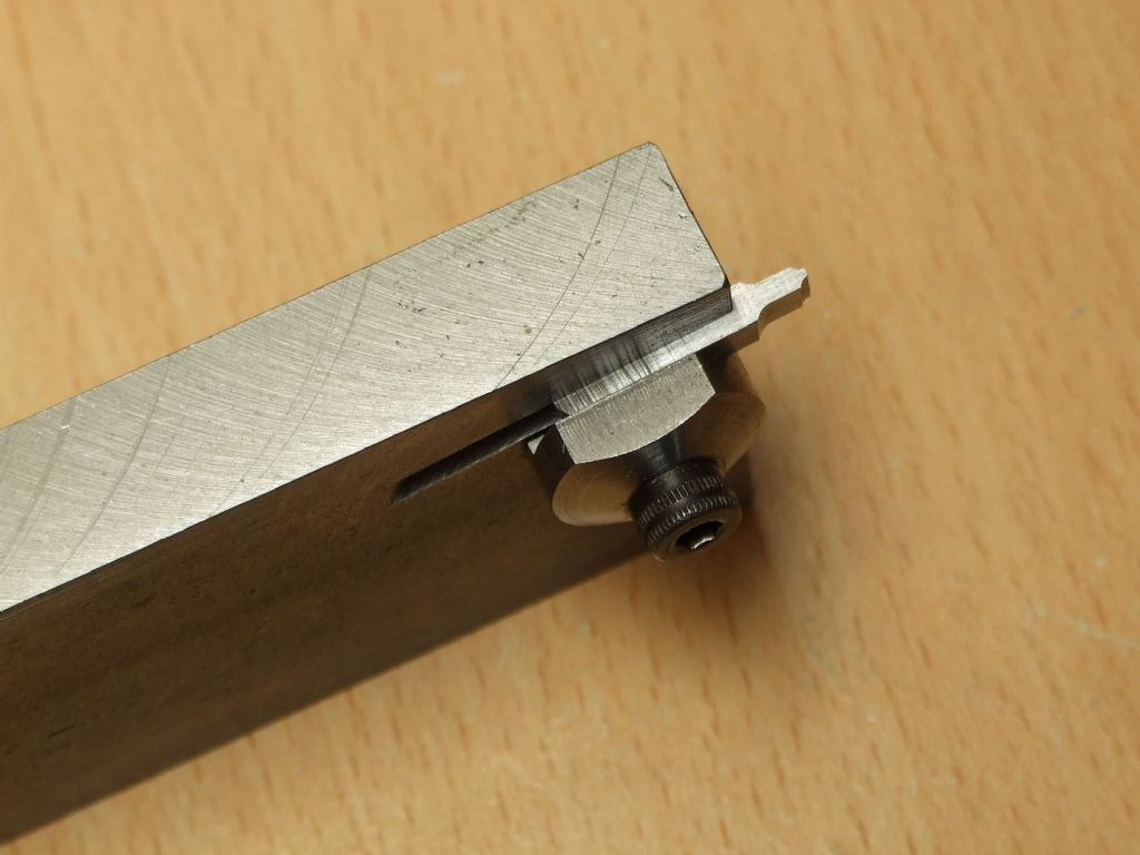

                                                    The jig above is for 1/8" and 3/16" square Silver Steel, (if you can get hold of it), or Gauge Plate, better known as Ground Flat Stock these days.
                                                    The centre line of each blank is 12 mm from the fixed Jaw face of my Machine vice. As I always work with this face set to Zero I know exactly where each cutter is in relation to my index.

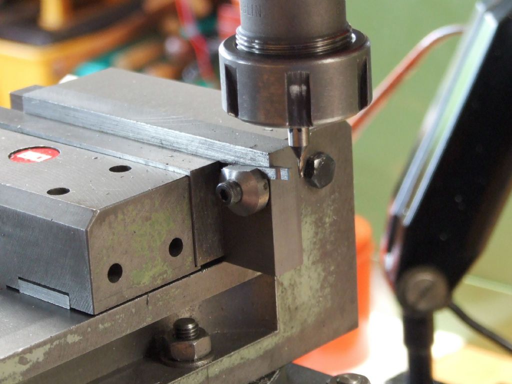

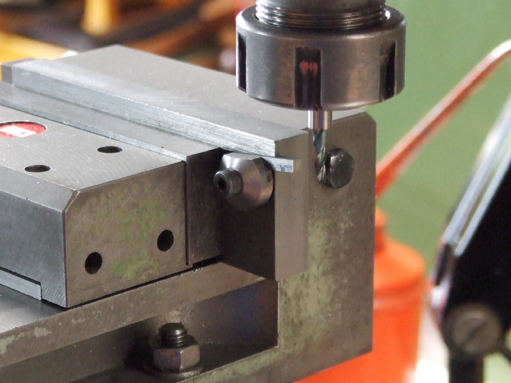

                                                    This is a sequence of photographs showing how I go about making a gear cutter. IN this case this is a special for a Centring Device I made some years ago. I think the Gear was 0.4 MOD. The cutters in the jig are inclined at an angle of 10 degrees to the Horizontal.
                                                    fig 10c taking a light skim across the end face with 0.0625 diameter cutter.jpg
                                                    These last three images show how the gear form is created using in this instance a 1/16" Slot Drill. Most of my cutters are made double ended, that way should I have a calamity I can quickly change the cutter end for end.
                                                    I have a photograph somewhere of how I hold the cutters in the mill.
                                                    Regards
                                                    Gray,

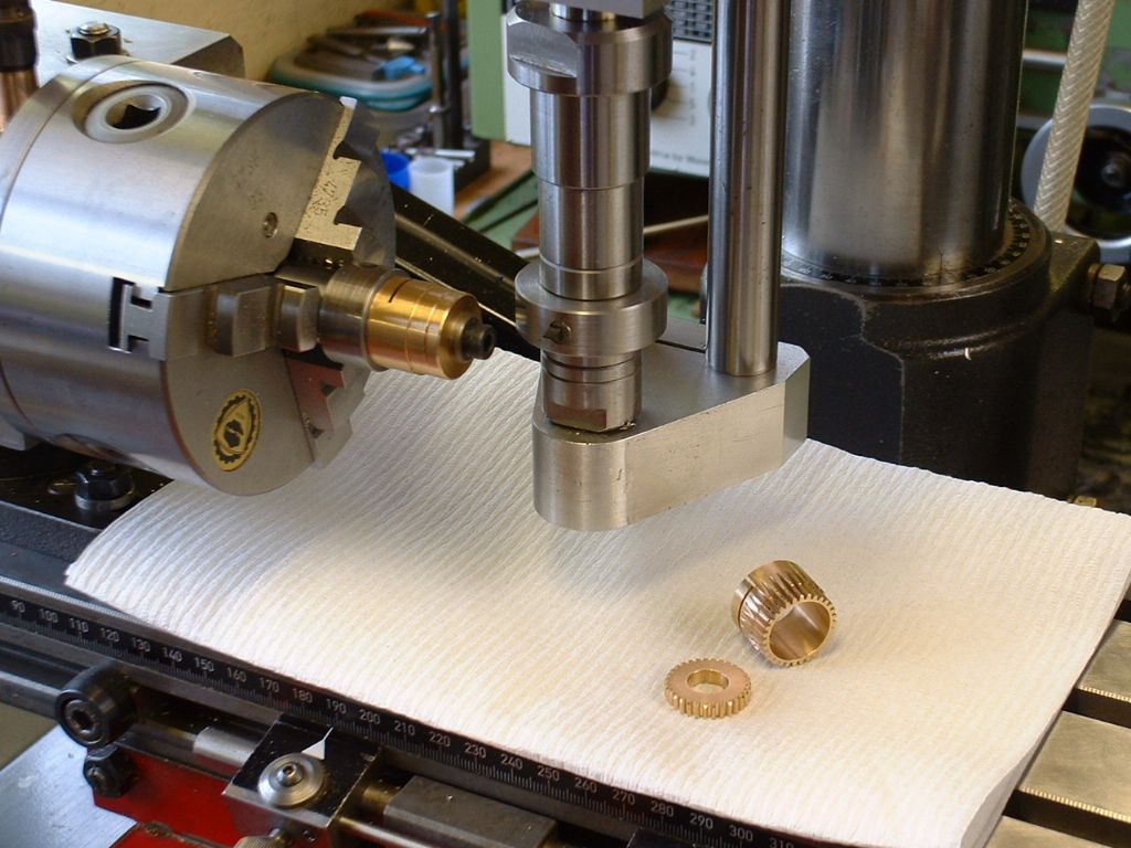

                                                      I have found the photographs quicker than I thought,
                                                      The above was when I made the sample Super 7 Handwheel dials for the original article in EiM. This cutter incidentally had been used to produce approx 500 dials over the course of 30 years. The cutter only requires touching up on the top surface to restore the cutting edge.
                                                      Regards
