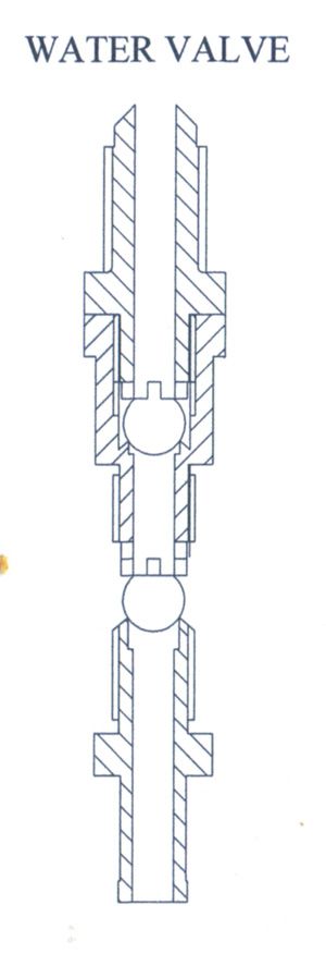

                          You get a lot of good advice on this forum this is how my hydro with very fast pump stroke valves are designed every thing is stainless steel. as you can see the ball seat is not flat.
                          I have very few times when the balls do not seat when it becomes awkward normally a bit of dirt is the problem.

                            Thanks David and Windy. What is a top hat style valve please? Is it the same as a shuttle with O ring. Can you do a drawing please? Windy I don't understand how you make that shape valve seat without it being a separate piece?

                                Posted by John Rutzen on 11/03/2018 07:43:01:
                                Hi John,
                                On my valve seats the bottom feed is no problem but the others I use either a drill or a slot milll of suitable diameter and hand grind to an internal angle.
                                I use a very slow speed to minimize chatter then solder a steel ball of the size am going to use in the valve to a piece of bar and rotate that ball on the seat to burnish the seat.

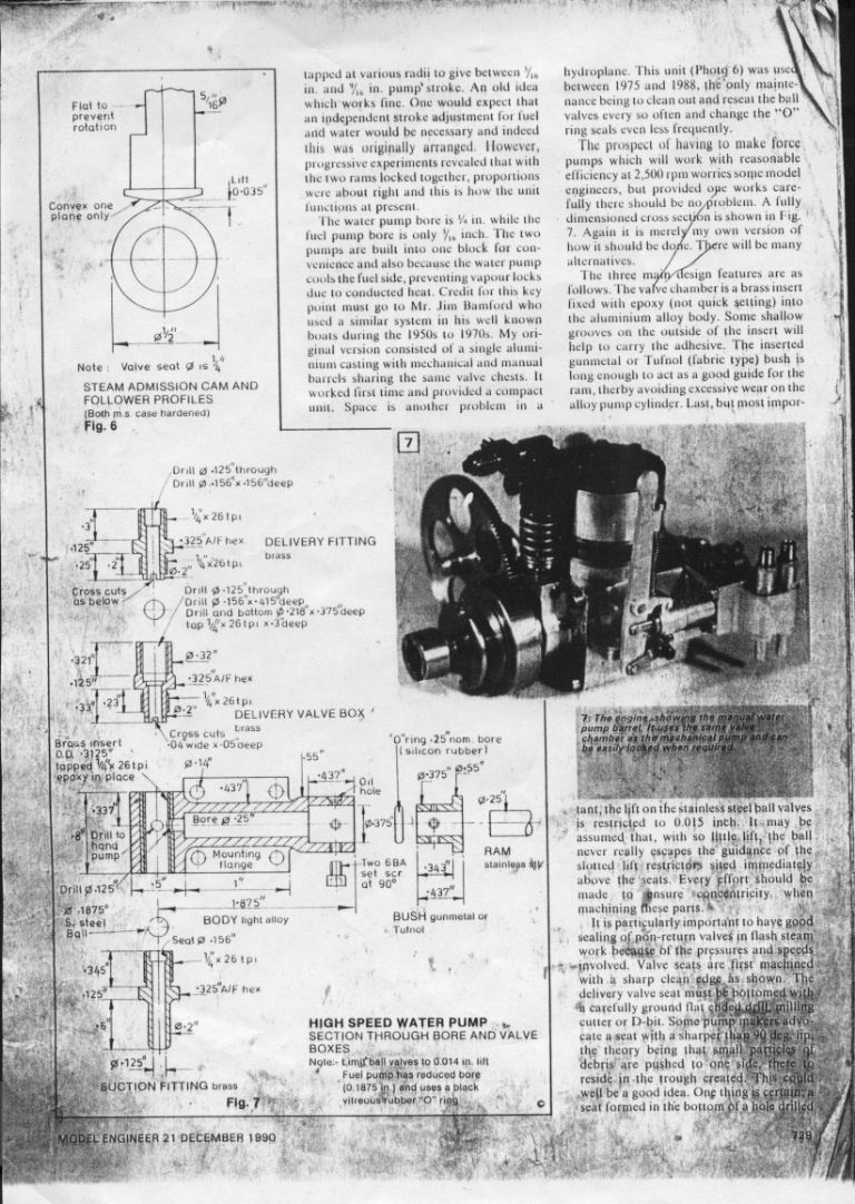

                                Think an article by Bob Kirtley 1990? ME explains how he makes his pump valves not sure if he makes his seats conical.
                                Will have a look and post the article when found.

                                  Here is Bobs article a bit dog eared.

                                    Thanks for posting that. It's difficult to see but the seats look conical – the wrong way!
