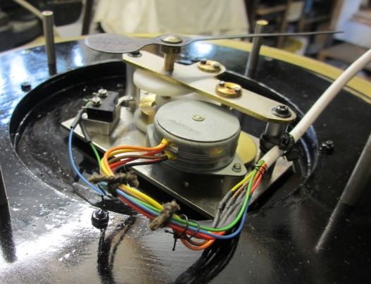

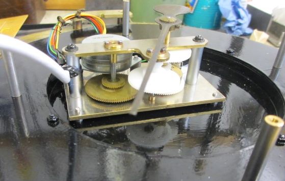

                    John, I've done the dodge of using a quartz clock movement driven from my electronics to get me going on another clock project, but I want to make my own, preferably one that moves every 30 seconds.This is shown in Michael's link, but the Gents moves 1/4 turn every step, and looks subtly different to the Lavet. I've got one of those as well, but I don't want to destroy it by taking it apart to measure everything up. Looks like I'll have to experiment, I was hoping someone would have done the spadework, I know, idle so-and-so. I've also done it the other way round and used the electronics from a quartz clock to give one second pulses to drive a normal Synchronome slave, again via some electronics
                    here's a couple of pictures of one of my stepper driven slaves, the brass gear is just an idler which connects the stepper to the extra gear on the minute shaft 1/48 of a rev of the stepper (little steppers are typically 48 steps per rev) moves the minute shaft 1/240 revs, ie quarter of a minute. The electronics then advances 4 steps per minute. All done with stock gears, I'm not brave enough to make my own yet, but it's on the list. On my rescued Blick, I geared it 1/48 to 1/120 and advanced every half minute. I'm planning to take the Blick apart again soon to fit microswitches to the one rev per day wheel, I'll take some pictures then
