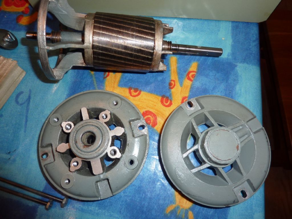

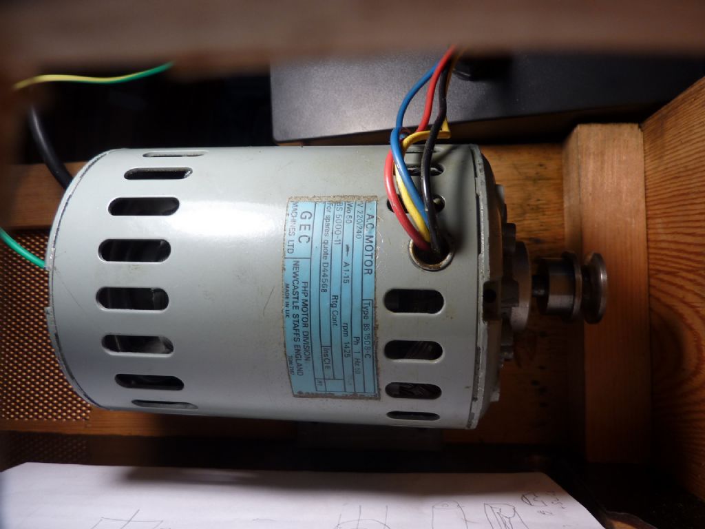

      This single phase AC motor (see photos) was supplied with Cowells lathes in the late 1970s (and perhaps later).
      The motor is GEC 'type BS 1508-C, 1425 rpm, for spares quote D44568' if anyone wants the blurb from the sticker.
      The bearings appear to be worn sufficiently for the rotor to rub on the stator when the drive belt to the lathe is not tight.
      I'd like to replace them but how to get them out is not clear to me. I'm hoping that someone here has successfully done something similar.
      The motor seems to be a pretty simple affair with no slip rings or commutator involved. The alloy ends house the bearings and are secured by two (2BA?) threaded rods that go right through the casing. With the nuts undone it is easy to take off the ends and pull out the rotor.

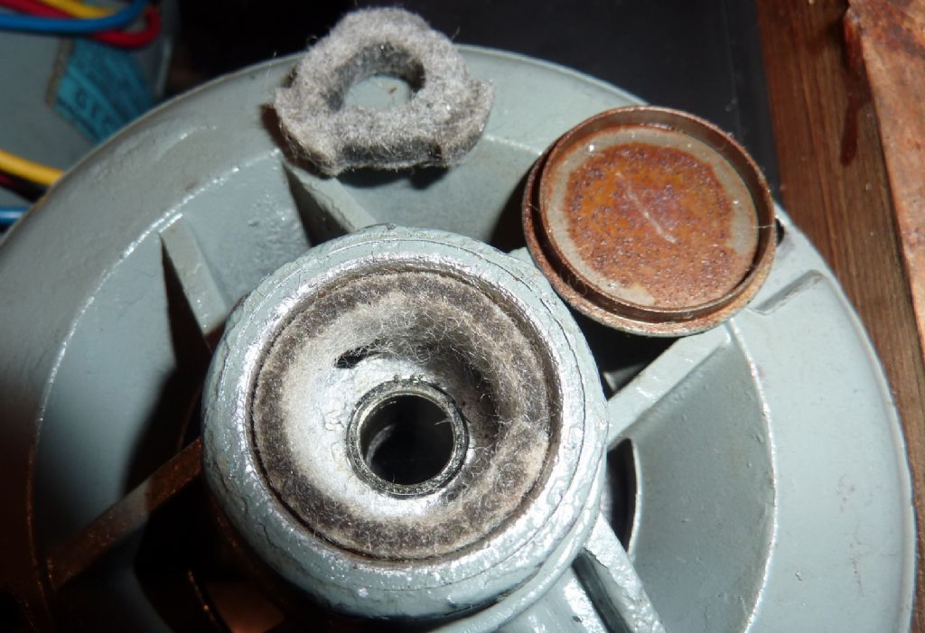

      The bearings seem to be plain (bronze I guess) but they are enclosed by what look like pressed steel caps both on the outside and inside ends. There seems to be some wicking material surrounding them and a wick in contact with the motor shaft. The shaft has a spiral groove presumably to persuade the oil into the bearings. A (tufnol?) part surrounds the shaft inside the end caps on the 'indoors' end.
      Can anyone advise on how to get the bearing housings apart without causing damage please?
      I suspect that a previous owner has turned one of the ends through 180 degrees such that the unworn side of the bearing takes the load of the drive belt. This does stop the rotor from rubbing on the stator as long as the belt is tight but it can still make grating noises when starting and I'm not happy with it as a long term answer.

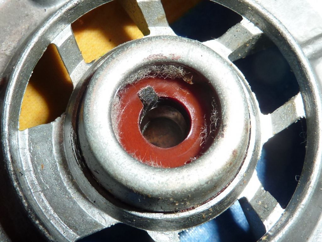

          Wow, Andy !!
          I've never seen motor bearings that worn. … Surely the belt must have been much too tight.
          I don't know how closely the pictures here resemble your bearings, but they look similar enough to give you some clues: **LINK**

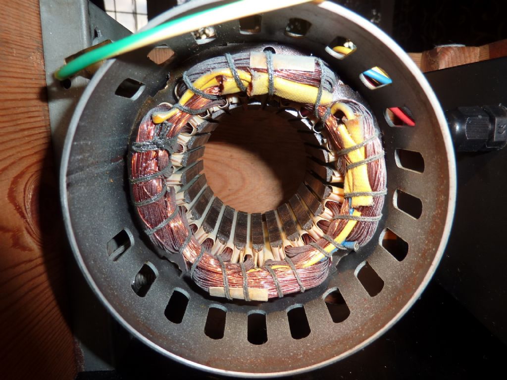

              Looks to me that the outside windings have fried a bit, worthwhile checking their resistance/ possible leak to earth.

                    I didn't notice any sign of thermal damage to the windings when poking around with a lamp in there. The photo was done with flash which can make things loook a bit odd. Certainly the motor does not upset the RCD on our ring main… which plenty of other domestic appliances (mostly steam irons) have managed to do.

                      A few more posts while I was writing mine. Thanks again. I will give the 'expanding puller' thing some thought and will have a rummage through some more civil engineering type bolts to see if anything can be pressed into service. This seems like the type of approach where I could bug out and just tap the cover back on if I wasn't happy with the way things were going.
                      The photo below is a bit more of a close up of the 'indoor' end but the flash still tends to flatten everything so it's not as good as actually looking at the real thing. The brown thing is the bit that I think is Tufnol. The bearing itself is behind this.
                      So it sounds like trying to take the 'indoor' caps off may be the way to go… although the taper on the cap and the similar taper on the alloy casting did make me wonder if the whole assembly had been inserted from the 'outdoor' end… but then looking at that end it seemed unlikely.

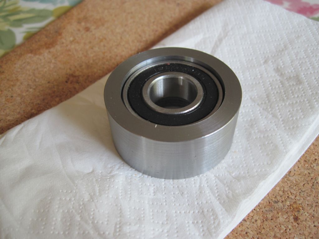

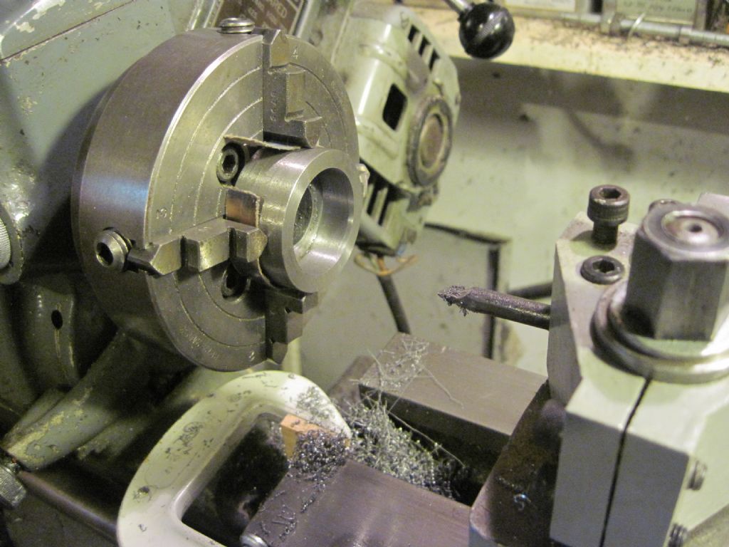

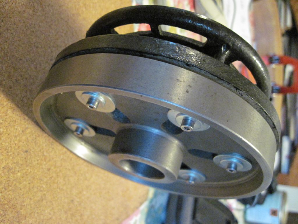

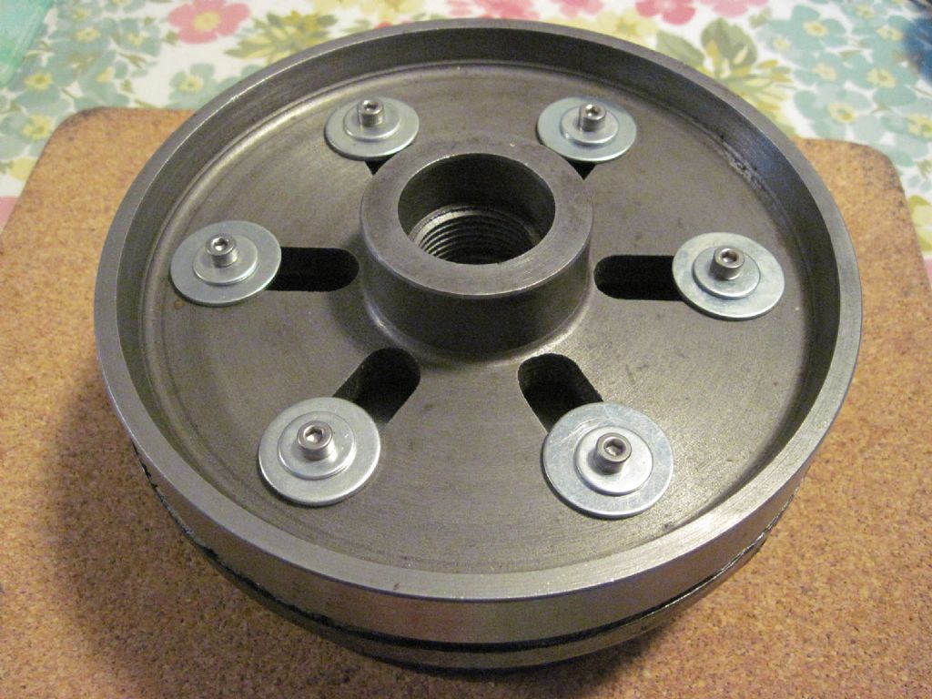

                        No – I don't think a Unimat will do it either Andy!
                        I had to mount the end-bell on my Myford faceplate, as none of my chucks would take it. It involved a bit of preparatory drilling and tapping work to match the two together – but it was the only way I could think to do it..
                        So if you have a mate with a bigger lathe – here are some photos of my face-plate set-up.
                        Regards,
                        IanT
                        PS Very useful (and under-rated) things face plates!

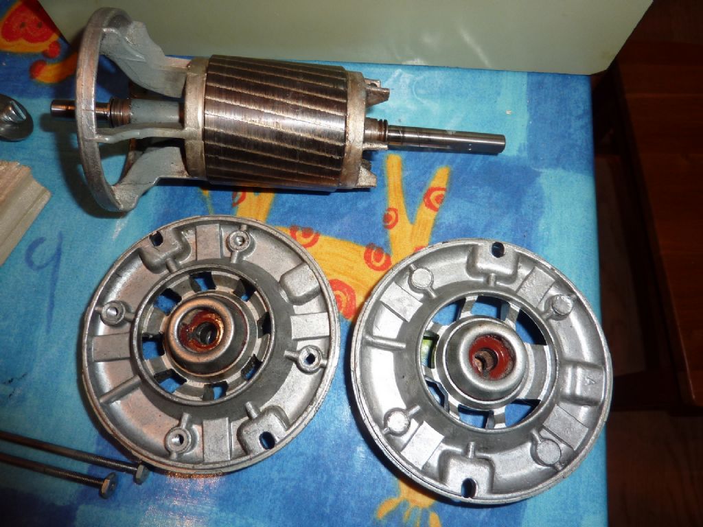

                          I've just been having another look at the motor following tonight's discussion.
                          I put it back together to take another look at the bearing wear. Having done this I found that I could not get the rotor to touch the stator in any position so things are probably not quite as bad as I had initially thought.
                          As originally noted, there *IS* bearing wear. There is play in the shaft in the direction of the belt load but not in the direction perpendiclar to this. The motor definitely does make some nasty noises. I now suspect that the noise is caused by vibration of the shaft in the sloppy bearing rather than by the rotor contacting the stator. This noise would, of course, stop when there is enough tension in the belt.

                                    Hard to tell Andy but I don't think you have an Oilite bearing in there. it looks like a felt oil reservoir very similar to the one on mine. If you can remove the tufnol cover – you may find an inner die-cast ring that holds a thin bearing (I called mine a 'shell' bearing – but it was very similar to a Glacier). Whereas I've pulled Oilite bearings out quite easily in other situations – I couldn't shift this one (although I didn't try heating it). So I just cut-out the whole thing.
                                    However, even if I could have changed just the bearing itself – the shaft was badly scored – so a new bearing would not have lasted too long. My spindle had a stepped shaft – so I was able to turn the damaged part away – but your shaft seems to be a single diameter, which means you would have to reduce the whole length – possibly weakening it (and then your pulley wouldn't fit either).
                                    However, if your shaft doesn't seem badly worn or damaged – then maybe the bearing isn't too bad either. If you think the bell ends may have been swopped in the past – then the rear cover should come off fairly easily (wooden dowel tapped from the inside). Then you could try both bell ends on the pulley side of the shaft and see how well they fit – can you 'rock' them slightly? If you 'mic' along the shaft is there discernible wear on it – checking along the length from the pulley end?
                                    Your original concern was that the rotor was hitting the coils but if this is not the case – then it might be best to leave well alone or decide to bite the bullet and find a new small fractional motor. I don't know how the Cowells motor is mounted – but a new mounting for a replacement motor might be an easier task for you – and these small (cap start?) motors are not too expensive if you can mount them. In my case I needed an Imperial B56 flange type mounting and whilst replacement B56 motors are still available – they are about twice the price of the same sized metric one (which wouldn't fit the machine easily). So I decided a repair was required – but in your case there might be other easier/affordable options…

                                            Some progress to report… I found that the outer end cap on the non-pulley end came off with some very light taps with an 8mm rod through the bearing. Taking out a wick 'washer' revealed the view in the photo below.
                                            So this does seem to be a thin walled bush. As far as I could measure by poking around with the calipers it seems to be roughly 10.8mm OD (and an 8mm shaft). The bush is inside a bore in the main casting but this part of the casting is surrounded by several slots for more wick material.
                                            I've also had an unsuccessful attempt to get the inner cap off using a few quick and dirty options. My anchor bolt does not expand enough to grip the cap so I'm planning to make something with a step to engage positively inside the rim. Not sure if that will happen today because I have some errands to run.

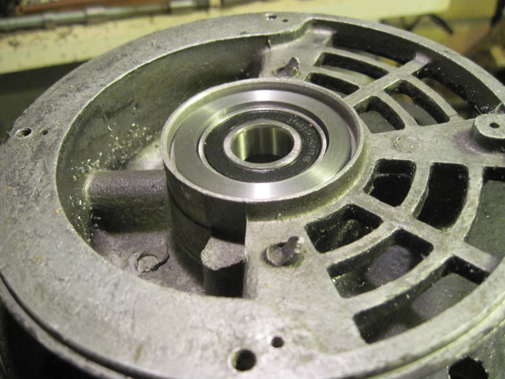

                                                Hi Andy
                                                By the looks of the recent picture there is room for a ballbearing adaption as IanT, probably more work and perhaps beyond the size you can turn but a worthwhile repair.
                                                IMO ZZ seals are better than the rubber seals as they tend to create heat by continuous contact on the bearing inner and outer parts.
                                                Emgee

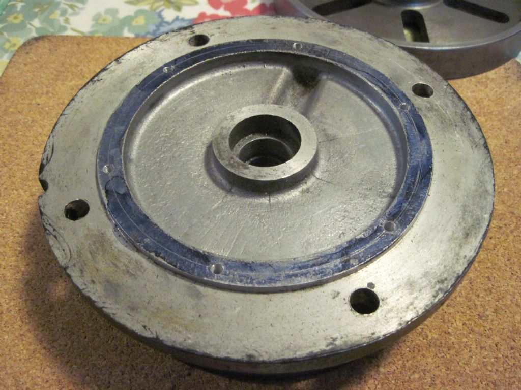

                                                  I still dont want to do that but you did get me thinking,,, that the recess in the photo is kinda ball race shape and sized.
                                                  The diameter of the recess varies between 22 and 21.4mm and it is about 10.5mm deep. A quick search for a sample 8mm ball race seems to be 22mm OD and 7mm wide so it would go in there with a minimal amount of machining.
                                                  I think it might just about swing in the gap of the Cowells bed if mounted on the face plate… but only if I can get the inner cap off because that stands maybe 5 or 6mm proud of the casting.
                                                  I also reckon I could temporarily drive the Cowells by holding its motor pulley in the chuck of the Unimat. Never tried it but I think it would have enough grunt for a small amount of alloy machining at 22mm diameter..
                                                  How concentric the existing recess is and how I would find a reference for clocking the motor end when mounted on the faceplate remain unresolved. Clocking inside an unevenly worn bearing doesn't seem like the right answer. Maybe inside the step where it mounts to the main motor 'tube' is the least bad option.
                                                  But whatever happens… getting the inner end caps off needs to be the next step.

                                                    Clocking the locating diameter of the end bell that engages the motor housing tube would probably give a good result. Unless your motor was manufactured different to the majority of all small motors made. Generally the end bells are machined for bearing bore and locating diameter to housing in the same setup. (or were several places I worked, who made motors)
